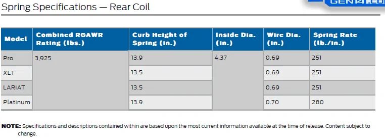

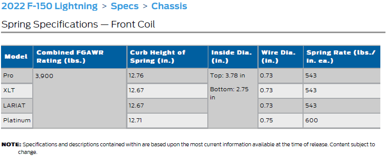

In regards to the spring rates, I brought this up initially along time ago and I always wondered the same. I am posting it here again (cause I always seem to have a hard time finding it). Besides it being thicker, it has a higher rate which means a stiffer ride. I find it hard to believe that the Platinum has that much more stuff in it than a fully loaded Lariat.
