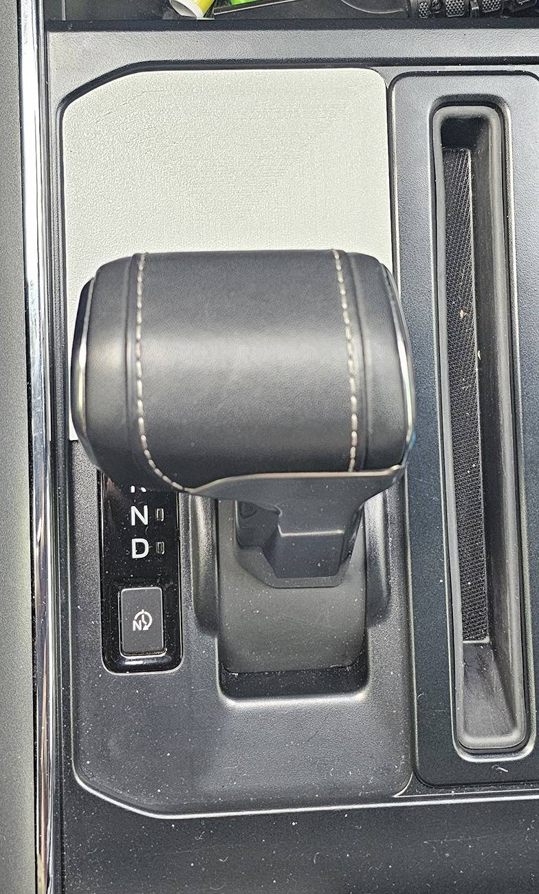

Would love to have an insert for where the shifter stows (I never stow it) to improve it for use as a third cup holder.
I have tried working on an insert to turn it into a phone holder with charging cord feed through, but I can't get the compound angles and curves right. I really need a 3D scan of the cavity to do it right.
Yes. I’ve been wanting a 3D scanner for stuff like this, and Facebook keeps advertising them to me (have no idea if they are any good or worth 1K). What I usually do is try to take images square to any angles I can, and then use it as a canvas in Fusion 360. Then just spline tool it. You could at least get the perimeter correct. Some of the angles down the “hole” may be tougher, but for a phone stand, I’d just get the perimeter as good as I could, then just add some draft to make it a compression fit. Just an idea.

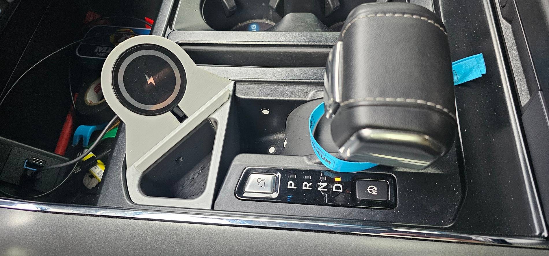

Noticed one of my dimensions had a broken reference.. the charging pad was off center as a result That will drive my OCD crazy.. So I updated my settings and I'm printing a new one now. the prototype in the pictures above is up for grabs if anyone wants it! Free for first taker, charging pad not included.

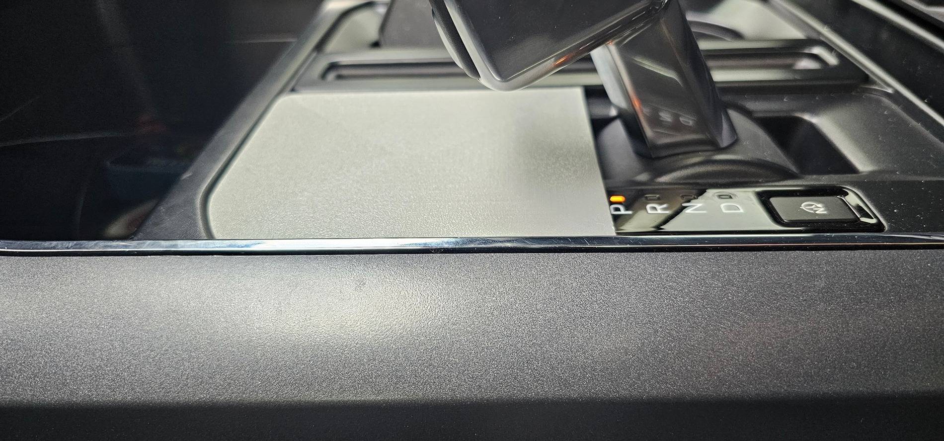

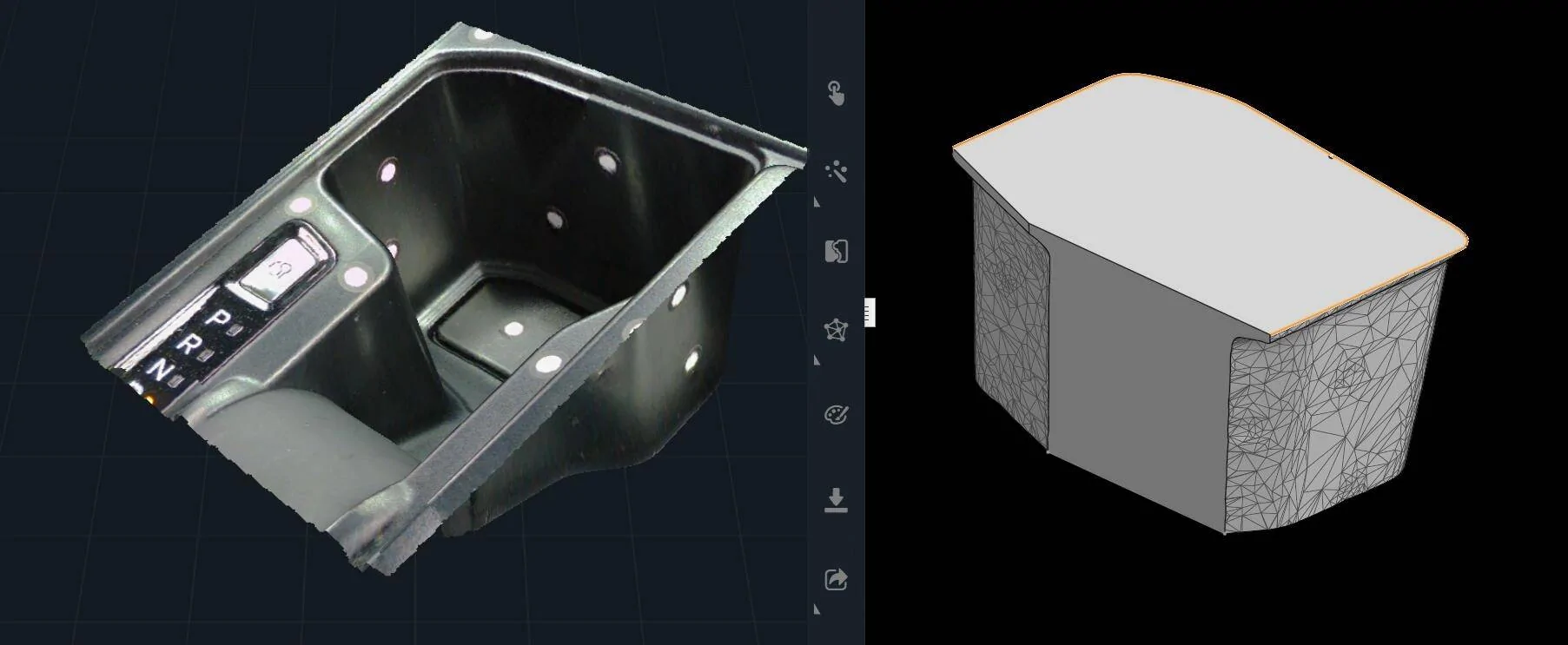

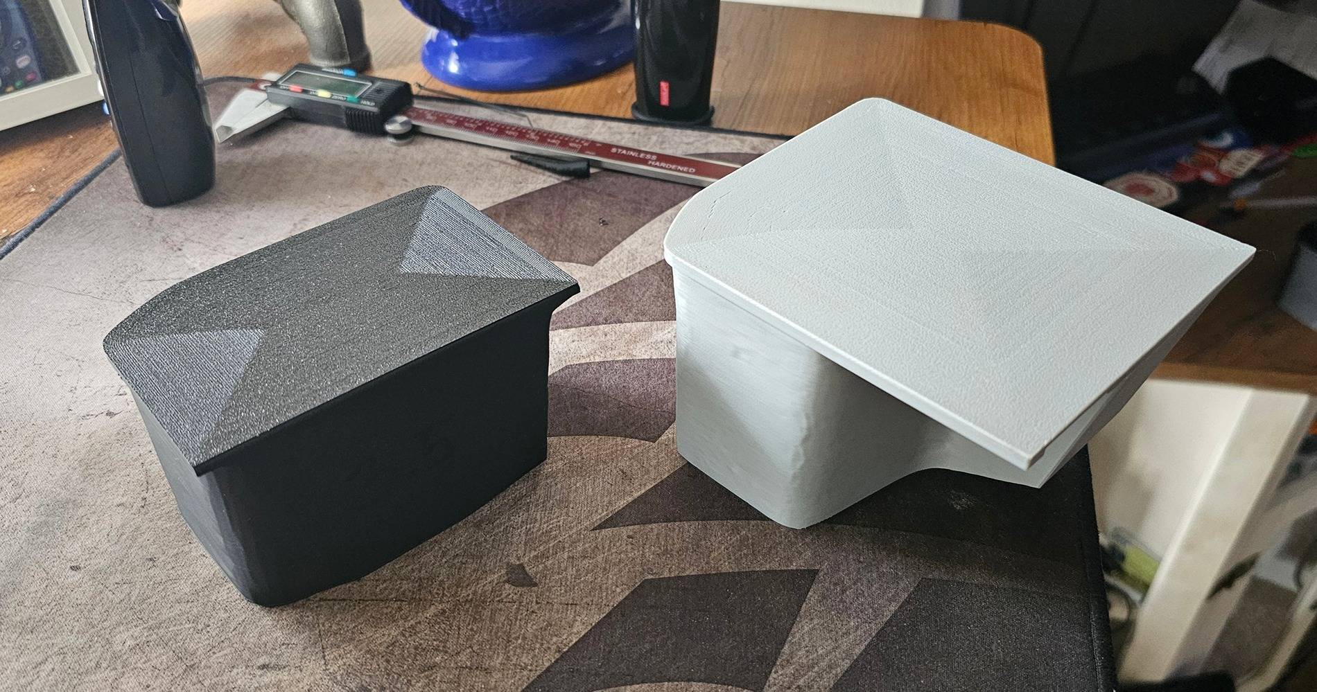

Alright, so my scanner came in and I've had a go at scanning the shifter hole and creating a flat platform for building off of. Ive created a smaller and larger version and messed around with adding phone mounts and storage to the smaller one.
https://www.thingiverse.com/thing:6876636
Here is a picture of the scan and 2 inserts I've made.
Ford F-150 Lightning 3D Printing Fun image-3
Ford F-150 Lightning 3D Printing Fun 20241217_133155
they fit very accurately and snug. Ive been very happy with the quality of the scan and fitment of parts made from it so far.

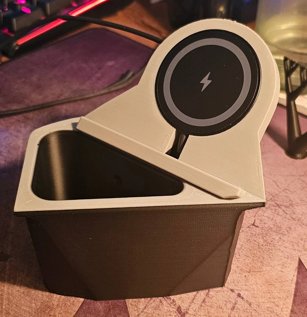

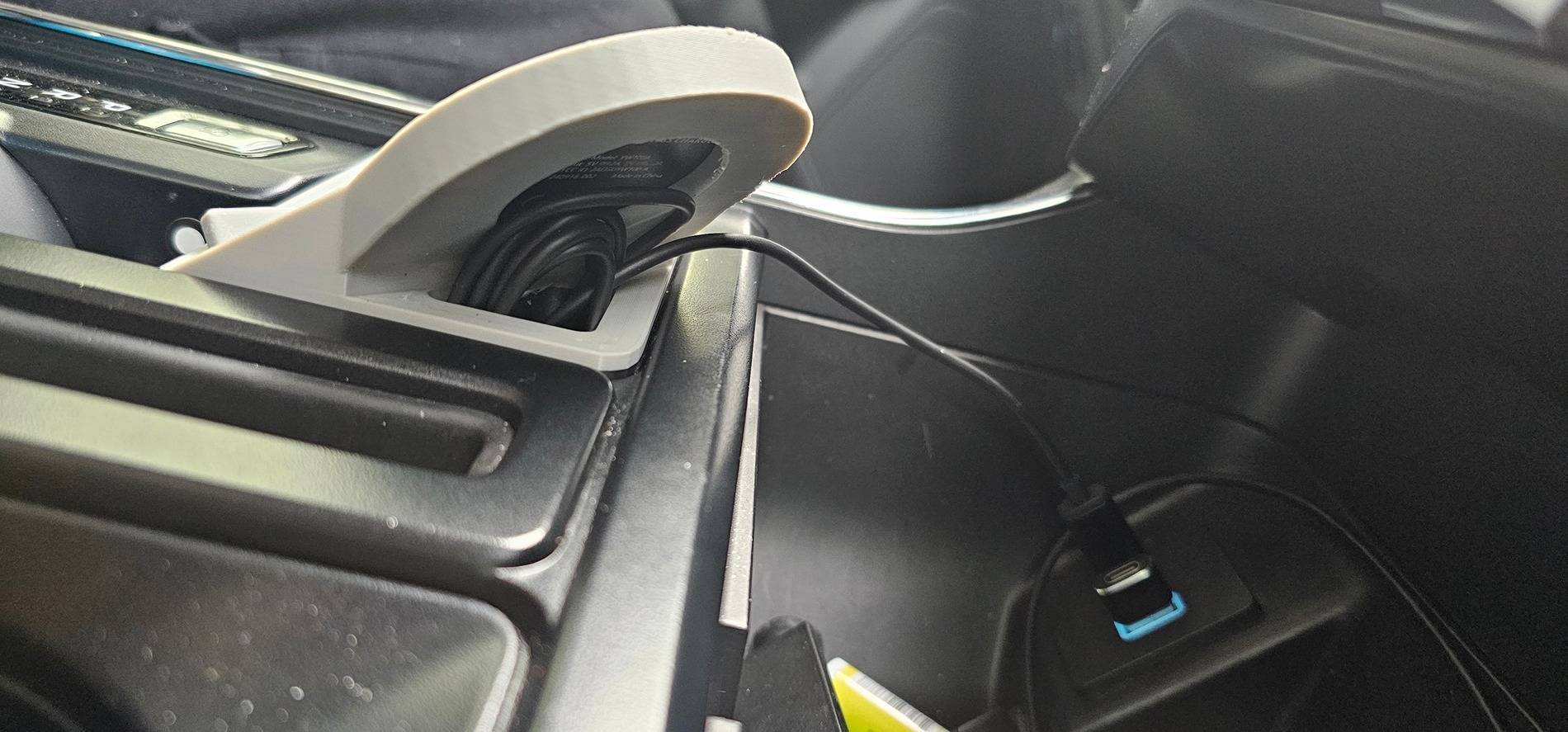

Ive messed around with making a landscape phone holder/charger for the smaller insert, but these should serve as great platforms for building or attaching custom mounts or whatever you want to the shifter hole.
Ford F-150 Lightning 3D Printing Fun 20241216_182955
Ford F-150 Lightning 3D Printing Fun 20241217_091616
Ford F-150 Lightning 3D Printing Fun 20241217_091625

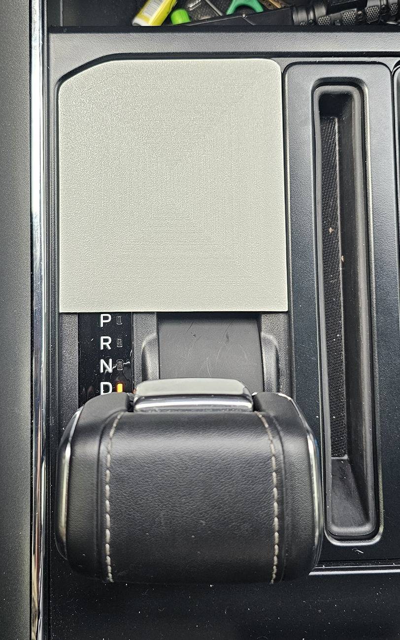

and here is the larger platform in the hole. The larger version has a cover for the button that folds down the shifter, so you can't accidentally push it while it is installed.
