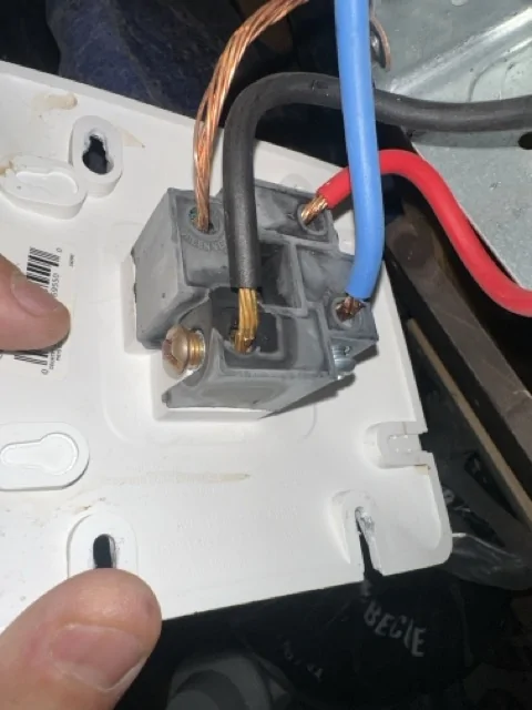

This is the image of the plug I took off that was getting hot. Plug didn’t melt but was getting very hot. Just at the plug. The wire showed no sign of heat on the insulation and this was after 3 years running at 40 amps. There was some damage to the conductor where the original electrician nicked the conductor when he stripped it. I cut off the ends, re stripped it, and fully torqued the lugs on heavy duty plug to 75 inch pounds. Tugged the wires around then re tourqued. No heat whatsoever at 40 amps after several hrs. Of 40 amp draw. No heat on the plug or the conductors.
