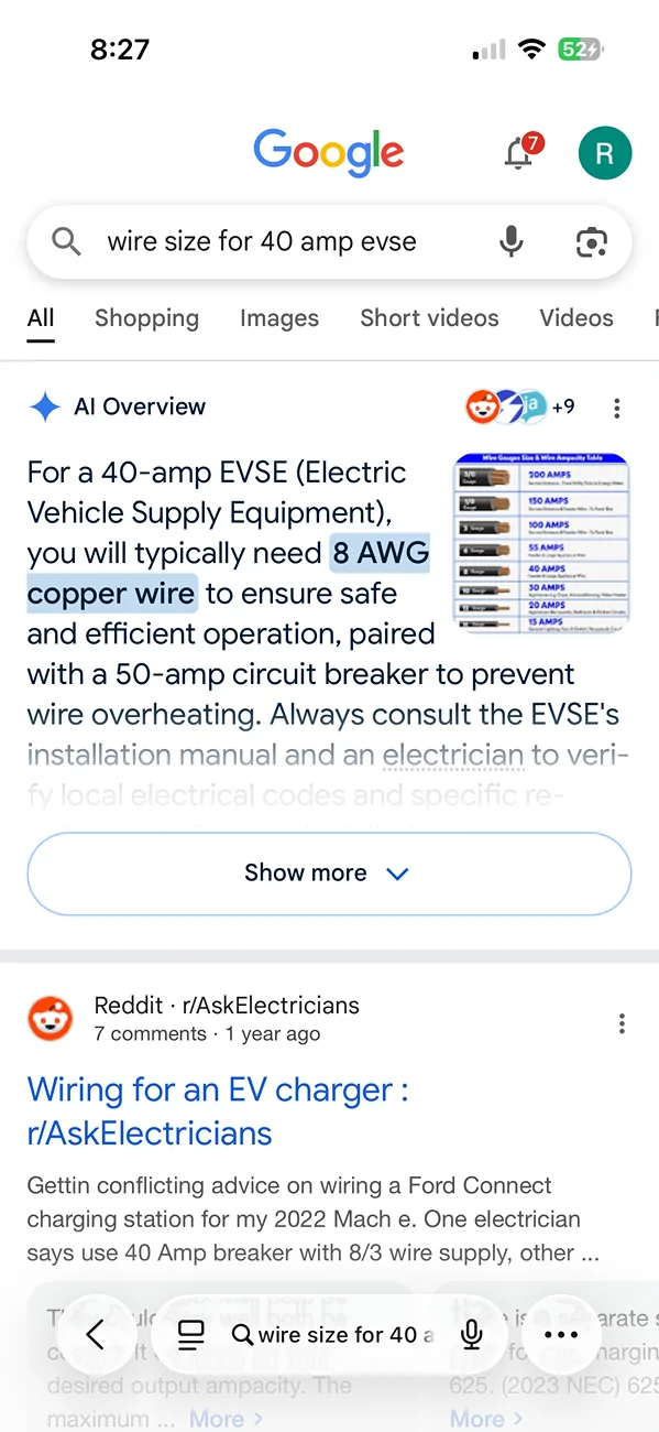

I just googled wire gauge for 40 amps continuous evse and it is saying 8awg wire on a 50 amp breaker but when I google if you can run 8awg wire on a 50 amp breaker it says no. This is the confusion I’m having.
Heliian
Mar 9, 2023
1,773
2,014
No confusion, the cec differs from the nec. Most people don't know the actual current codes either. Your electrician should, talk to them.

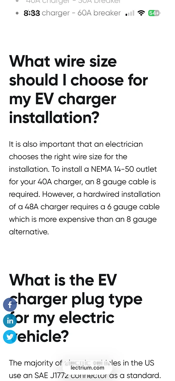

Ford F-150 Lightning 40 amp charging on 8 awg copper. IMG_2673
Link here

AI is never wrong...
The link above is for a website lectrium that advises on evse installation. That is just the screenshot of the section that says 8awg is safe for 40 amps continuous charging but not 48 amp.

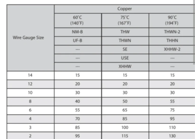

Alright...first I am not an electrician so I am not 100% up on NEC and it seems like OP is in Canada so code things can be different. I am an electrical engineer and do size wires.
8 awg is fine for a 50 amp circuit. The issue is what type of wire insulation.
NM-B. AKA Romex. Because the sheath keeps everything together and what the sheath is made of the code makers only want to allow the conductor temperature to reach 60 C under full load(40 amps per the table). Conductor temperature meaning the temperature of the copper, not the insulation, the insulation will feel fine.
THWN or any type of insulation from the 2nd column the code makers decided it can get to 75 C without degrading the insulation or allowing too much heat to enter the surrounding area and therefore carry 50 amps.
THHN or anything in the 3rd column. 8AWG is good to 55 amps because the insulation can handle higher temperature. While one might think they can put a 60 amp breaker on 8 AWG (using the next size up standard breaker size from the wire ampacity), in general practice you cannot because the breaker and probably the outlet are only rated for the lugs to reach 75 C. Thus since you have to size to the lowest temperature of the items in the circuit you end up at 50 amps.
So if I were installing a 40 amp EVSE I would use 8 AWG THHN in ENT on a 50 amp breaker assuming the run was short enough that the voltage drop is not a concern and that it is not in an environment that is really hot(such as a steel plant that has a high ambient temperature).
It could be that a breaker and outlet combo exists such that they are rated to 90 C and then you could use a 60 amp breaker. Generally in the US the 90 C column is used for a starting point when derating for conduit fill.
There are a whole lot of details that go into getting this stuff right so you don't have problems (fire, excess voltage drop, internet forum crucifixion...)
I don't know the rules in Canada. It could be that they feel a 60 amp breaker is fine as the wire can handle it if you let the copper get to 90 C.
I'm also sure I missed a detail or an exception that would allow higher amps.
I am sure a 40 amp EVSE on a 50 amp breaker with 8 AWG column 2 or 3 insulation type, correctly installed and protected is allowed by NEC and is a fine way to install an EVSE.
I am equally sure some inspectors would not allow it.
