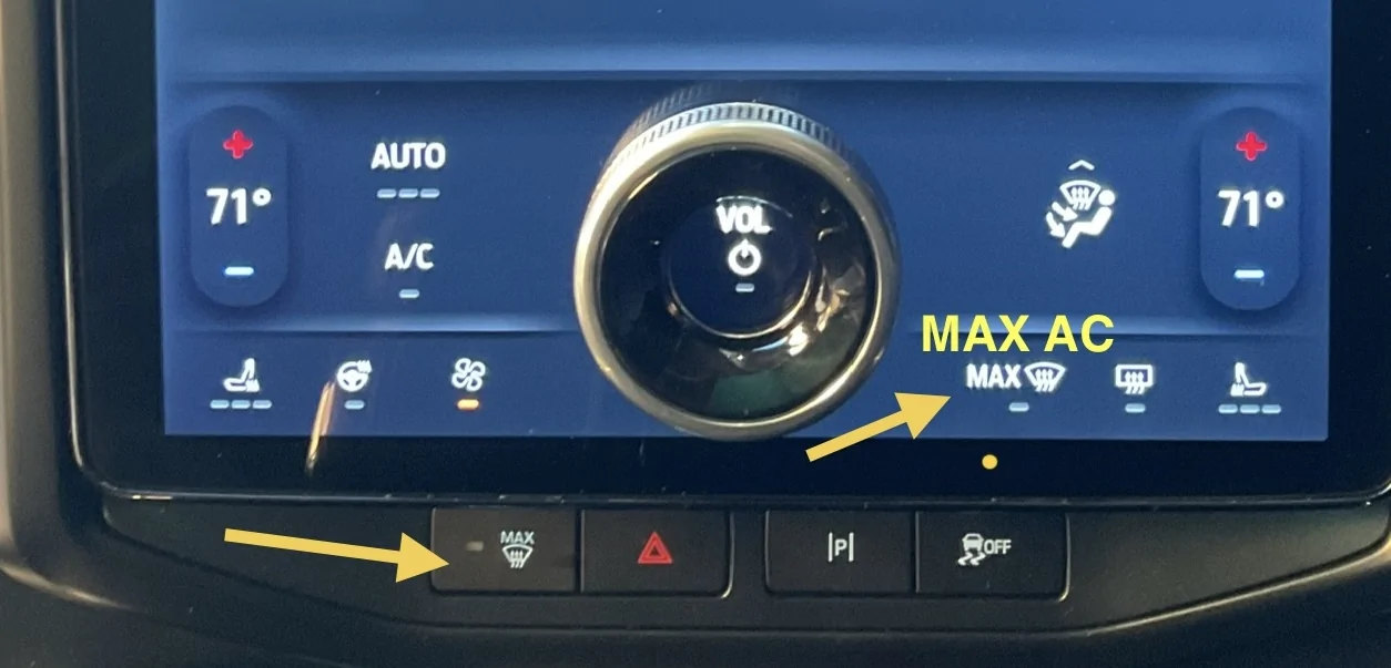

This has never made any sense to me. There is no reason for 2 Max defroster buttons on the console. One physical on the lower left, and one on the lower right of the screen. Just make the screen a Max AC. Easy fix that would make a lot of people happy.
I think it's a federal requirement to have a physical defrost button for safety purposes, but I'm not 100% sure. My guess is that they put it on the screen because people may be hunting for it not realizing off hand that it isn't on the screen.
My only wish is that they would separate the seat cooling and heating into separate buttons. There's plenty of room to move controls around. It's also odd that when you push the seat button heat always turns on, they should at least make it so that the seat button doesn't turn anything on and just pops up the menu.

Can the on-screen MAX defrost button be replaced by an air recirc button, since there already is an physical MAX defrost button under the screen? It's quite cumbersome to go thru the climate menu to find the recirc. Future software update parhaps?
