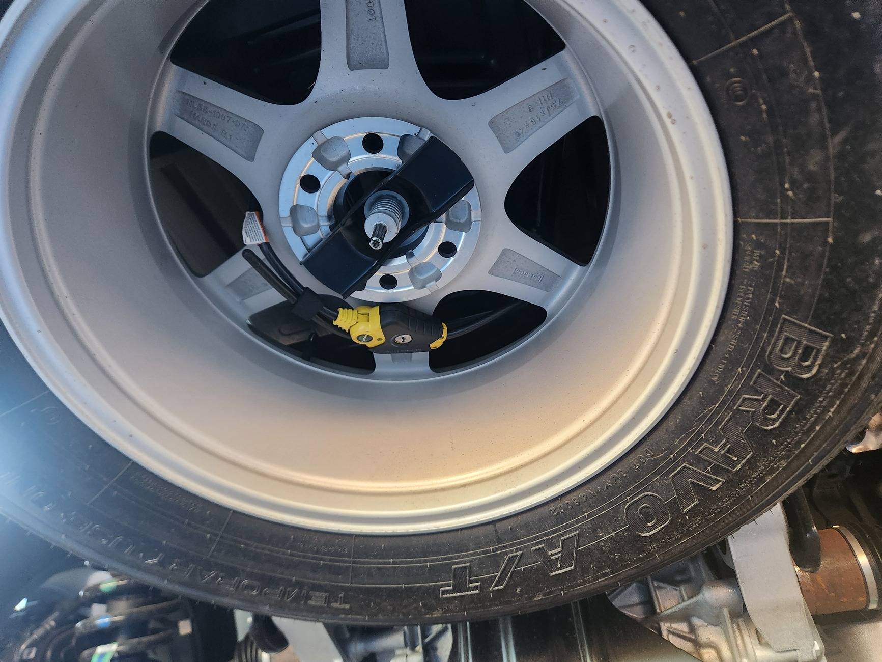

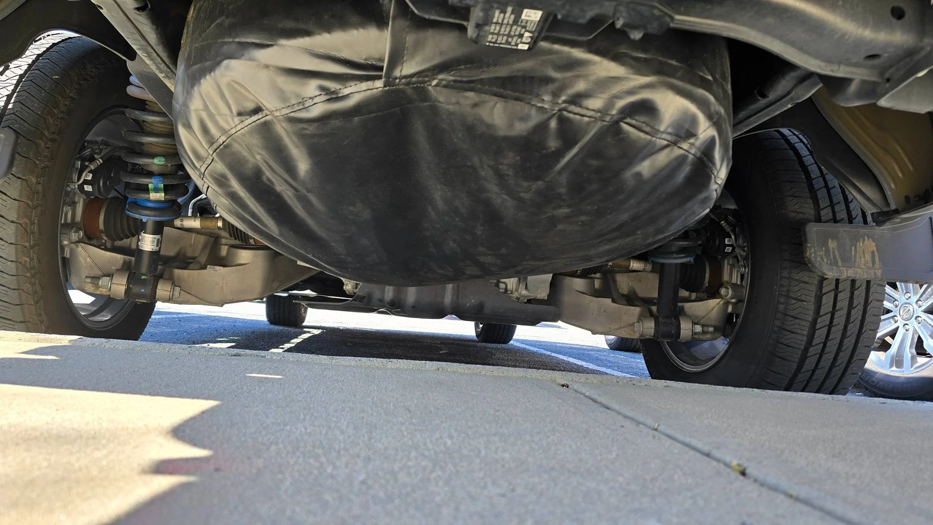

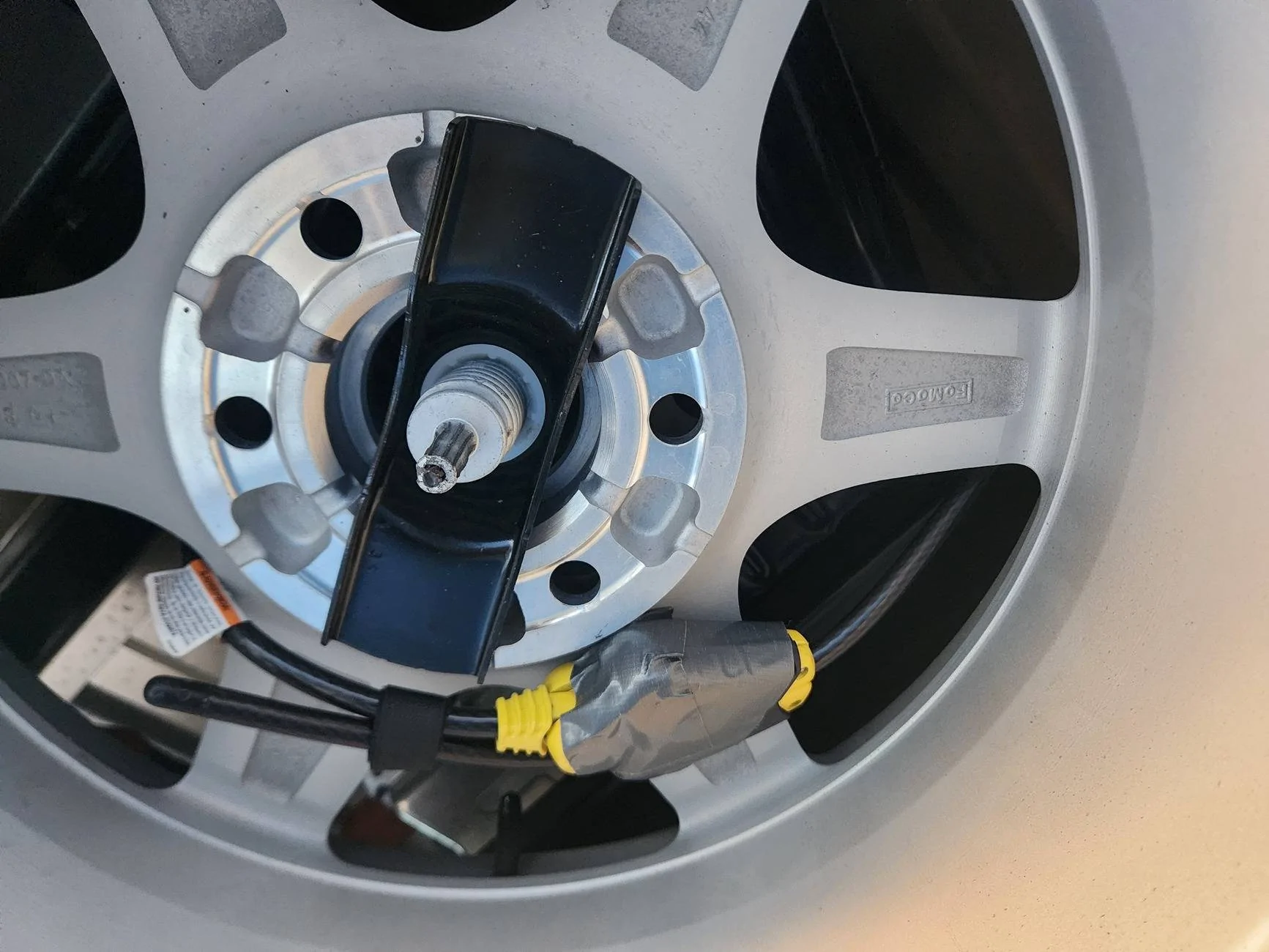

As with many owners here reported, the newer Lightnings don't come with the spare tire lock on the rear bumper. Thought about buying the OEM lock for $65, but seeing how easy it is to undo the lock from Youtube (held only by a clip), I don't feel like it's worth it. I ended up buying an outdoor Master wrap-around cable lock for $30 that ties the spare to the frame. It has a thicker cable diameter than others that I've seen. Search for "Master 8413DPF" if you are interested (I am not affiliated with Master).
Photos are attached in case anyone is thinking about doing something similar. I added duct tape at the end just to prevent dirt from going into the key hole.
