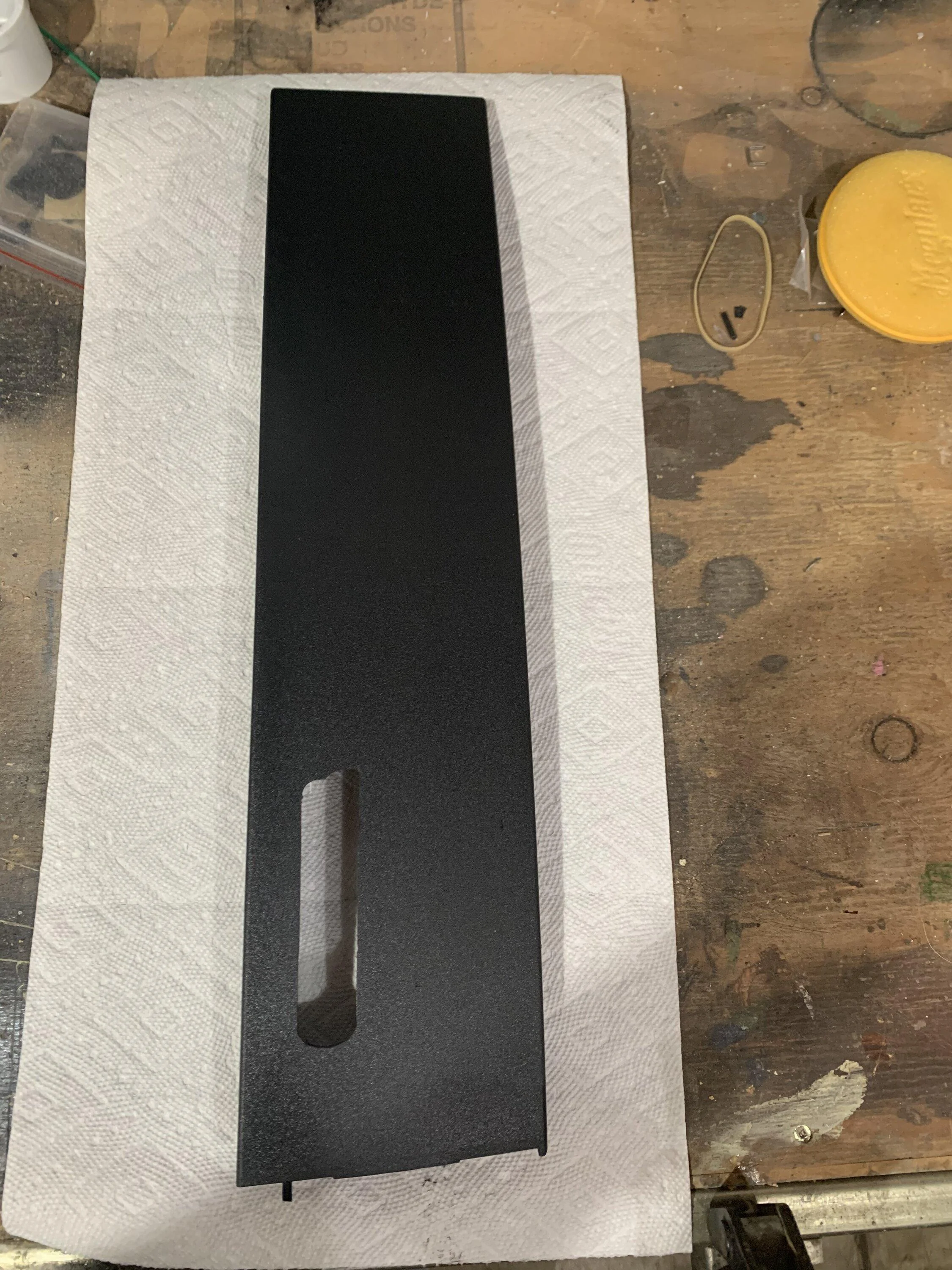

I had purchased the trim piece with cutout. But I also bought a template to make the cutout off eBay. The precut piece arrived first so I used it. I just cut out the original trim. Does anyone want it? I’m a trusting guy. Just pay shipping and it works for you then send me another $30. You’ll save about $50. It cost me $102 for the cutout piece from Tasca with tax and shipping.

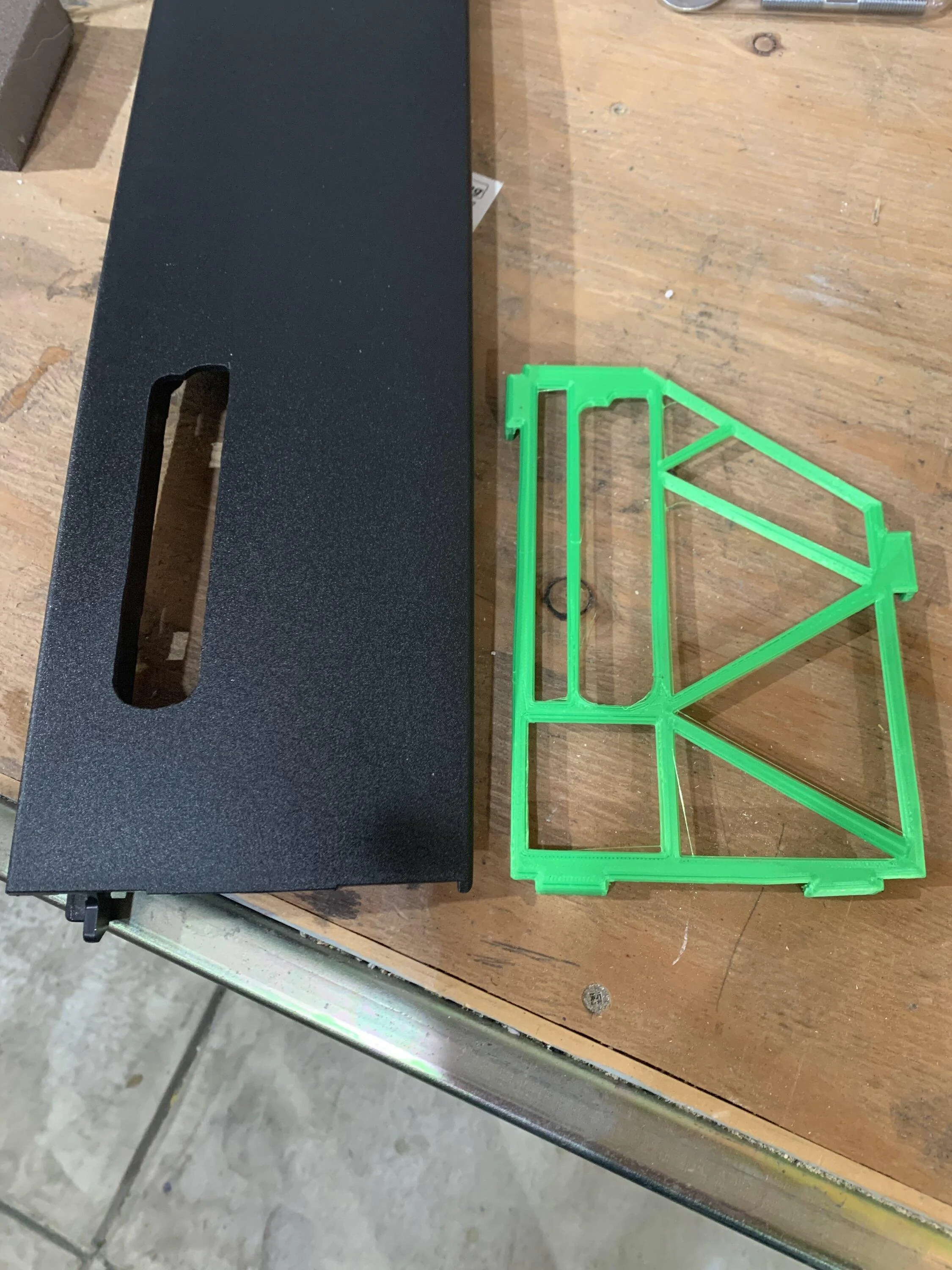

Anyone want this for $15, got it on eBay for $30 plus tax. Just the green template, the trim piece in photo not included
