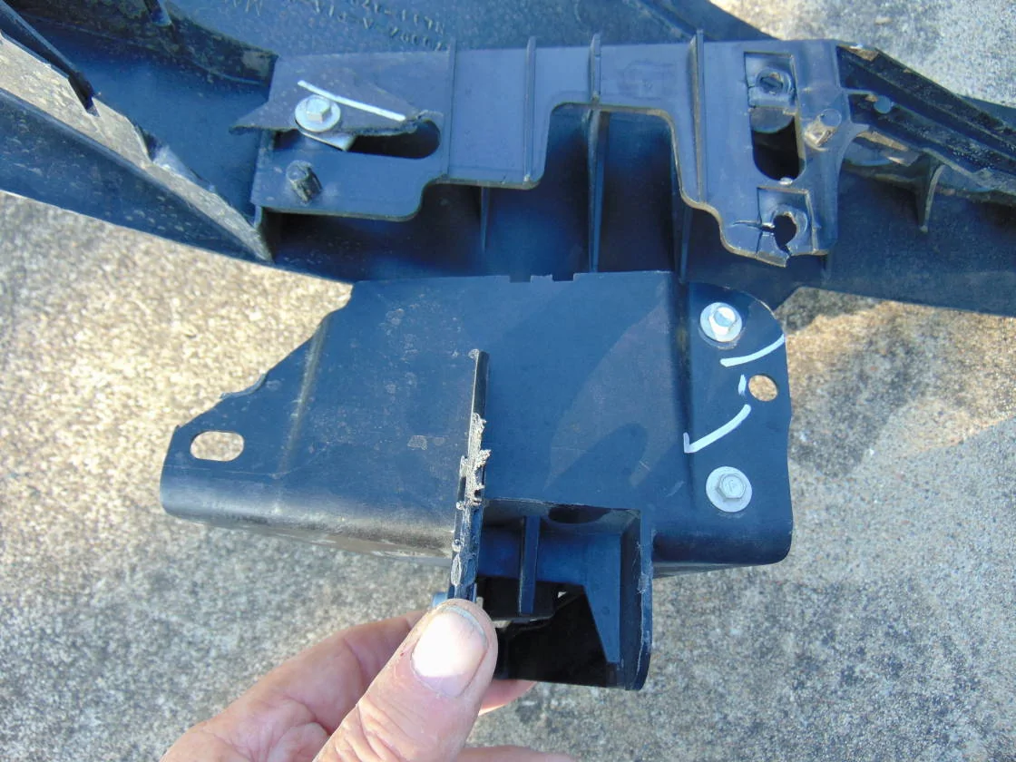

3. The "piece" that connects the valance to the right side actuator is what is broken. If I could order just that "piece" that connects the two pieces I think I would be fine. Does anyone have any ideas?
If you find this broken part on the actuator / motor, please share that as I am more than likely in the same situation other than I know the air dam part that lowers is definitely broken for me.
I also wonder if 3D printing a replacement would be an option? We would need a model and that is beyond my current skill set to design nor do I have a 3D scanner.

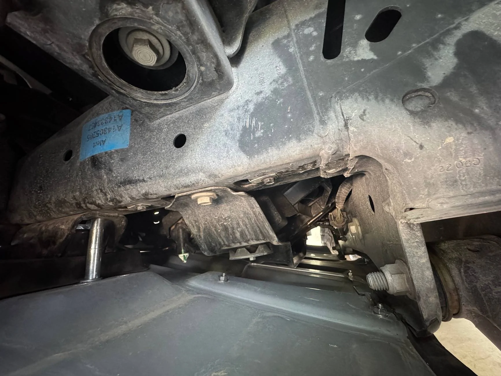

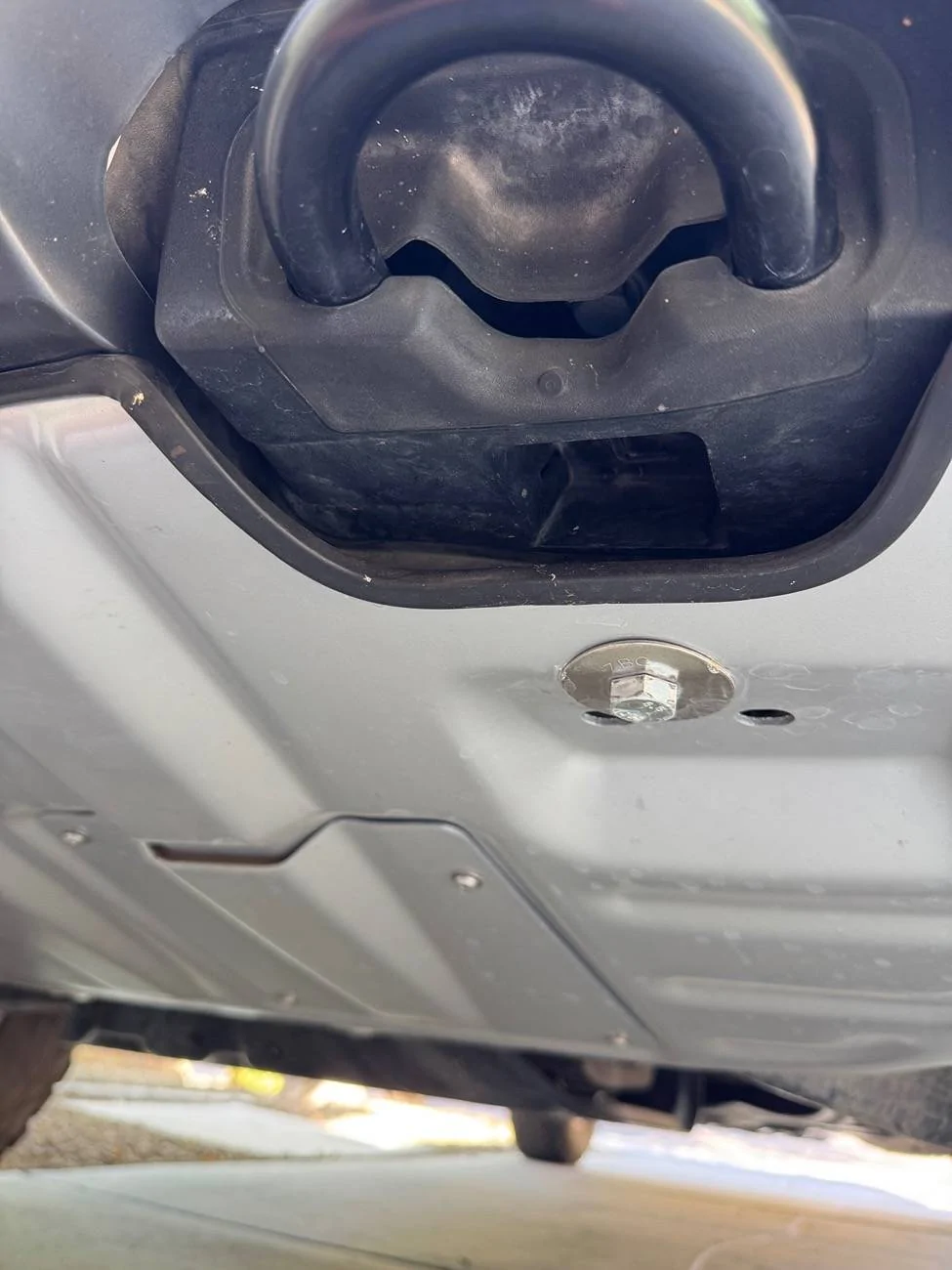

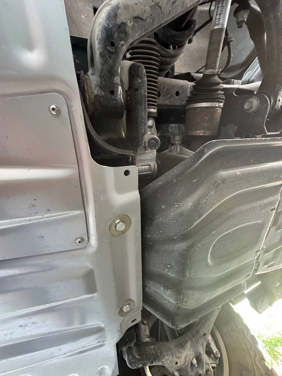

Hi, sorry to bug, but any chance you can take a photo at some point underneath of the mounting points you used?

Okay. Grabbed a couple shots. For the front of the plate, I grabbed one of the two tow hook bolts. Had to get a longer bolt with a sleeve but it lined up well. The rear has two bolts that anchor the skid plate for the front motor. I over drilled the holes on the place to allow for minor adjustments and used washer to pinch the plate back together. If I had a cnc machine it would be prettier but this setup works??
this is great, thank you!

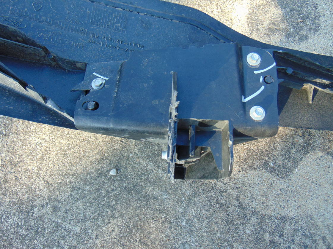

Same thing with me. I had a 2023 Lightning and traded for a 2025. Mistake, but another story. With only 400 miles on my new Lightning I hit a retread. It busted the lower air dam and brackets. I drive a round trip 400 miles every weekend for 14 years and this is the first issue I have ever had. Not even a flat. So, I cannot figure out what in the heak that bracket does. It appears to move freely up and down with no connection to the truck. But they are broken and it looks like quite a job to replace the brackets....slides. I cannot figure out what in the world was so important to put this complicated bracket on in the first place. Now I will need two complicated and expensive brackets and the air dam. My question is, do I need it? Will the after market plate mentioned above work as well? It would be much cheaper and easier to install. Thanks, Charles
