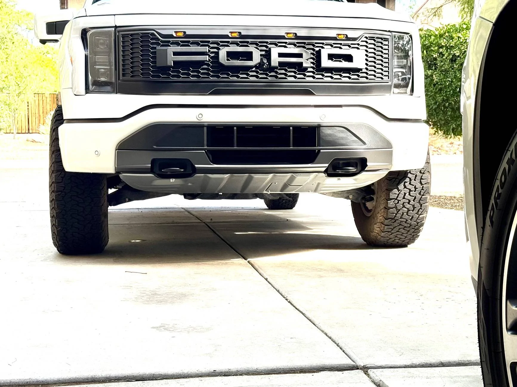

I recently removed everything and opted for the Raptor Skid plate to protect the fans and condenser that only have a molded felt cover. Zero change in efficiency, better looks and no more active air dam fault messages!

That looks really nice. What did it cost? How much trouble?

The fact that the truck is leveled on 35s prior to the skid plate may be why I didn’t see a difference ??‍♂. Got the plate as an OEM take off on eBay. Less than $200 I believe. The mounting holes didn’t quite line up but you are able to capture the tow hook bolts in the front and crossmember bolts in the rear. Not too difficult??

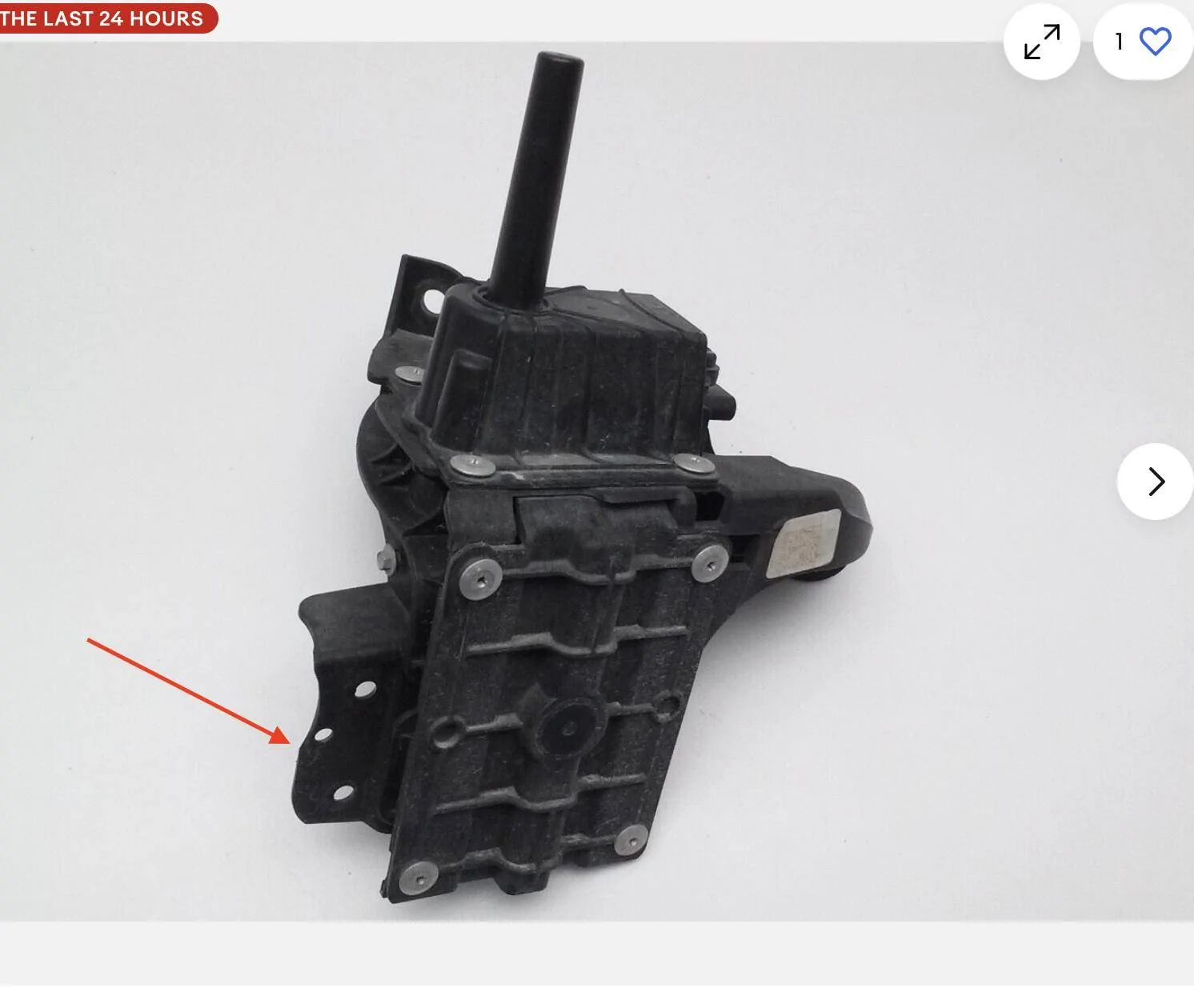

Update for everyone:
So there was less damage than I thought. I actually thought I fixed it with a zip tie, but realized today it was still sagging on one side so I went under the truck and took it apart.
What I learned is
1. Both actuators/motors are functioning properly
2. the valance thing, the big physical air dam part is fine. Only minor rubber scraping on one side
3. The "piece" that connects the valance to the right side actuator is what is broken. If I could order just that "piece" that connects the two pieces I think I would be fine. Does anyone have any ideas?
Also, on a side note. As far as throwing codes etc. It looks like it's all in how you disconnect this thing. I took 3 screws off on each side and only removed the piece that lowers. The two motors are still connected, and as far as the truck thinks, they raise and lower like they're expected. It's just the emperor has no clothes, but the truck doesn't know that.
So there should be no codes or issues as far as that is concerned.
Edit: Looks like I may have to by the whole actuator to get this part. I can get one used for $130 or so.
