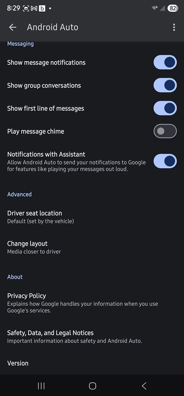

Find "Version" and tap it many times. This will enable developer mode.

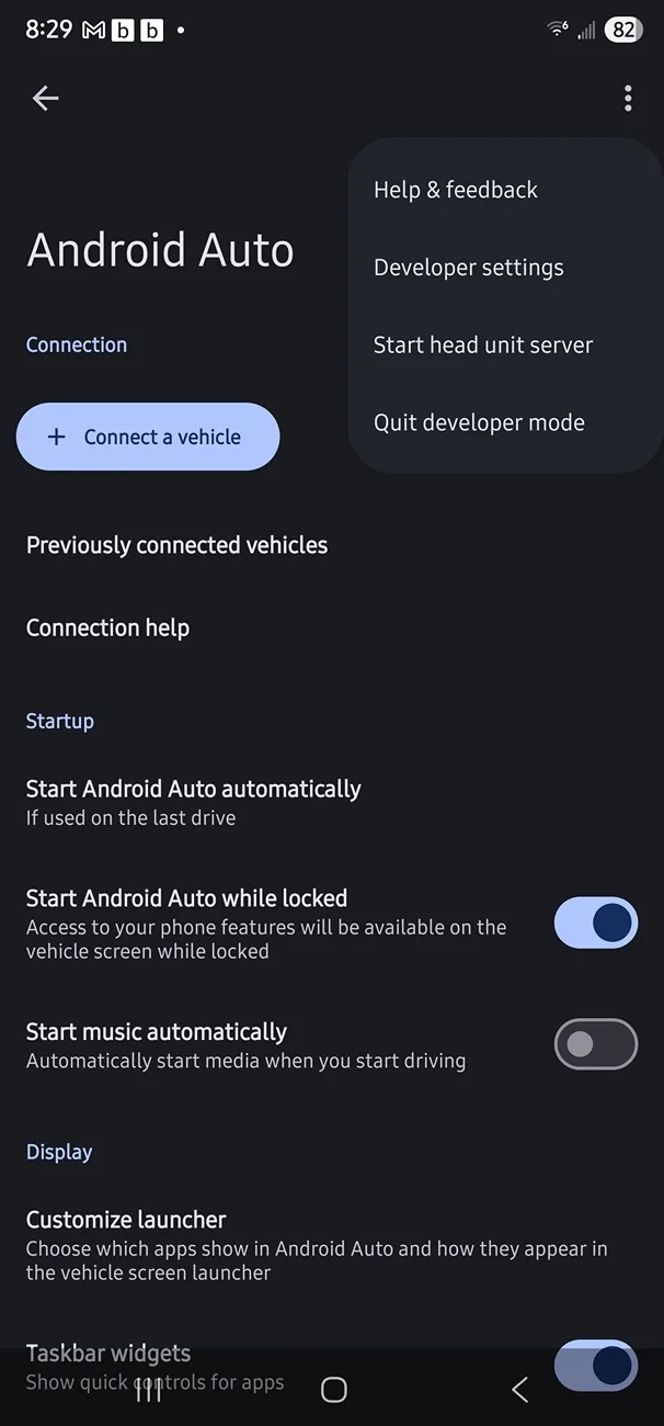

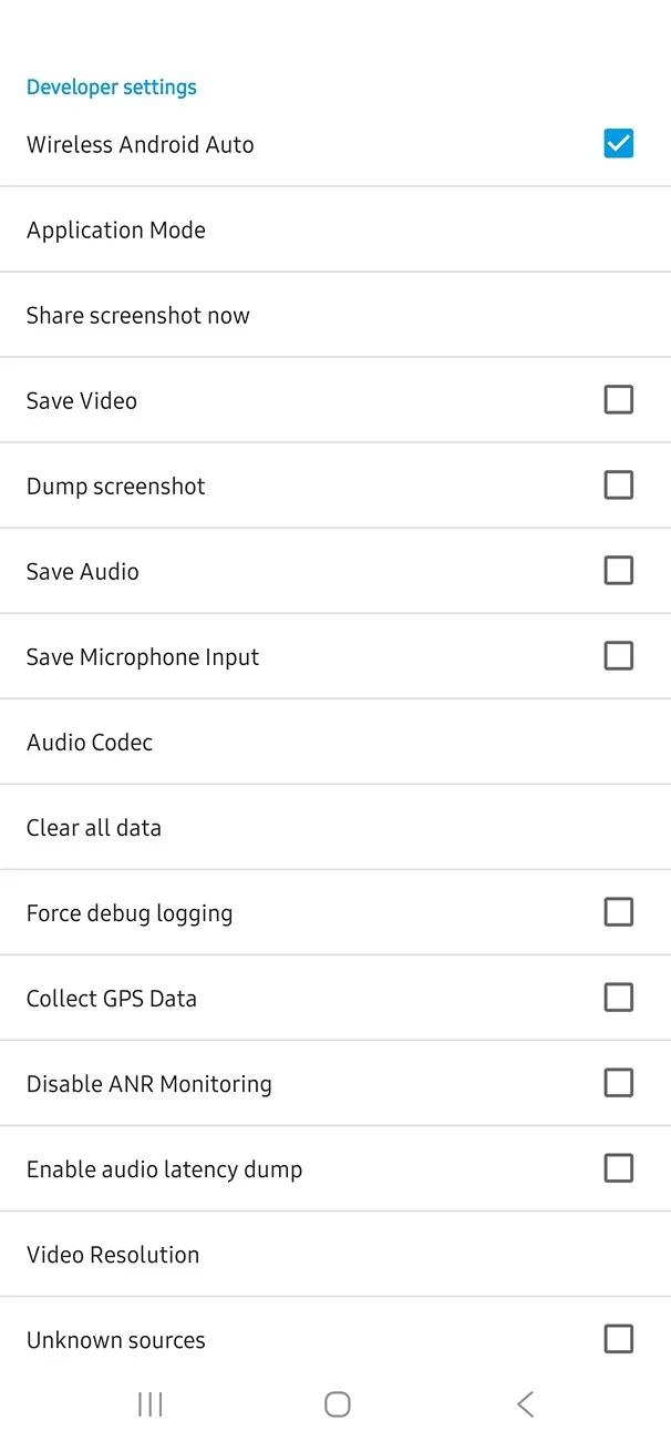

Go to the 3 dots in the top and select developer mode. Turn off Wireless (first option)
Ford F-150 Lightning Android auto without wireless? Screenshot_20260419_082915_Android Auto
This way you are not disabling app projection for everyone.

Thanks for the response. This was the fix! Much appreciated!
