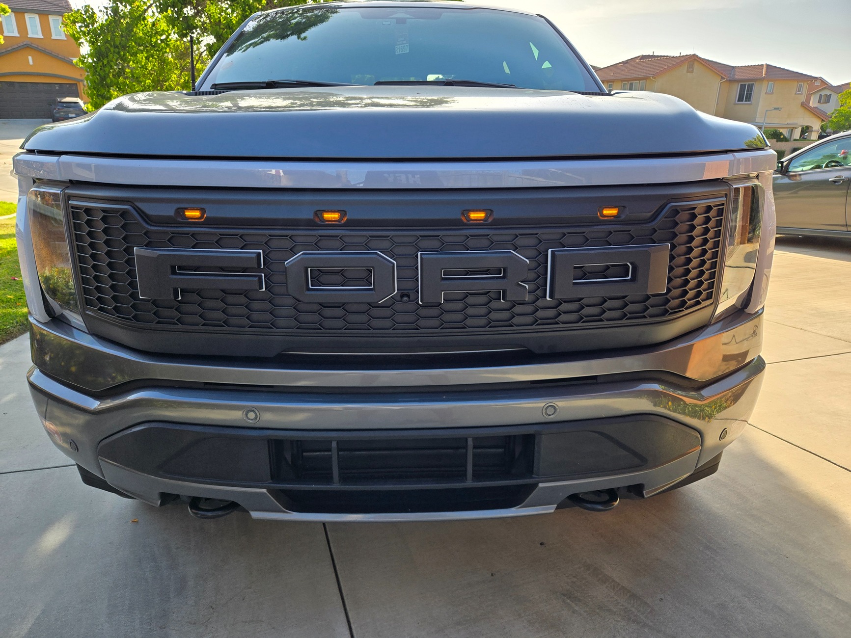

I used an ESP32 to add a little animation sequence to my raptor lights.
Love it! Any issues with the front SVC?

Surround view camera. The 360 degree view that shows up in the infotainment center. The camera for it is part of the front Ford emblem, at the bottom of it.

I can see a tiny bit of the R in the upper left. But other than that, it lines up perfectly.

Can you send more information? Where you got the parts and how much? Did you do it all yourself?

Grille: ( I got off eBay, but same thing)
https://a.aliexpress.com/_msjswPR
You see my photo above of the letters that come with it.
Letter Lights:
https://a.aliexpress.com/_msHF8qN
Code and circuit for animation:
https://wokwi.com/projects/435976606565505025
12v to 3.3V stepdown:
https://a.co/d/iME5ZBV
ESP32C3
https://a.co/d/g00qXeU
Solid State relay board
https://a.co/d/cg9nMiE
Then a waterproof enclosure and a some wiring... And a good amount of fiddling.

Putco Emblem is a much easier route, for sure.
In my case my OEM grill got smashed up, so this was cheaper than buying a new one.
