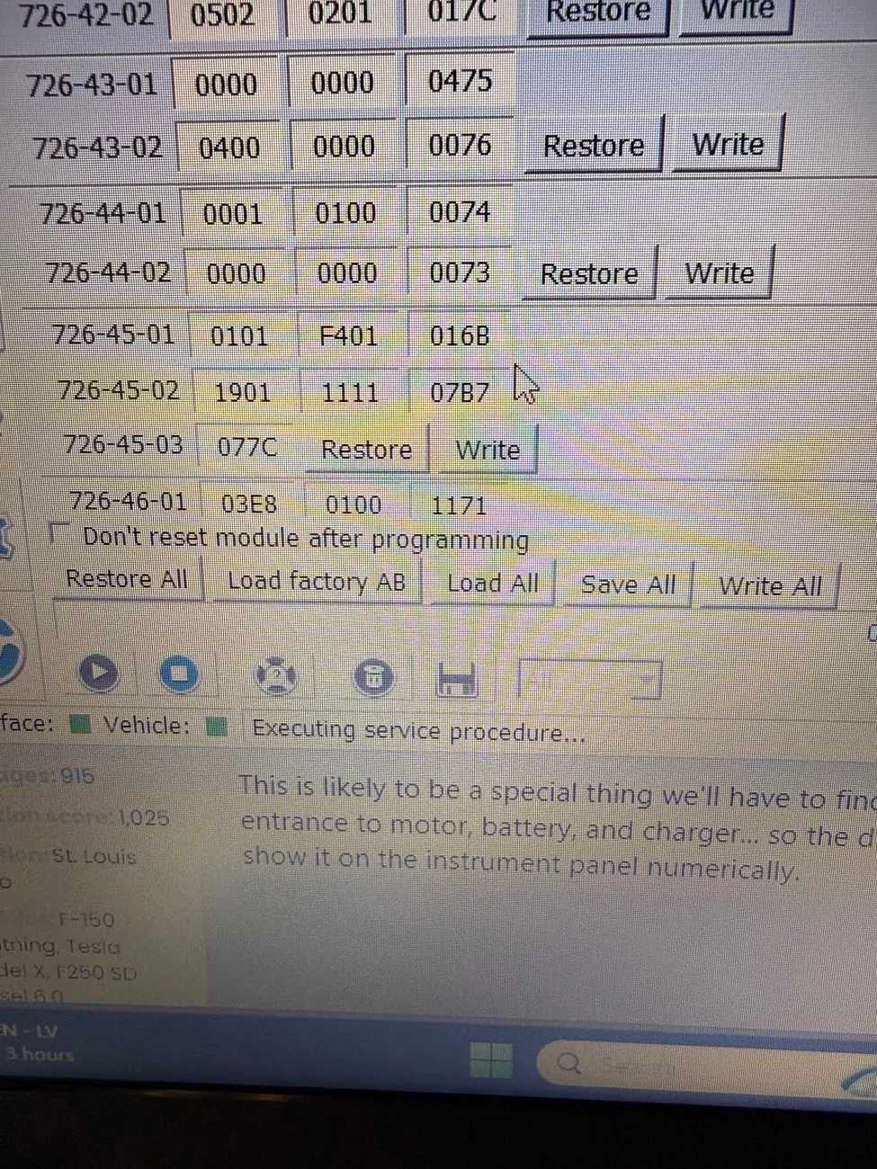

Hello everyone,
I recently got my 2025 F-150 Lighting. Last night I did my first mod, the Matrix aka Glare Free headlights. Super cool, I love it.
My question is, and this is after I’ve searched multiple threads and spreadsheets, how or where do I code the headlights to come on instantly when going under overpasses, garage parking and tunnels. I looked at several pages and went into Forscan and I can’t seem to find the specific place and coding ( value ) to do this.
The 726-45-01 according to a spreadsheet I saw is where I can configure that, but other places says it is a different module.
Any help would be greatly appreciated, I apologize if this topic has been previously touched.
Have a great day y’all!!!!

Locations can vary based on model and even year. Did a little tinkering and this may be what you want. Changing the value from 0 to 5 went from the default 15 seconds to near instantaneous on my 2023 when I blocked the sensor. Appears to be the same on the 24/25 sheet
AmbientLightSensorType_Cfg (ALSTC)
726-37-01xxx*xxxxxx--0 =ALSTC ALS_SETTING_03 =ALSTC ALS_SETTING_3
1 =ALSTC ALS_SETTING_14 =ALSTC ALS_SETTING_4
2 =ALSTC ALS_SETTING_25 =ALSTC ALS_SETTING_5

Thank you very much!!! I just did it and it worked.
