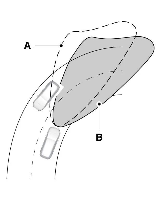

Good question. According to the 2022 Owners Manual, the feature is called Adaptive Front Lighting.
How Does Adaptive Front Lighting Work
Adaptive front lighting adapts when you are steering around a curve.
Ford F-150 Lightning Adaptive headlights not working after headlight change 1730067145641-0o
A
Without adaptive front lighting.
B
With adaptive front lighting.
Switching Adaptive Front Lighting On and Off
Set the lighting control to the autolamps position to use adaptive front lighting.
Note: Other lighting control positions do not turn on adaptive front lighting.
So basically you would turn your headlights to On instead of Auto. Note, the truck will always return the headlights to Auto on each start so you'll have to turn the switch from Auto to On each time you test.
