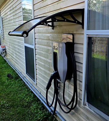

Awning for FCSP

Should help it. I can't get away with that as unless I installed it high enough to walk under it would block the walkway. Putting it that high would likely reduce the effectiveness.

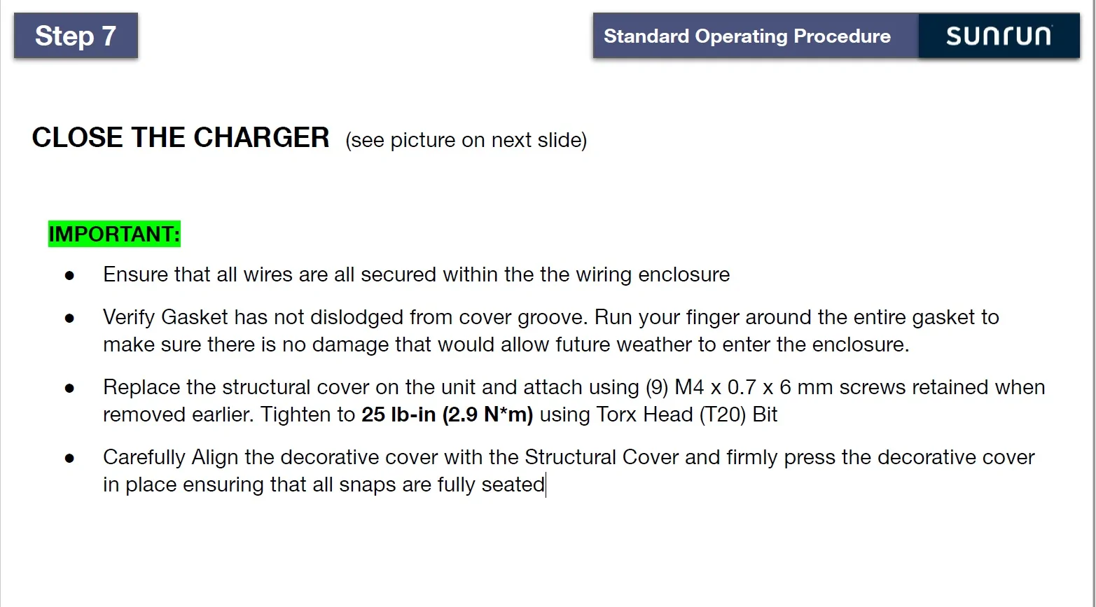

The cover does have a water resistant seal but your installer might have pinched it or not followed the proper torquing procedure for the cover. Also, if the cable going in isn't sealed properly it could also let in water.
