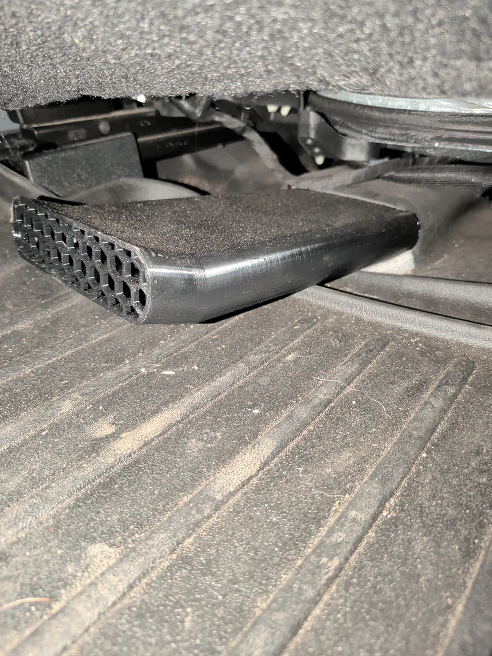

I too have the same back seat not warming situation - will try the 3d printed extensions. Anyone figure out the defogging? I would agree with some others that this seems to be a weak point, at least with the 2024 Flash/heat pump models-

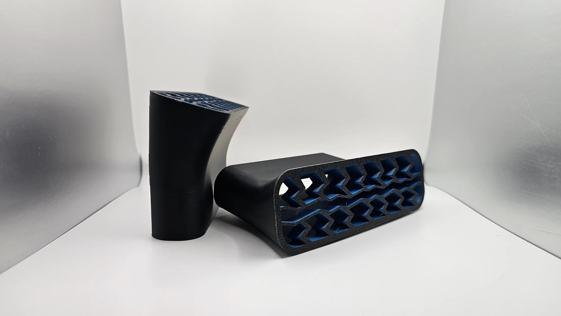

I think the vent extenders will make a big difference. With the way they are currently situated any hot air that comes out gets shot directly under the rear seat.
I have some that are designed to spread the air out and direct it upward to alleviate this issue.
I need to get mine to market...
I thought about designing one too but the Thingiverse extender linked in this thread angles it upwards at the end. It's not just a straight back duct. Fanning it out some might be nice to have though.

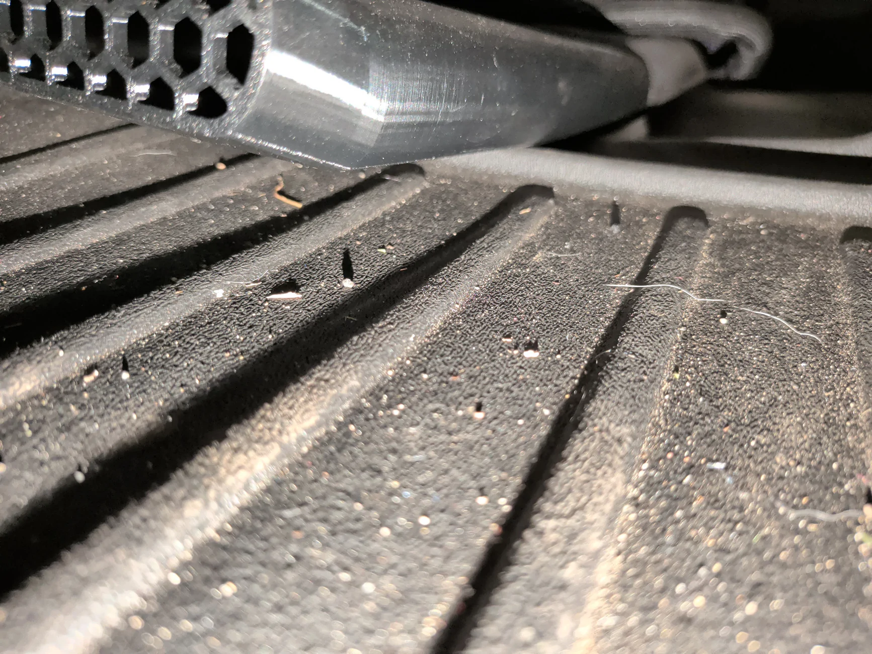

I will check that because I have Weathertech floor mats with a raised edge.
THIS ^^
I also have WeatherTech mats and got a set of the long vent extenders. The stock rear seat floor vents blow underneath the raised edge of the WeatherTech mats. I tried a set of short extenders but they weren't long enough. Got a set of long extenders and they work great, they fit over the top of the mat edge.
Check all of your favorite online stores (Amazon, eBay, Etsy ...) and search "F150 rear vent extender". It's not just a Lightning issue. Your search will likely auto complete at "F150 v" since it's a common issue on the most popular vehicle in the USA.

THIS ^^

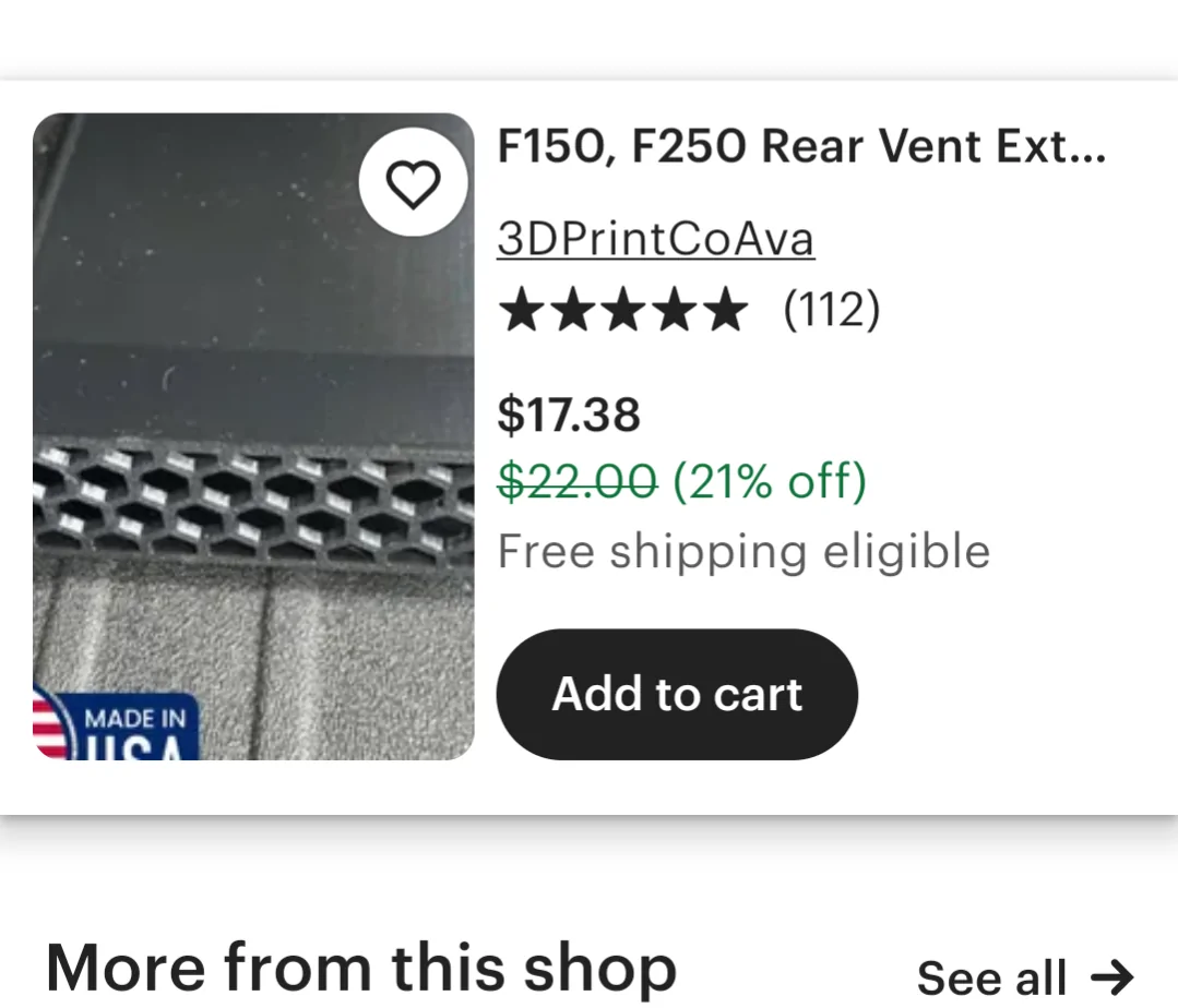

How long are these, I want to make sure the ones I choose are long enough to make a difference.
B177y
Bill
Jul 16, 2024
791
1,077
Olympic Peninsula, WA
9 inches. Of all of the choices available on Etsy, they are the longest. Link
Linking to Etsy is treating me weird. Here is a screenshot of the maker that creates the long extenders:
