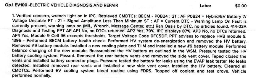

I have a 2024 Ford lightning with 630 Miles got the Orange wrench Dealership said it's a bad battery module they say it will take five to 10 days to get one, then two days to install How common is this ? On this forum There seems to be a lot of these Types of failures​
Well, its been a 14 day process I think longer due to a module that was damages in shipping but i have it back now and its running good this is an overview of what they did. I got to say Bowen Scarff Ford in Kent Wa was awesome kept me informed all through the processes I assume all the tech speak mean something to someone LOL
