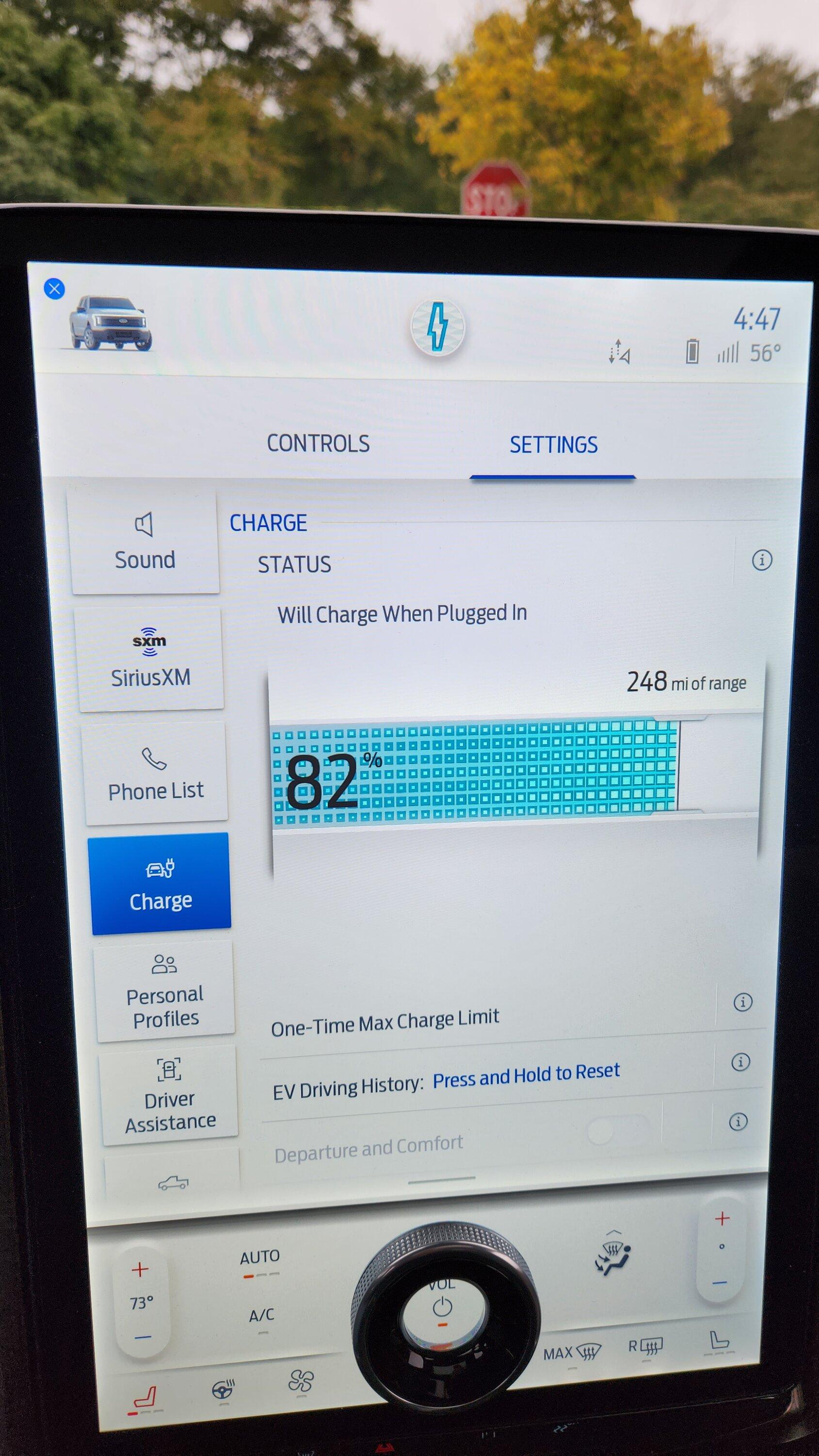

So I have an ER lariat. My battery has dropped 70 miles in range in a week. I don't do much highway driving maybe 15 mins every other day at 70 to 75, no hot dog driving, no towing ever, charge only with a normal 110 outlet in my insulated garage. I'm in CT and the temperature has been in the 70s to low 50s at night. My garage does not get much below 50 even in the dead of winter.
I charge to 90% like the manual says on a 110 outlet. I get in the truck after it's changed to 90% and it says I have 250 miles of range. I drive less then 2 miles and I'm down to 82% charge.
I should have 320 range at 100%. I understand losing some range. But 70 miles? I don't understand what going on? I also reset my EV driving and nothing changed.

248 miles at 82% means 302 miles when battery is full, that is not bad.
1.5 miles per kWh is way tooooo low, be frankly I don't understand how you can achieve that. local drive with one pedal I easily achieve more than 2.6 miles/kWh, mixed with 65 miles on freeway is 2.3 miles/kWh.
Yes I agree, I was getting those kind of ranges but I'm the last day or so it fell off a cliff. That's why I posted here. Not sure if something is wrong or not.

67mph and the truck is set on "73* Auto", therefore trying to heat up the whole cabin that's cold-soaked from a night at 50*. Plus the battery is cold soaked, too, as someone else mentioned.
So, you're driving pretty fast (nothing crazy, but pretty fast) PLUS the truck is expending a bunch of energy trying to heat everything up during your short drive.
If you were driving 50 miles, the cabin would be warm after 5 miles and the battery would be warmed up, so then the mi/kWh will probably come back up to a normal number for that speed/temp.
I mean, there COULD be something wrong, but I'm betting it's just the short trips at sorta high speeds with LOTS of heating that's making your range seem worse than it would be if you actually needed to use all that range.
