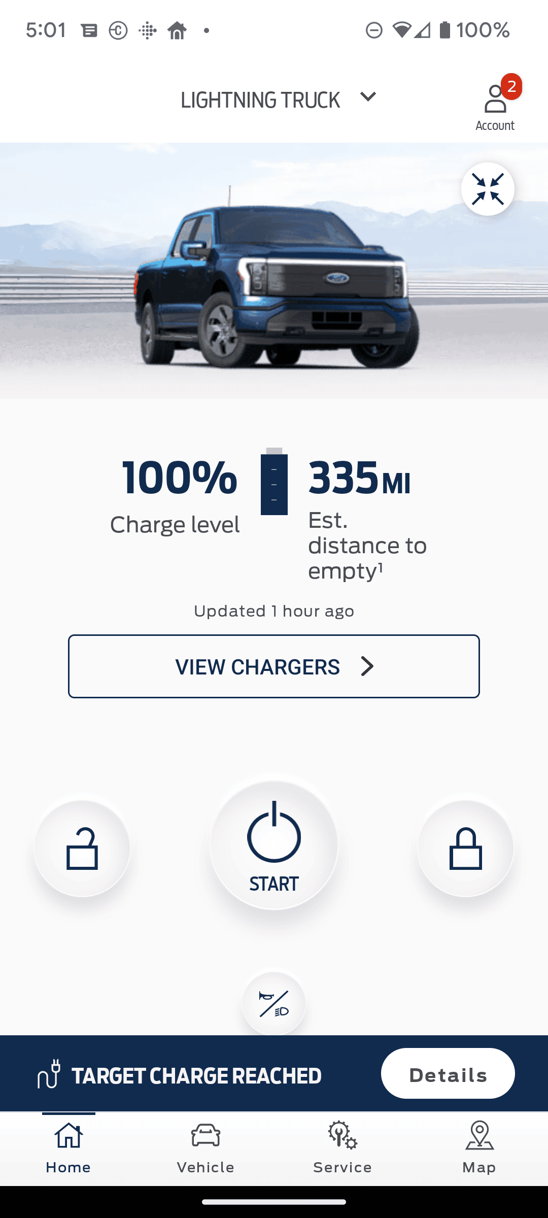

Let the truck learn from your driving habits.
Put some miles to it and you get the numbers way up.
First statement is correct.
Second is not. Driving will yield a more accurate range, not a higher one. Lower for most. 2.56 miles per kWh is higher than most will get.
Completely agreed. My lifetime average (after only ~700 miles to be fair) is between 2.0 and 2.1 mi/kWh. As we head into winter and I do a planned road trim in a few weeks, I expect it will continue to fall and level off around ~1.5 to 1.7 mi/kWh or about 190-220 miles at 100%.
