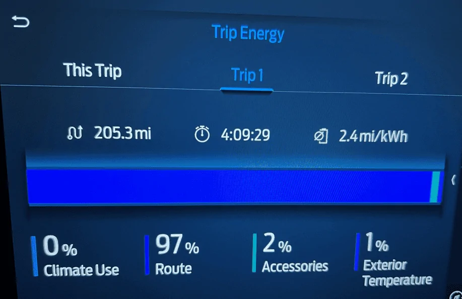

Have you checked your trip energy results when you are driving? I have found on a cool (not even cold) evening with a cold start the trip energy is devoting a lot of energy to "Exterior Temperature" which is battery conditioning and "Climate Use" which ends up being the cabin heater.
I wish that Ford would provide an HVAC indicator that the cabin heat was on when you are in Automatic climate control mode. It would be great if it indicated how much power it was consuming. I've had several times when trying to stretch my trip distance I've turned the HVAC off just to focus as much energy to "Route".
Here is a pic when driving on a really nice day and I was getting 97% to "Route" energy. Accessories (12 volt stuff) always seems to be 2%.
