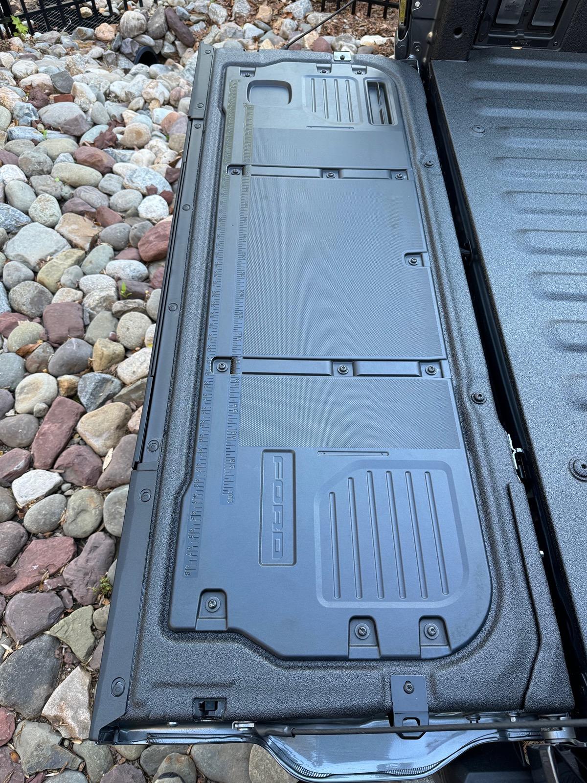

I did not get the plastic part covered, I told them to remove it and the side "bottle openers" hardware, apply the liner then reinstall said parts. I think it looks good and works great :)

Yeah I think that makes most sense. Good to know it can be done that way. Did they remove all the other hardware in your bed?

Yes other than the bed bolts to the frame.

Mine was also done the same way. I think it looks fantastic!

I’ve had a spray in liner in the last three trucks I’ve owned an F-350 and two F-250’s, in all cases I left these in. They goto self crimping bolts so you’d need to get new bolts plus never had any reason to remove the bed bolts. If you ever did need to remove them it would be doable. Not worth the hassle to remove them for a spray in liner in my view, but certainly doable ?.

That’s how I had them do mine also
