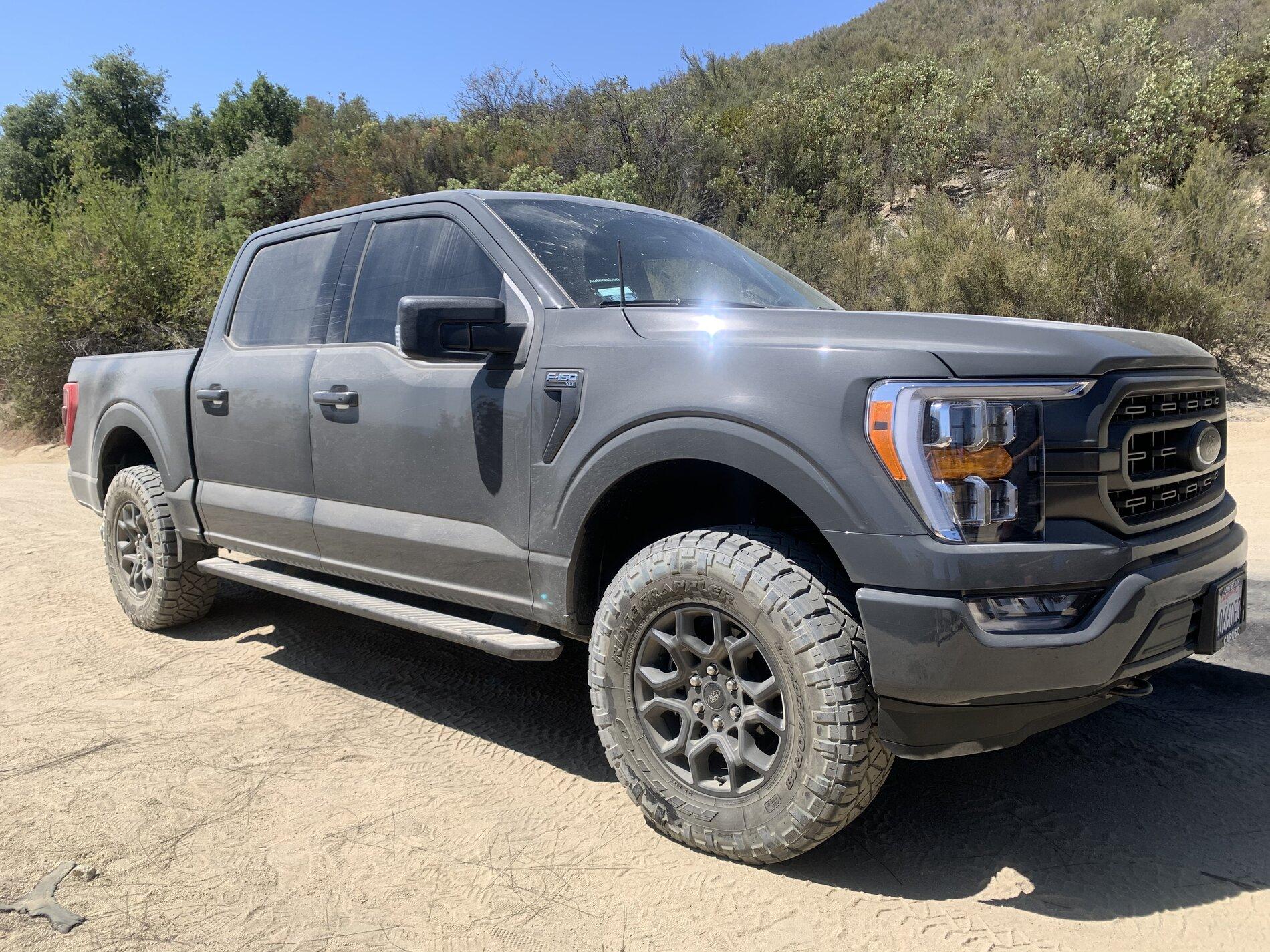

Alright guys so a little feedback on the bilsteins 5100s after my off-road trip with @Lex_310. Overall they performed great! When going at slow speeds it absorbed dips and bumps smoothly and felt very controlled. Since they are more firm than stock it felt a bit on the rougher side if I started to take stuff at higher speeds. This might also be because they are brand new and need to be broken in some but I will update over time. Overall I recommend them and had zero issues with them on our 4 hour trail.

You could have left the spacer lift on and just set the Bilstein's to the lowest setting. You would of ended up with 2.25" of lift and excellent riding vehicle.
Yeah I might just do that, either that or just drop it 1 setting. Surprisingly though it feels to have loosened up a bit after my trip and feels super smooth on the highway now! Rides buttery smooth ?
I was thinking about dropping mine down to the second notch (0.5" of preload) and getting a 2" spacer. That would put me at 2.5" Which is almost level.
Is yours on the stiffer side as well?
