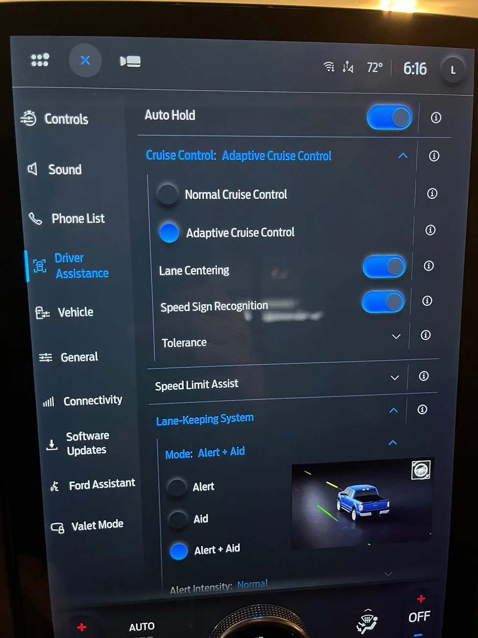

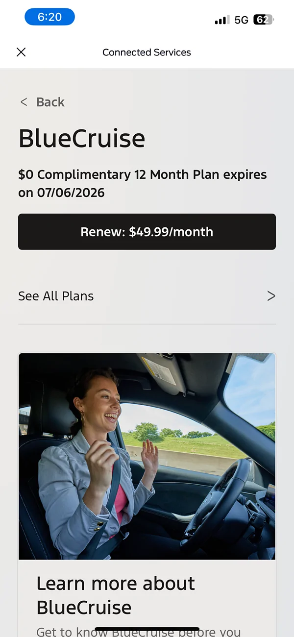

I believe I’m supposed to see an option here for Lane Center with Hands Free. Is that correct? When I check connected services, it says my complimentary BC doesn’t expire until next year. Is there something else that needs to be enabled?
Yea, I saw your BC is active and yes you are supposed to have land centering with hands free there. Do you have FORScan?
