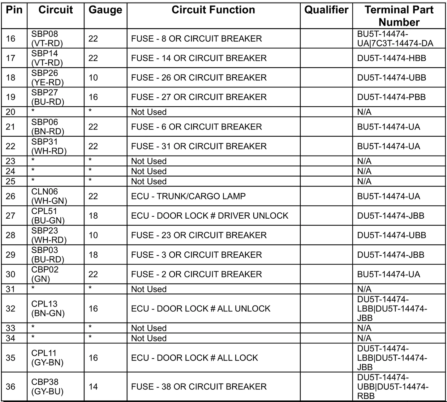

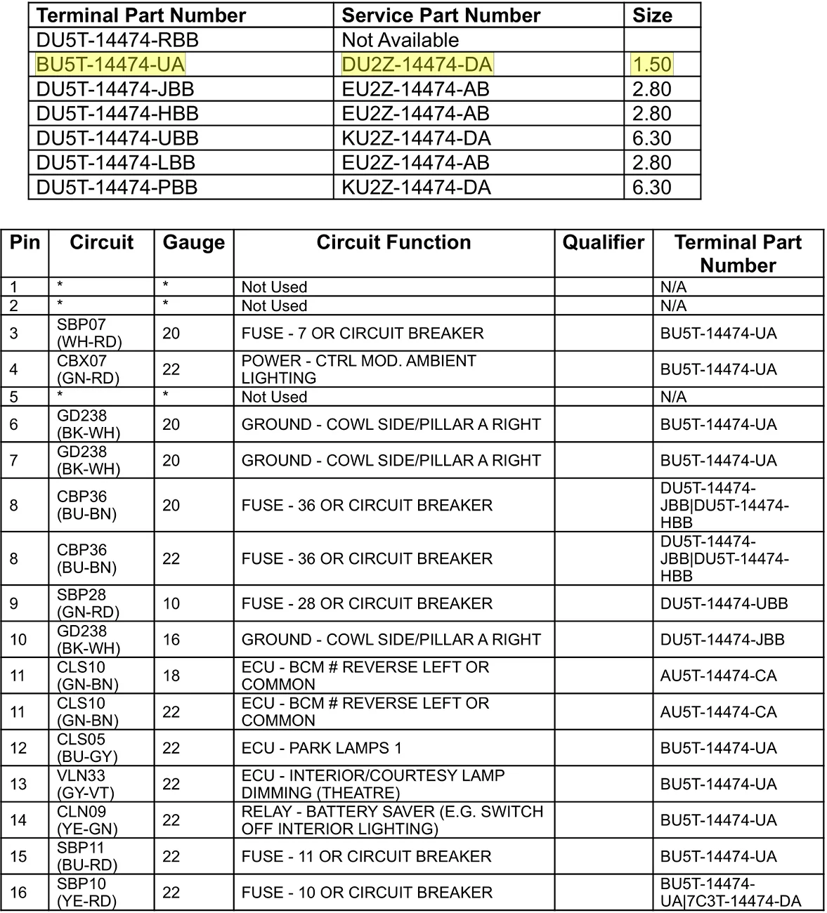

Some Molex MX150 terminals I've used for DU2Z-14474-DA.
DU2Z-14474-DA, or Molex PN 34083-2002 MX150 Cable Seal Female Terminal, 18 - 20 AWG.
34083-2002 MX150 Cable Seal Female Terminal, Tin Plating, 18 and 20 AWG, Right Reel Payoff - https://www.molex.com/en-us/products/part-detail/340800002
https://www.mouser.com/ProductDetail/Molex/34083-2002-Cut-Strip?qs=lzT3SgJKZn1lCIaNLhDb6g==
34083-2003 MX150 Cable Seal Female Terminal, Tin Plating, 22 AWG, Right Reel Payoff - https://www.molex.com/en-us/products/part-detail/340832003
https://www.mouser.com/ProductDetail/Molex/34083-2003-Cut-Strip?qs=lzT3SgJKZn20iHqG3tLIkg==

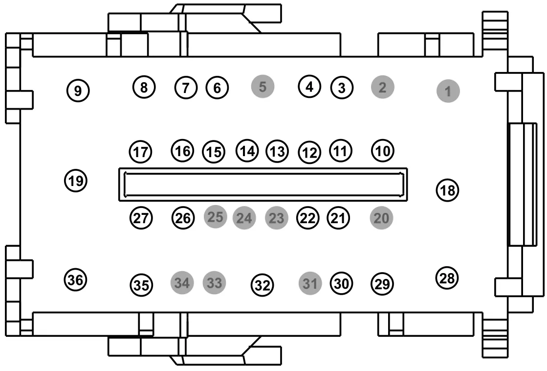

2024 BCM 2280C:
2024 BCM 2280C:
Perfect. That's exactly what I *thought* they should be. Thank you!
I think I'm going to order some, come up with some test loads, and see what happens :)
