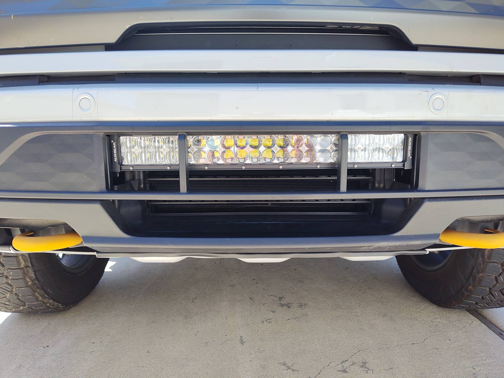

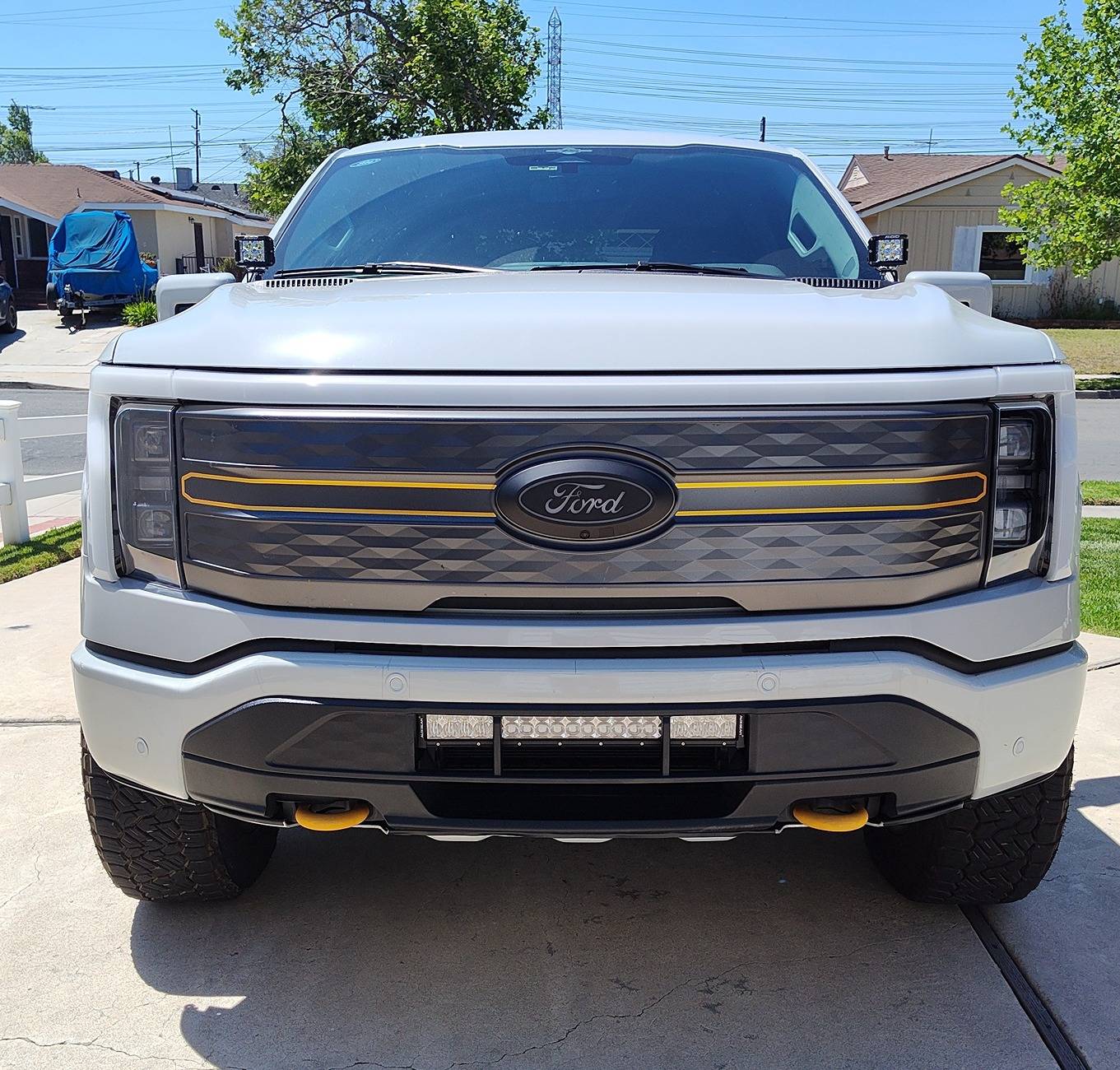

Done, mounted slightly higher than I wanted but overall I'm happy with it. Also installed some rigid ditch lights.

Looks great. Looking to get some ditch lights installed on mine.
