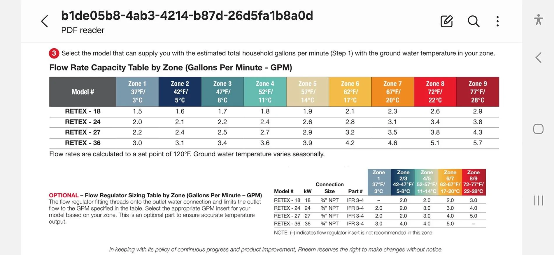

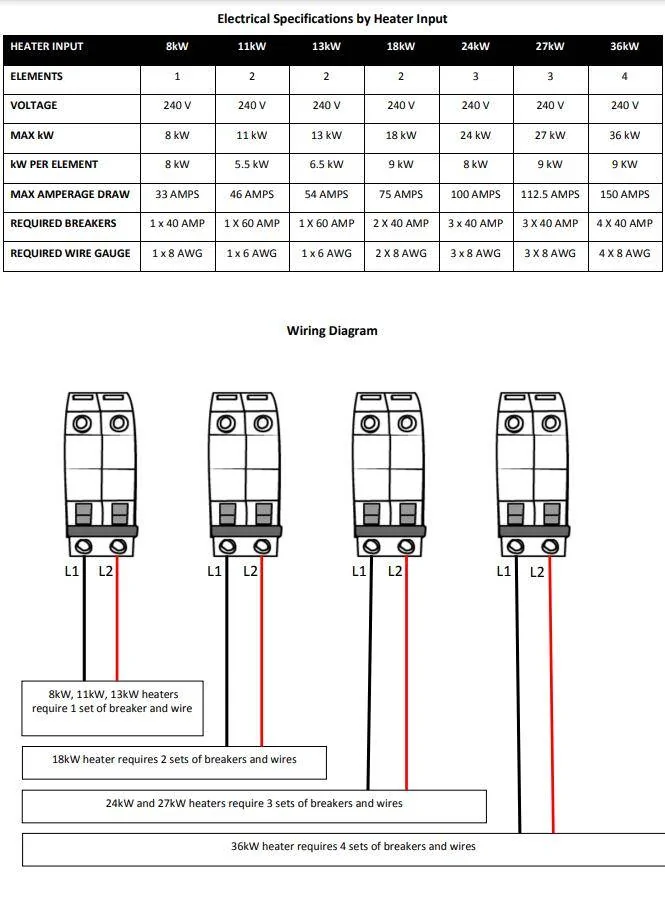

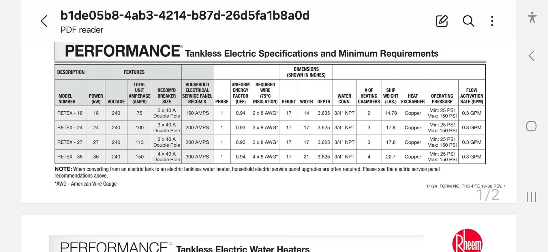

Once again you're completely wrong. I've been in the plumbing trades for 49 years. I can count on 1 hand the amount of whole house electric tankless heaters I've come across. Reason being is it would take a dedicated 150 service just for the tankless. Very rare to see a 400 amp panel, unless I'm at a home with a real hydraulic elevator which I do see on occasion.
When we tear down homes from the early 1900-1980's and build new, of course we have completely new panels. But Ladwp , Los Angeles department of water and power doesn't replace transformer on the pole that typically service 6 homes. There was a home in the neighborhood that spent 1 millon just to eliminate the overhead wires going across his rear view. But when you build a 25,000 square foot home, it's a drop in the bucket. Yes, his home has an electrical vault because of the size of the home and underground service. But the majority of the homes are overhead wires and 1 transformer for 6 homes. These homes originally didn't have car chargers, Air conditioning and anything built now in the last 3 years is all electric. No gas. Dwp is not upgrading the transformers just because we have electric cars. But if 1 was stupid enough to attempt to install an all electric tankless heater, they will be paying for the upgraded service, just like we pay for upgraded water meters above 1".
Gas tankless are typically 199,000 btu's where a tank heater is 34,000-40,000 and up to 75,000 on a larger 75 gallon heater.
A 36kw tankless water heater in a warm climate zone will only deliver 5.1 gpm. While in a cold climate only 3 gpm. A gas tankless will deliver up to 11 gpm which sometimes is not enough for homes I work on and require 2 gas tankless heater.
As you can see just from a typical Rheem heater, 36kw is a 150 amp draw, asking for 4 sets of twin 40 amp breakers. And a minimum of a 300 amp panel. Maybe out on a farm with 3 phase it might work, but residencial homes in Los Angeles, Beverly Hills, Santa Monica where I've worked the last 49 years, it's not happening. We use gas tanks, gas tankless or electric tank heaters . Not electric tankless. But that's all changing to electric. And the electric heater of choice is an electric tank hybrid heater. 4.5kw with a heat pump booster that brings the efficiency to 5x that of a gas heater.
So once again, California has 1 active nuclear power plant (Diablo Canyon) and 1 that is being decommissioned. (San Onofre) Most of our power plants use natural gas with steam turbines to provide power. With a population of 4 million just in the city of LA, and LA the capital of electric vehicles, (293,000) I don't see how we can continue to build out high power super chargers without upgrading our infrastructure. Especially since everything is going electric and not natural gas anymore.
Rick

OK, uh, great. Regardless a thankless doesn't take 86 THOUSAND watts, like you claimed. Nor does some rambling statement about the fact of gas and electric tank less water heaters support your argument that the power grid cannot support electric cars. Nor is California the rest of the world. Nor is the decommissioning of a nuclear reactor a statement as to the ability to provide power.
Beyond that the fact that you "cannot see how" the grid is being upgraded does not in fact mean the grid is not being upgraded.
At the end of the day you start your statement with a pedantic and condescending remark, and if that is the best argument you can put forward you really don't have much of an argument. Now I could continue to point out the inaccuracies in your statements but since this has turned into some rambling mishmash it would serve no purpose and continue to be beyond the point. At the end of the day having done plumbing in no way informs you as to the macro level discussion as to the state of the US power grid. And as you open admit, you "don't see" a lot, including what is happening to the grid.
At the end of the day we will just continue with the fact you thought a tankless water heater for the average house needed SIX, 60a breakers, and recognize the rest of your argument is as well informed as that.

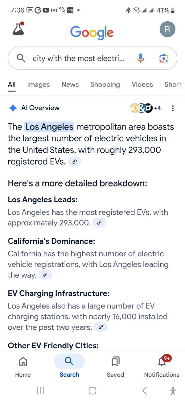

Right now there is a Tesla supercharger location within 1.2 miles of me with 44 250kwh chargers. And even a larger one 4.3 miles away with 62 , 250kw chargers. Not uncommon to see it running 90% full.
The costco in my area is the busiest one outside of Hawaii. With more than 20 pumps and typically 5 cars deep. 4 tanker trucks a day to keep it supplied.
Now imagine if they build out a BYD charge station at that Costco. People will still be lined up for the 5 minute refill. Where will all that power come from? Still will be a line as we have more electric cars in LA than anywhere else in the country.

Please show me where I said an electric tankless uses 86,000 watts. I said 36,000 watts. Might want to check your eye prescription
You're either clueless or don't know the first thing about electricity. I always stated 6 -60 amp breakers to feed a 150 amp load. Using the 80% rule as required. You do realize 2 breakers make a 240 volt circuit. Some heaters use 3 heating cans some use 4. Either way it's still equates to 4x40= 160 amps which Rheem is actually wrong since the load is stated at 150 amps. or 3x60-180 amps worth of breakers which is my original statement which accounts for the 80% max load factor.
Just like my level 2 charger is a double 50 amp breaker to power a 40 amp load to produce 9.6kw.
Now were talkling 36kw. Almost 4 times the load of a 40 amp charger just to produce 5.1 gallons of water in a warm climate or 3 in a cold climate. Not sure how you bathe or shower. But neither 1 will work for my customers. That's why nobody uses them out here. That's why the newest craze is hybrid electric tank heaters. Not tankless electric.
Sure hope you don't play electrician or plumber. And especially not a mathematician.
Not going to continue wasting my time until you read correctly, use a calculator or understand plumbing and electrical. It's been fun, but honestly, I have billing to do, not teaching plumbing and electrical 101.
Rick

Rick

per Rheem:
Model NumberRTEX-36
Kilowatts36kW
Recommended Breaker Size(4x40)A
Voltage240/208V
Recommended Wire Size (CU)8 AWG
Min. Flow (GPM)0.3
Max. Flow (GPM)8
Amps150A
Ford F-150 Lightning BYD announces 1000V battery, 5 min to charge Screenshot 2025-03-19 6.58.38 AM
while any whole house Water Heater system like this may require up to 4 double-pole 240v breakers in your panel, and up to 150a of total capacity, AT FULL WATER HEATER OUTPUT, it's also not going to be 'usual' for the max output, or the max 150a capacity, to be used at most any given moment. Yes, two showers and clothes washing and dish washing 'might' all happen at the same time... but... all elements don't draw at the same time, all the time - but only when needed, in rare occasions. " a sensor measures flow rate while another sensor measures the incoming water temperature. This information is transmitted continually to the computer logic controls which decide how much power to send to the heating elements to heat the water to your desired temperature. "
'lectricians will most always build to the 'worst' case scenario and may demand a 400amp panel, along with all your other regular electrical needs...
but, the reality that all of that happening, at max capacity, and at the same time your two air conditioners are going, and the oven is baking, and the stove is cooking... all at the same time... no, not reality.
Or, it's the middle of the night, and your EVs are pulling amps... you're probably sleeping, not showering and cooking.
Unlike a traditional water heater which operates both AS your are using heated water, and as needed to maintain temperature throughout the day, the USAGE-BASED tankless water heaters ONLY operate during that VERY SHORT timeframe that the heated water is needed, and NEVER again throughout the day or night. A long shower might be 10-15 minutes. A clothes washer might require heated water for 5 total minutes of it's cycle. A dishwasher about the same. etc.
This amounts to about 30minutes to 1hour in a WHOLE 24 hr period, and probably not while your EV is charging, and probably rarely, if ever, using the full 36kw capacity.
I like the idea, and would not hesitate to replace a tanked water heater with this type of system in our 'standard' all-electric 200amp home, with our two full EVs, two 30amp heat pumps, and a separate mini-split... although we never use 'all' of those at the same time.
