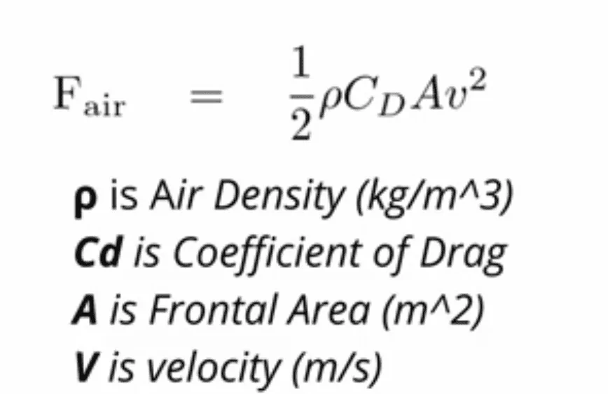

Mirrors have cameras on them. I am not sure if BlueCruise is using them. It will definitely help your range. By how much is a matter of your speed.
with both mirrors folded you reduce the area wind is fighting by 650 centimeter square. Find the cross sectional area (A) of your Ford, plug in before and after and you get the idea. I hear Cd for Lightning is 0.56.
Ford F-150 Lightning Can power folding mirrors increase range? 1675294756069
or just drive the same road on the same day/ around same time and compare.
