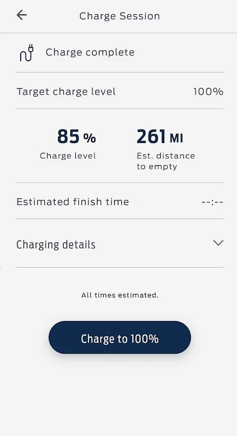

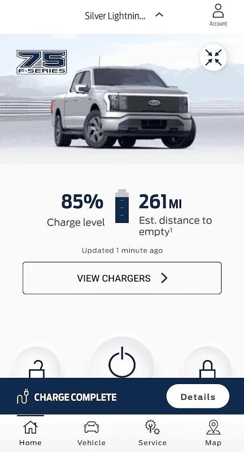

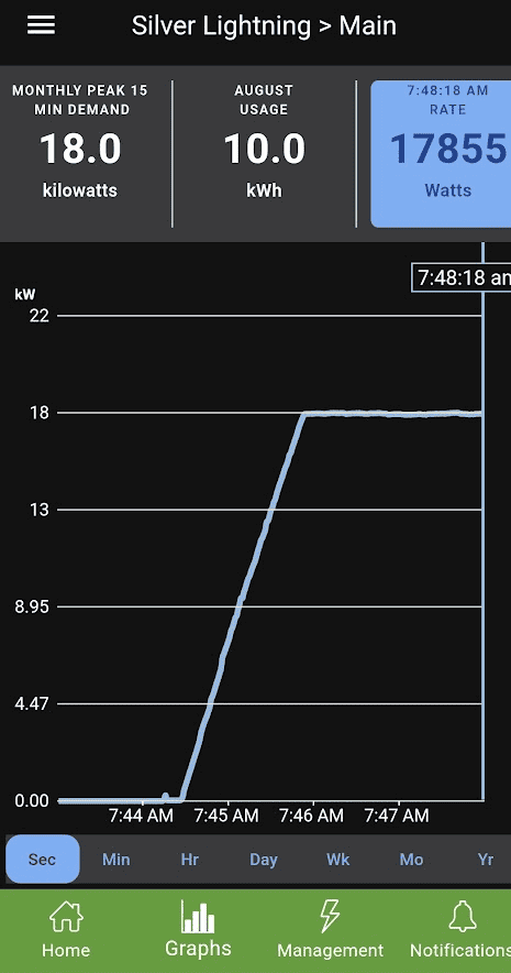

Quick testing of FORDPASS app charging [DETAILS] screen:
Ford F-150 Lightning Charge % change on app 1691323066041
Appears I have the controls listed while plugged in, I see the charge to 100%.

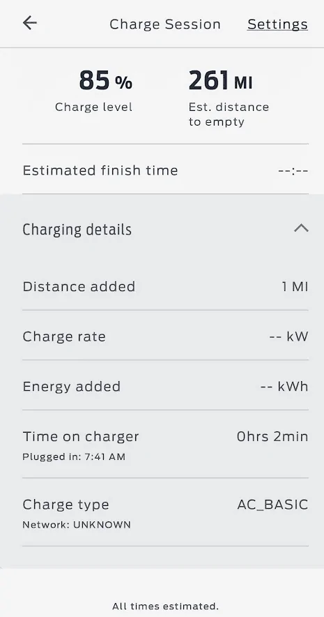

The one defect is that the[Charge Rate] and [Energy added] are NOT being logged during the short 4 minute test.

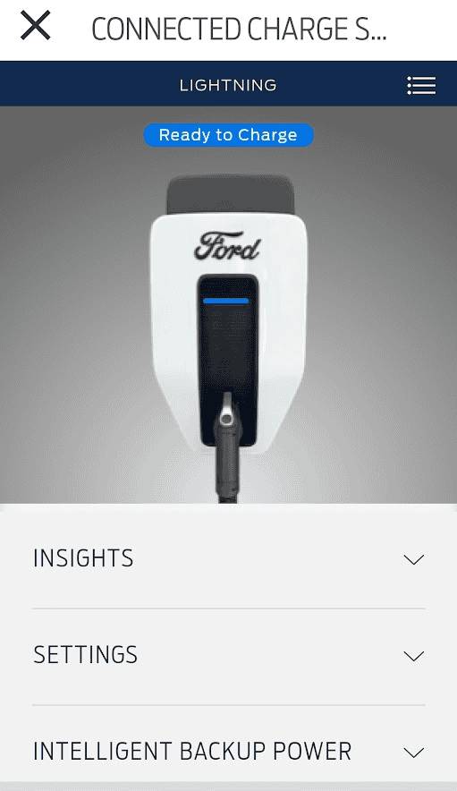

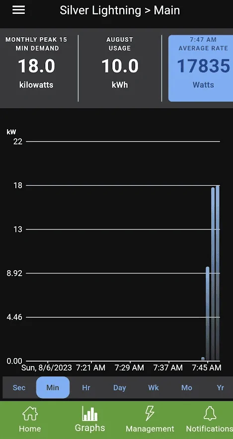

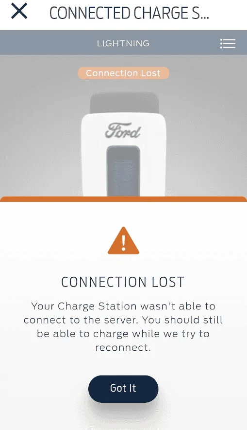

A side note that has been an issue since Friday evening (maybe longer since I had not recently looked) is that the FORD DATA CLOUD is reporting my FCSP is not talking them, this happens appx weekly to every couple weeks. I can use the FORD CHARGE STATION SETUP utility to connect the FCSP via my home network with no problems, but for what ever reason it's into reaching the FORD CLOUD to report metrics like my Friday/Saturday (after midnight) top off charge)
Ford F-150 Lightning Charge % change on app 1691323351097
@Ford Motor Company please have the folks look at the databases which log our charging data & let the mobile device app developers fix the charging data details in an upcoming version !!

So, after a returning from morning errands, I power cycled the FCSP, had to wait about 5+ minutes and now the FORD cloud is recognizing my station, IIRC another network savvy forum member observed and postulated that the FCSP's internal networking protocols are sketchy leading to a ~hung session~ situation, the power cycle might have cleared this issue, or the Ford Cloud woke up to a fresh new week.
