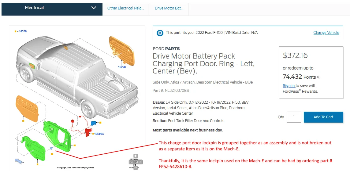

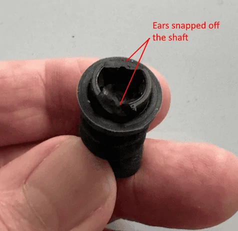

While getting the Lightning washed recently at a carwash I frequent (monthly subscription), the first set of brushes came into contact with my left fender hard enough to pop open the charge port door...and since the second set of brushes it encountered turn in the opposite direction they ended up removing my outer charge port painted cover panel and snapping off the lockpin.
The outer door painted panel was removed cleanly and was laying to the left of the track in the employee walkway, the pin was snapped off at the base (locking ears on the pin snapped off).
Ford F-150 Lightning Charge Port Door Lockpin Replacement Chargeport_Lockpin_Broken
So I was lucky that there wasn't any actual damage to the outer painted door panel (not even a scratch), and I lined it back up with the inner door panel tabs and slid it back in place, and then headed to my Ford dealer's parts counter to get another lockpin. After a few minutes of searching we found that the chargeport lockpin is not broken out as an item separate from the door assembly...you are expected to buy the whole thing.
Ford F-150 Lightning Charge Port Door Lockpin Replacement Lightning_Charge_Port_Lockpin
Turns out it is listed as a separate item on the Mach-E, and it also turns out it's the same pin (I checked the one on my car to make sure).

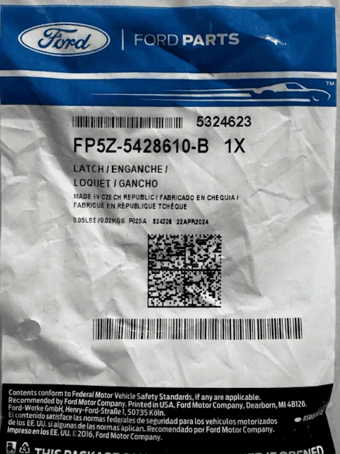

Here's the pin you're looking for if yours breaks, FP5Z-5428610-B:
Ford F-150 Lightning Charge Port Door Lockpin Replacement FP5Z-5428610-B
My dealer has them listed for $10.63.

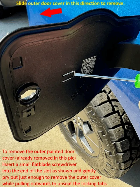

I checked the workshop manual to find out if there was anything specific on how to replace it or to get the outer door panel back off (the correct way, not the carwash way), and found nothing at all concerning that lockpin or the outer painted door panel, absolutely nothing.
So to get the outer painted door panel off to secure the new lockpin you insert a small flat tip screwdriver into the edge of the locktab and gently pry outwards while sliding the outer painted cover away from the side of the truck.

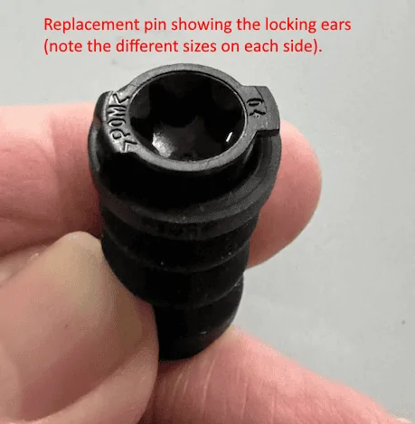

Here's the detail on the replacement pin showing the different sizes of the ears:
Ford F-150 Lightning Charge Port Door Lockpin Replacement Chargeport_Lockpin_N

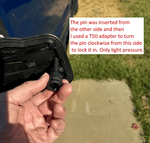

From the chargeport side of the door enclosure, insert the base of the pin with the ears lined up to match the opening in the panel, and then from the outer side, gently turn clockwise with a Torx 50 bit to lock the pin into place (about a quarter turn does it).
Ford F-150 Lightning Charge Port Door Lockpin Replacement Chargeport_Lockpin_Inserted
All that remains is to line up the outer painted cover and slide it back onto the inner chargeport door. All done.

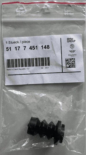

A small update: As an additional resource should you need it...the same pin is available as a BMW/Mini part as well. I ordered one of these from ECS just to confirm that it was the same. It is.

A couple years ago, my dumb ass backed out of the garage after forgetting to close the cover and knocked that part off. Ordered it for $12 from a BMW supplier and keep a couple on hand because, once again. I'm a dumb ass.

Mike, Thanks so much. The person related to me through marriage thought I inhibited her entry to the garage and hit my door. It took about 15 minutes to replace with your instructions. As always I was able to educate my dealership that I only needed the $25.00 part for the Mach-e and not the whole $250.00 assembly for the Lightning.
I do have to run out to get T50. I could get it to turn enough by hand to hold it but still a little ways to go to sit it correctly.

I’ve seen the BMW part is identical and cheaper than what I paid. Maybe worth checking?
I bought two of those as well. They are identical. In the glove box and ready for the next carwash adventure.

Called the one dealer in town and they have no stock of it either.
I used some FordPass points and ordered online with delivery to local dealer. Paid near MSRP ($9.57) but saved on shipping.
