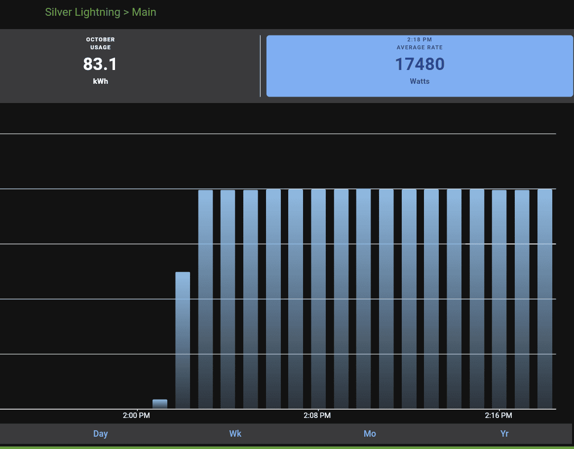

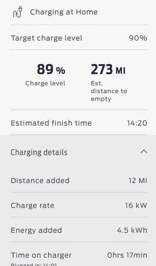

Interestingly the Fordpass shows a normal rate of charging 16KW is usually what it shows even though the Emporia meter shows a little more.
Emporia Vue2 chart shows customary full charging rate of 17 to 18 KW

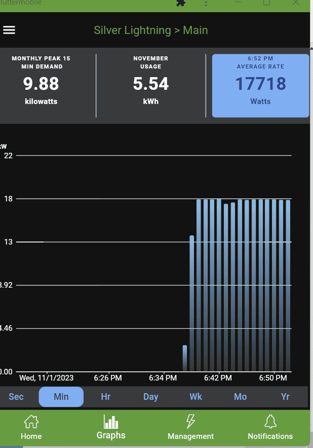

Maybe it was a glitch that resolved itself, or not, I don't often derate my FCSP, did so to facilitate experiments for other members. Also the FP app has been performing poorly in sending receiving data updates, and that's part of the problem with the derate lamp being lit.
My Fordpass app under reports the KW rate of charge, while dialed in calling for the full 80 amps aka 19.2 KW, I'm routinely charging at only 17-18KW with the FP app showing 16 to 17 KW, this devaluing could reflect net energy stored in the battery excluding conversion loss.
Gross energy consumption:
9.0 kw = 37.5 amps @ 240v
11.5 kw = 48.0 amps @240v
18.0 kw = 75.0 amps @240v this is typically what my Emporia logs shows
