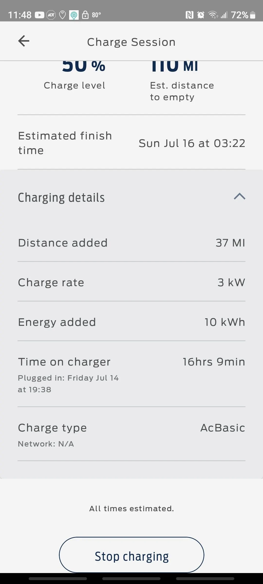

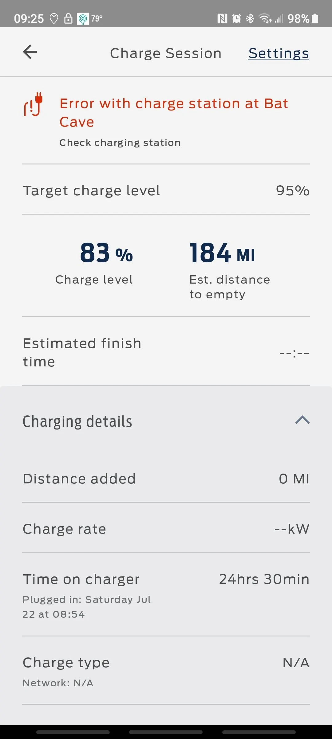

The attachment show what I've been getting with a 240v on a 50A. I'm sure my mobile charger has an error.
What color lights are lit on the charger? That should indicate the error.

Sometimes Orange but for the Error red on the charger and red on the truck charge port
Red is bad. If it’s pulsing, it means ground fault. A single intermittent flash or solid means internal error, which means your dealer should replace it.
