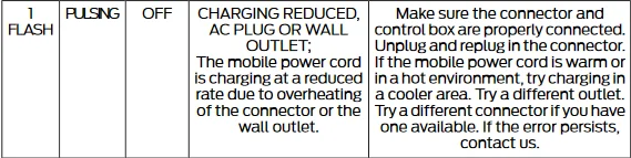

There is a different light sequence to indicate overtemp in either the plug or the unit. Itโ€™s in the manual.

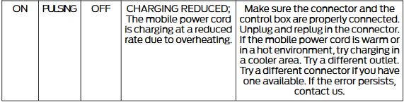

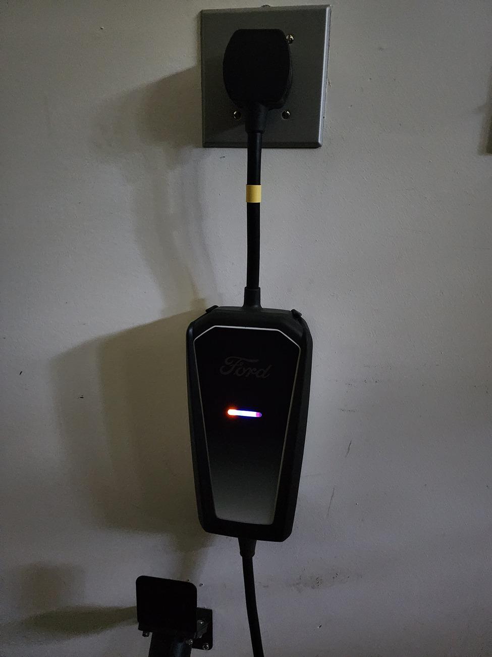

I'm in the same boat as OP, started about a month ago when the temps started rising. Lightning is in an insulated but not temperature-controlled garage. Doesn't usually get past 80F in the garage, but had a couple hot days where it got up past 90F in there (and this is Oregon!). Last night I checked, and the light sequence is as the OPs; verified in the manual (pages 202-204 for reference) that this appears to be the unit itself. 50amp professionally-installed circuit and NEMA 14-50 outlet, been working fine since the weather started being consistently warmer.
First column is Amber, second is Blue, third is Red.
Ford F-150 Lightning Overheating Ford Mobile Charger 1721231037387-rq
Ford F-150 Lightning Overheating Ford Mobile Charger 1721231118208-
