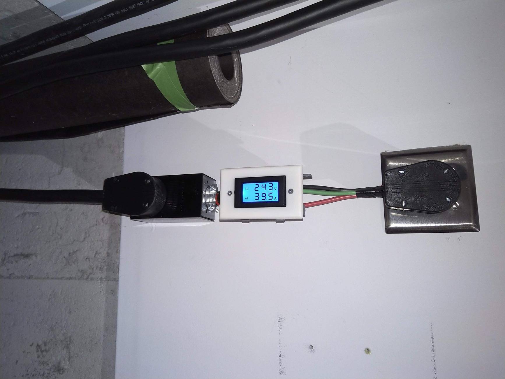

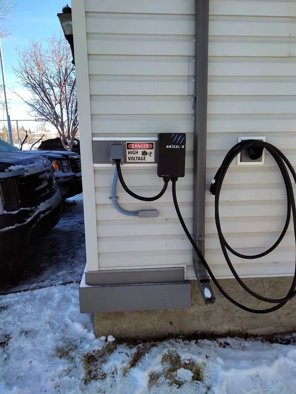

I have the same charger, its set at 40 amps as well. using a voltage and amp meter it will pull 39.5 amps at 243 volts. to calculate power the formula is Power =current x voltage in my case the power = 39.5 amps X 243 volts or 9598.5 Watts. Or 9.6 kW. My ford pass app shows the same as yours 8.7 kW, which i think they are calculating by dividing the power added in kWh by the time charging in hours. attached are pictures of the meter i used and the charger.
Why the sticker?
