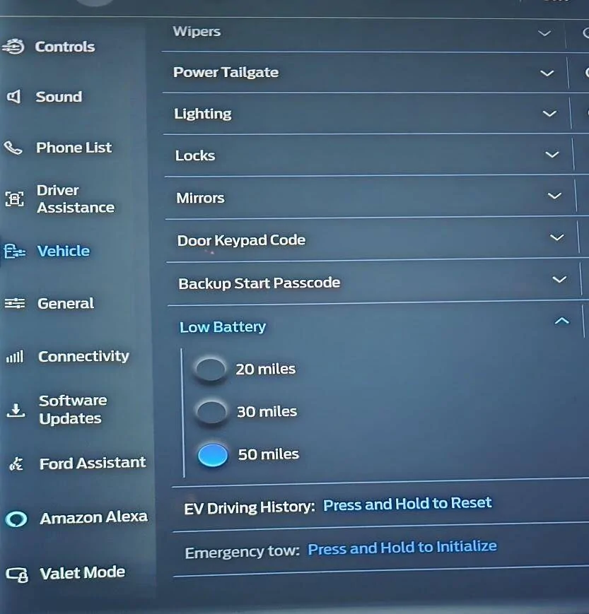

Keep looking, there is a setting in pro power on board that lets you adjust the energy reserve to a lower mileage, it's primary purpose is to ensure that you NOT run your truck out of energy while in generator mode, adjust this setting from 50 miles to 10 miles it will also affect the navigation warning IIRC, select a value & irritation balance so that your not caught dead on the road.
Let me correct myself and FYI to all the PPOB and Battery range warnings are separate settings, if you want to curtail the nagging, go to Settings, Vehicle, Low Battery, select the miles that fits your tolerance.
During todays NH road trip, I had this go off with a 50 miles to go setting, tweaking the PPOB setting only curtails the PPOB stay on or off messages.
Ford F-150 Lightning Charger out of range alarm 1734219991926-x

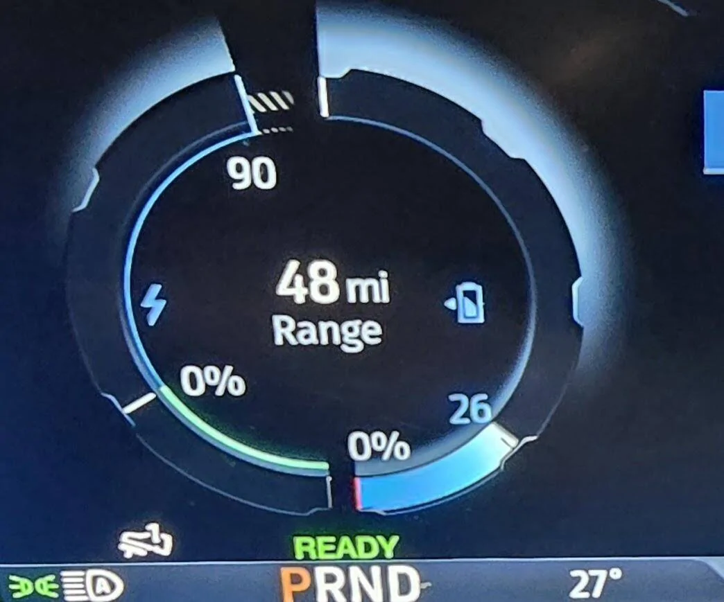

Before adjustment & After lowering to 20 miles, this is a rather pessimistic estimation based on an overall 1.8 MPK on an ER battery would be 61 miles remaining, it's reserving 13 miles of electron fumes.
The day trip was mostly highway, running a relaxed 66 MPH on gentle rolling hills of southern New England, {95, 495, rt-3}
