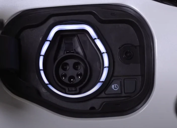

No problem for the Lincoln assuming any new EVSE you get has a J1772 type plug - the Lincoln will not ask for more current than it's internal circuitry can handle.
I have a 2012 Nissan Leaf with a similar low-ish current on-board charger that I have used since I got it with a 30A 240V EVSE (GE Watt Station).
Some of the Ford EVSE's use a CCS1 which is the combo-plug on the Lightning (unless they've switched to the NACS/Tesla plug already). The CCS1 includes J1772 pins and adds 2 big pins for DC fast charging out on the road.
