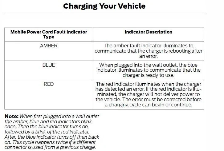

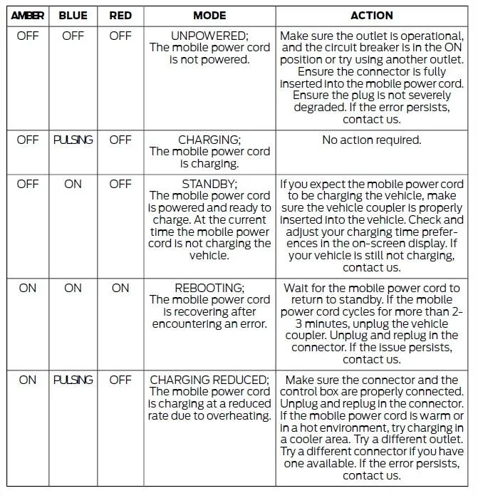

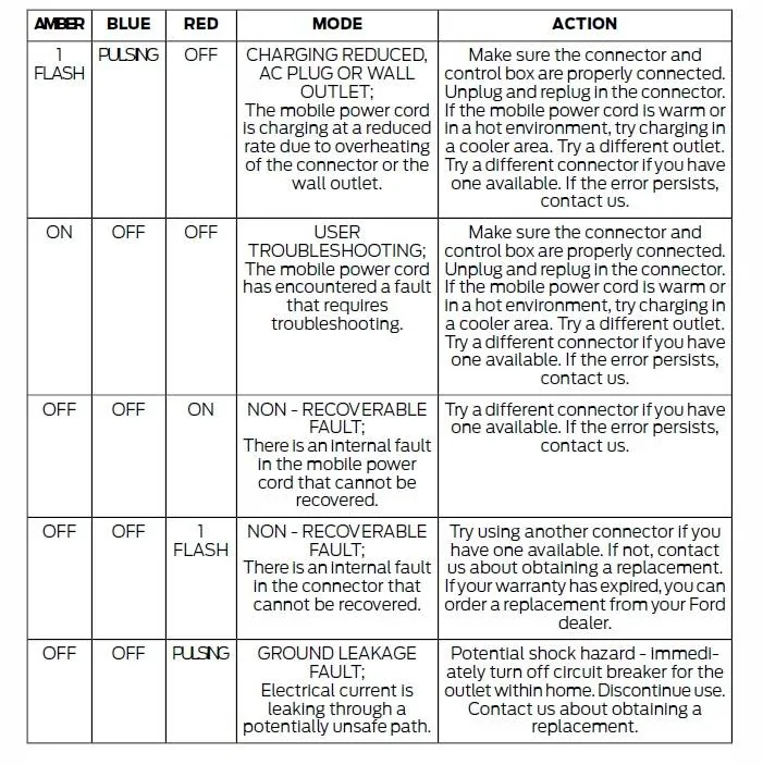

Anyway, the error light table is:
Ford F-150 Lightning Home Charging with the Ford Mobile Charger has slowed down ~3kw error codes 1
Ford F-150 Lightning Home Charging with the Ford Mobile Charger has slowed down ~3kw error codes 2
Ford F-150 Lightning Home Charging with the Ford Mobile Charger has slowed down ~3kw error codes 3
There have been literal melt-downs of these devices (with smoke) according to some reports.
Sometimes it may have been because the dongle (240V or 120V) was not seated all the way into the case - or the contacts got corroded perhaps creating a hot spot.
Note on the 3rd table/image it mentions trying charging in a "cooler area" so heat is a factor when it charges more slowly.
