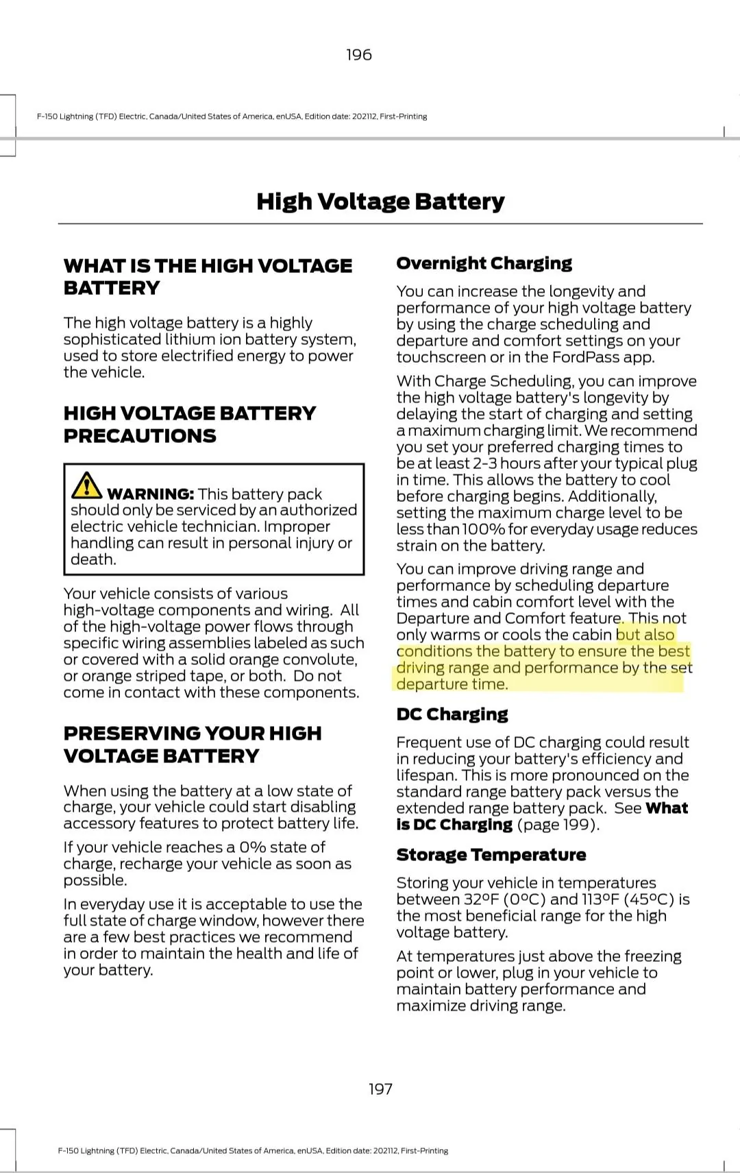

I'm not entirely convinced that the meaning of "preconditioning" as used by Ford really has anything to do with the battery state of readiness.
Ford F-150 Lightning Confirmed:  Preconditioning matters Screenshot_20221027-091151_Acrobat for Samsung

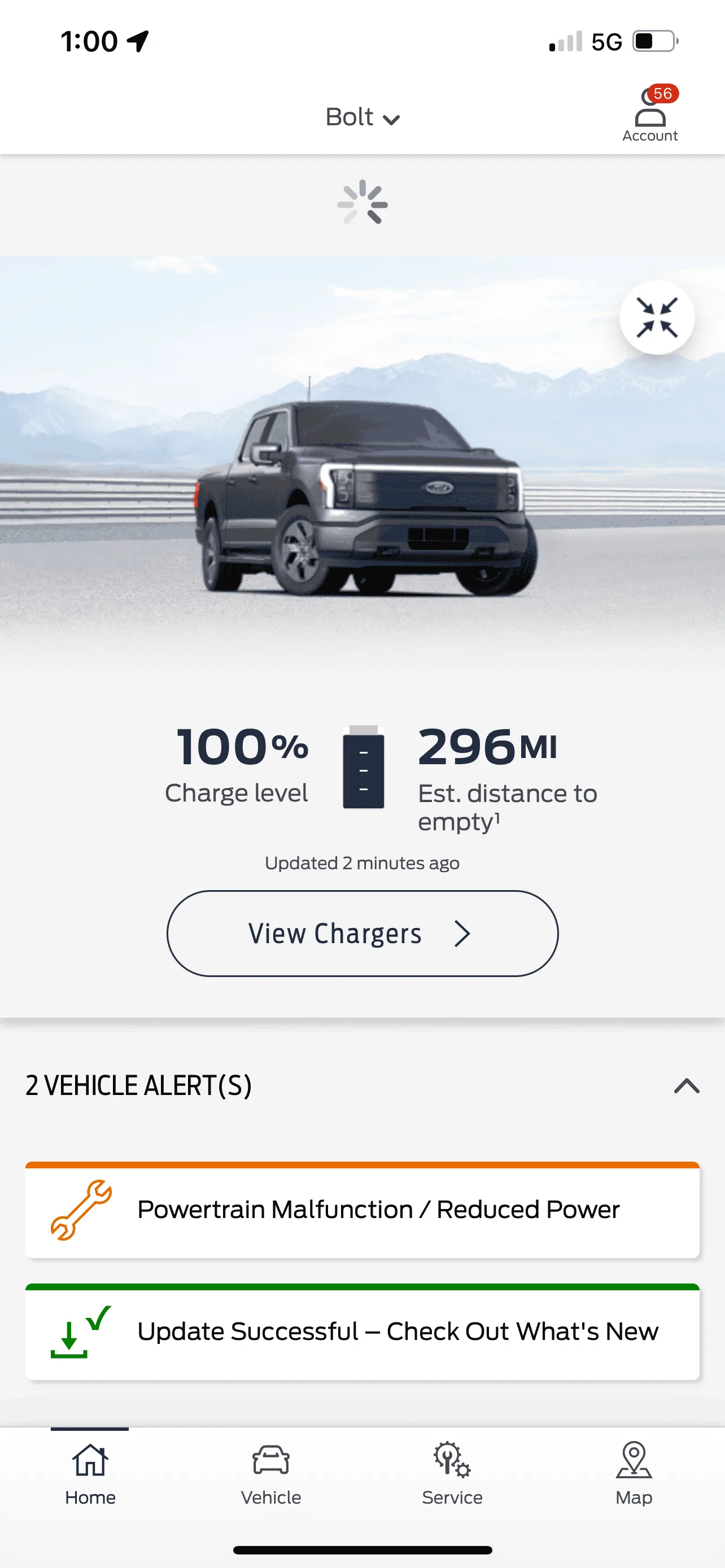

I preconditioned for the first time two mornings ago before heading 126 miles to my office and it worked well from the app. Also driving around locally brought my guessometer up to almost to 300 miles. I will definitely be preconditioning when I remember.
Ford F-150 Lightning Confirmed:  Preconditioning matters 187639C7-8010-4CAD-A526-2DDFEF29FBBC

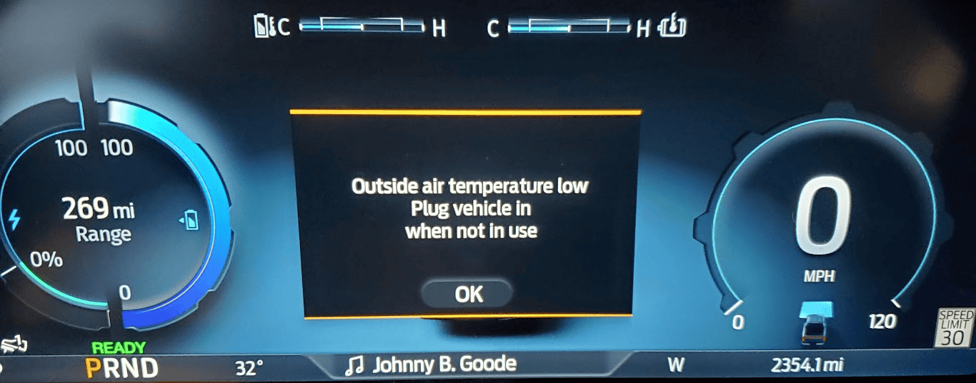

I was greeted with this warning after returning from early breakfast this morning at a chilly 32 degrees at 97% SOC
Ford F-150 Lightning Confirmed:  Preconditioning matters 1667136484416
I planned to plug in anyway, I want a 100% SOC upon leaving for the NY/NE meetup later this morning. Welcome to Fall & Winter mode of operation!!

Actually, Ford doesn't use the term "preconditioning", as noted in the manual excerpt. However, remote starting does not condition the battery like departure time does.
Setting a departure time can start systems running over an hour ahead of time - last year my Mach-E ran for 1:18 prior to departure. Obviously the internal warming is only 10 or 15 minutes, so the amount prior to that is warming the battery.
