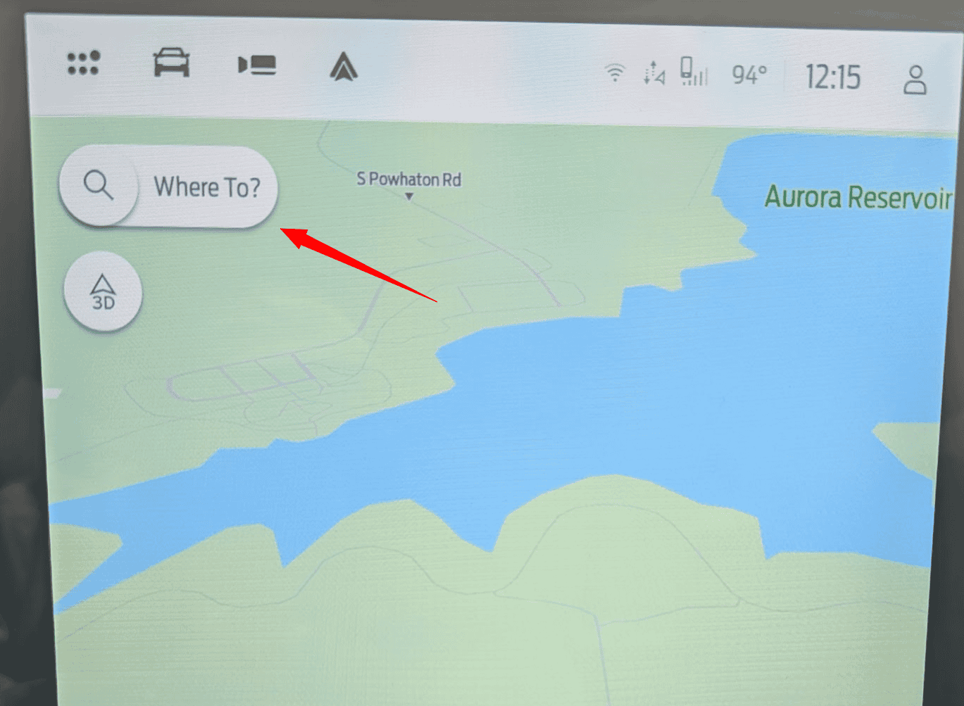

Ok, maybe you can try an experiment. This is what the normal Nav screen in my '24 Lariat looks like with Connected Navigation enabled:
Ford F-150 Lightning Connected Sync 4 Navigation monthly cost? [2024+] 1723746075604-b9

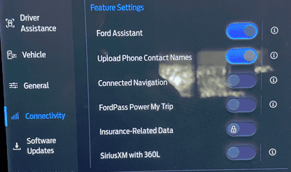

If I go into settings and disable Connected Navigation, I get this warning:
Ford F-150 Lightning Connected Sync 4 Navigation monthly cost? [2024+] 1723746143744-5
Then if I go back to the nav screen:
Ford F-150 Lightning Connected Sync 4 Navigation monthly cost? [2024+] 1723746199409-er
No way to enter an address and if I use the voice command to navigate to a destination it says "Navgation system unavailable". It is nothing but a location map.
This is the exact behavior of my vehicle when I was taking delivery and the Trial was not activated. Of note, the setting for Connected Navigation was on in the settings, but without the active subscription from Ford, it acted like it was disabled.

But it sure seems to. I turned off Connected Navigation in settings and I lose navigation completely.

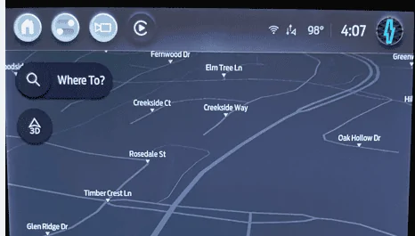

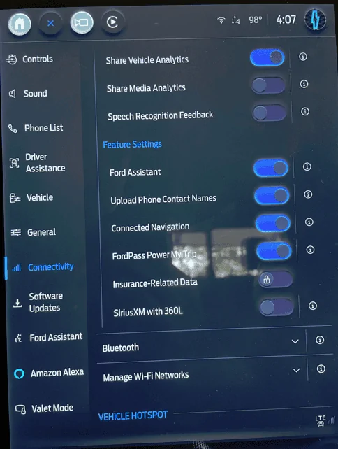

I'm going to agree with you. On my 2022 Lariat ER I am seeing completely different screens than you. Incredible that Ford would do this.
When I click Settings .. Connectivity I see this:

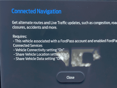

If I click the "i" icon next to Connected Navigation, I get this:
Ford F-150 Lightning Connected Sync 4 Navigation monthly cost? [2024+] 1723756549665-1f

I click Continue and the slider is in the off position:
Ford F-150 Lightning Connected Sync 4 Navigation monthly cost? [2024+] 1723756668440-f8
But I can still search on the main screen:
Ford F-150 Lightning Connected Sync 4 Navigation monthly cost? [2024+] 1723756705260-bu

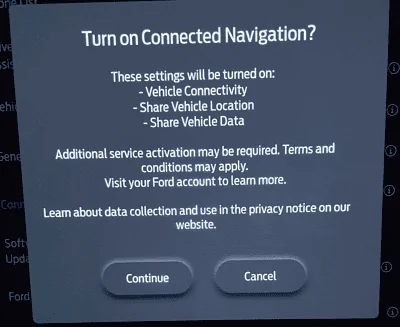

When I turn Connected Navigation back on, I get this message:
Ford F-150 Lightning Connected Sync 4 Navigation monthly cost? [2024+] 1723756973751-c1
To close the loop make sure you have the other things checked that are required. I.e., that you have also turned on Vehicle Connectivity, Share Vehicle Location, and Share Vehicle Data. Some people have been turning those off for privacy reasons.

...and there it is.
Thank you for testing this. Ford is NOT lying about completely disabling navigation if you do not continue to subscribe and pay for Connected Navigation on 2024 Lariats (and I'm sure Flash and XLTs) after the trial. Is there anyone out there with a 2024 Platinum that can check this?
