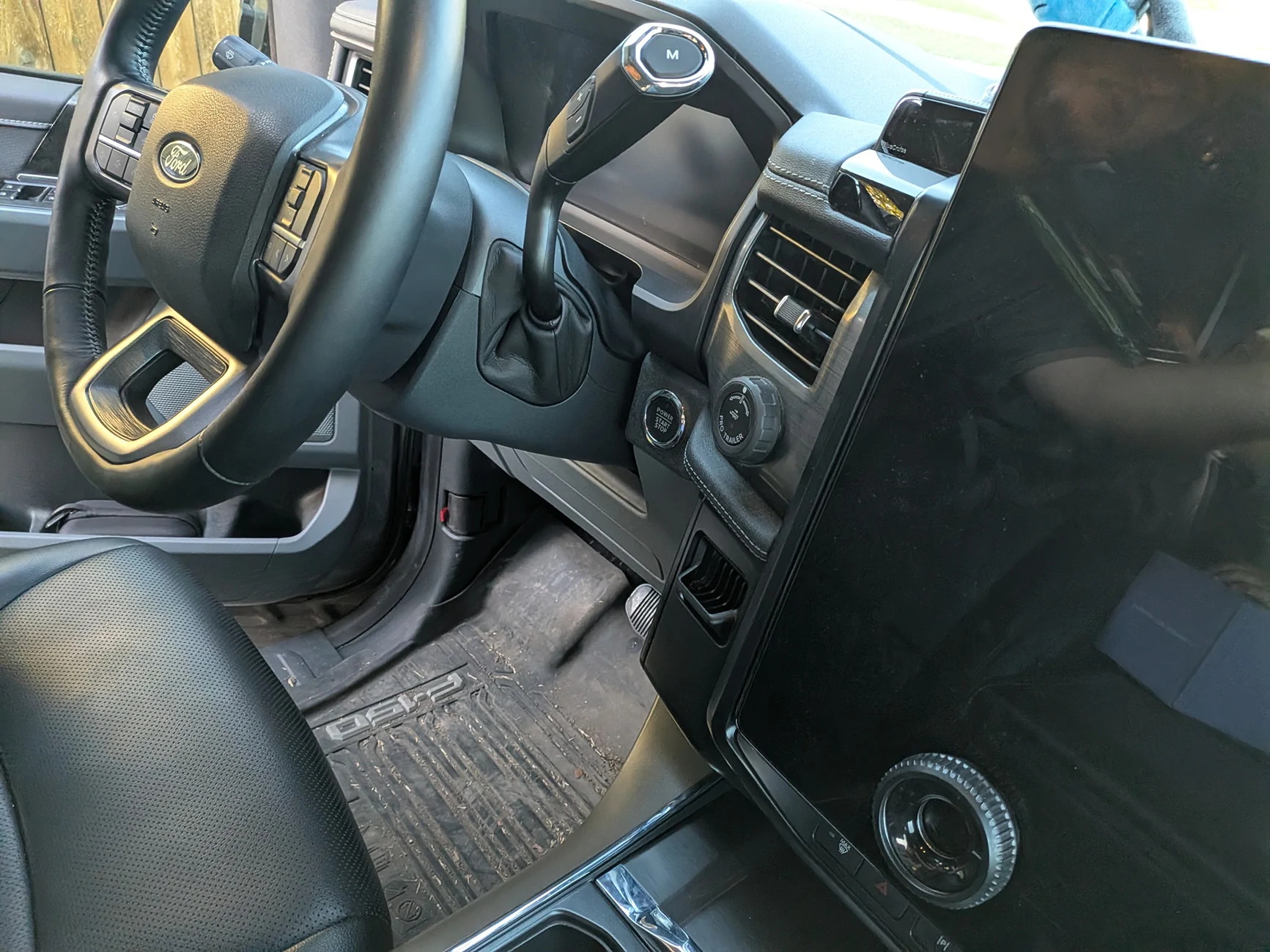

Ford F-150 Lightning Infotainment Column Shifter Conversion PXL_20251115_213924080
Got the correct shifter and it works like a dream. Drove it all weekend to make sure I had no issues and none appeared on the dash. No codes on forscan either so its working like the stock shifter. I did wrap the shifter in leather to cover the unused buttons (though it kind of looks like it just has thick electrical tape on it, may change this down the line).

Awesome. Glad they got the shifter out to you. Later we will have a genie max that will make use of those buttons. Possibly map them out to whatever you want.. IE Tow mode..
Glad its sorted out.. Thank you for posting
That looks really good!
