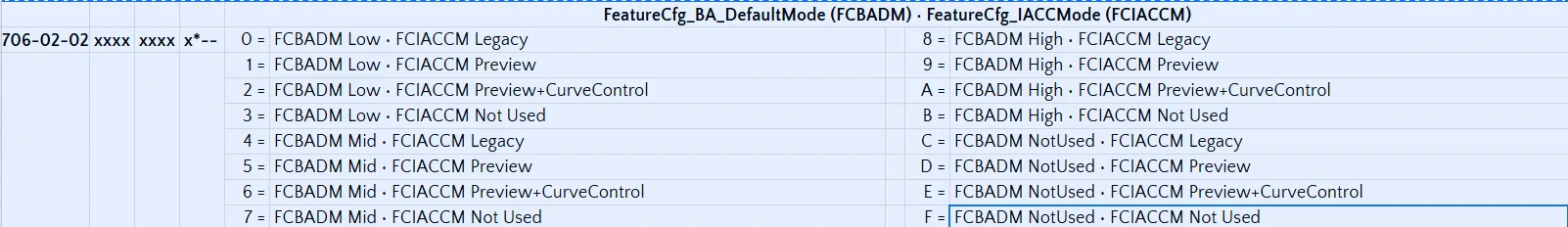

I agree. I turned it completely off with FORScan.

From the previous page. Subtract 1 from what you have and that disables curve control. Guessing we all have 2 as part of BC1.4
Correct, but it would go from 2 to zero which is what we there before BC 1.4. A one would leave the preview enabled.....not sure what that would do, tbh.

yeah above my paygrade. 1 was what I used previously since I figured that was the closest thing to 1.4 value.

So I pulled up forscan. got the extended capability key. But in no way can I find anything with the words FCBADM, or FCIACCM, or 706-02- or IACCMode. nor can I see any way to change any value. I will continue reading. Maybe I will learn other new things, but this one is not looking good so far. Any other suggestions? Thanks.

I'm guessing you're on easy mode that lets you double click and change the values? You want the one that says IPMA as-built or something like that. That should give you the screen with the 706 values and let you change the hex codes. @Aminorjourney has a good view on youtube.

ok thanks, what was 0244 has been changed to 0044, but then after changing it went to 0042 I guess the last digit is related to an automatic generated checksum - maybe. Will test it tomorrow. Thanks again.

yeah. The last two are the checksum which is why the spreadsheet has -- for those digits.
