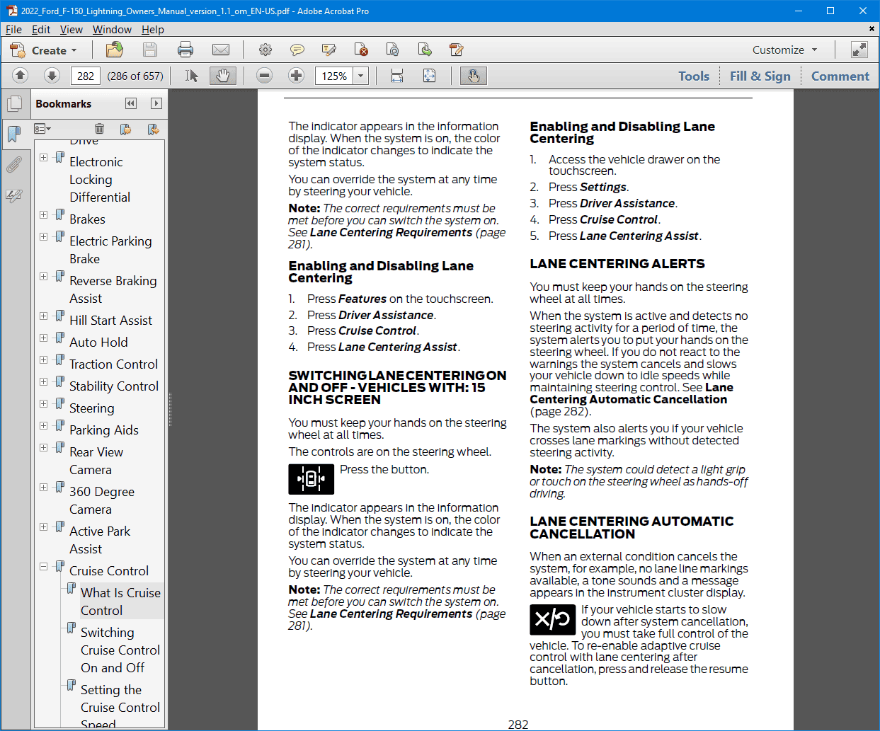

So I'm guessing you've already tried this?
Ford F-150 Lightning Cruise on Button Now Invokes Lane Centering Lane_Centeri
Thank you/yes I tried all that + the onscreen tips - the work around now for me is to keep the cruise button on - used to be able to thumb it off as a way to slow down & then on to reengage without the pesky land centering coming on - so now I just leave the cruise button on all the time and brake then toggle the "set" arrow up to take the speed back up - bypasses the lane centering invoking - must have been a recent OTA changed things - c'est la vie.
