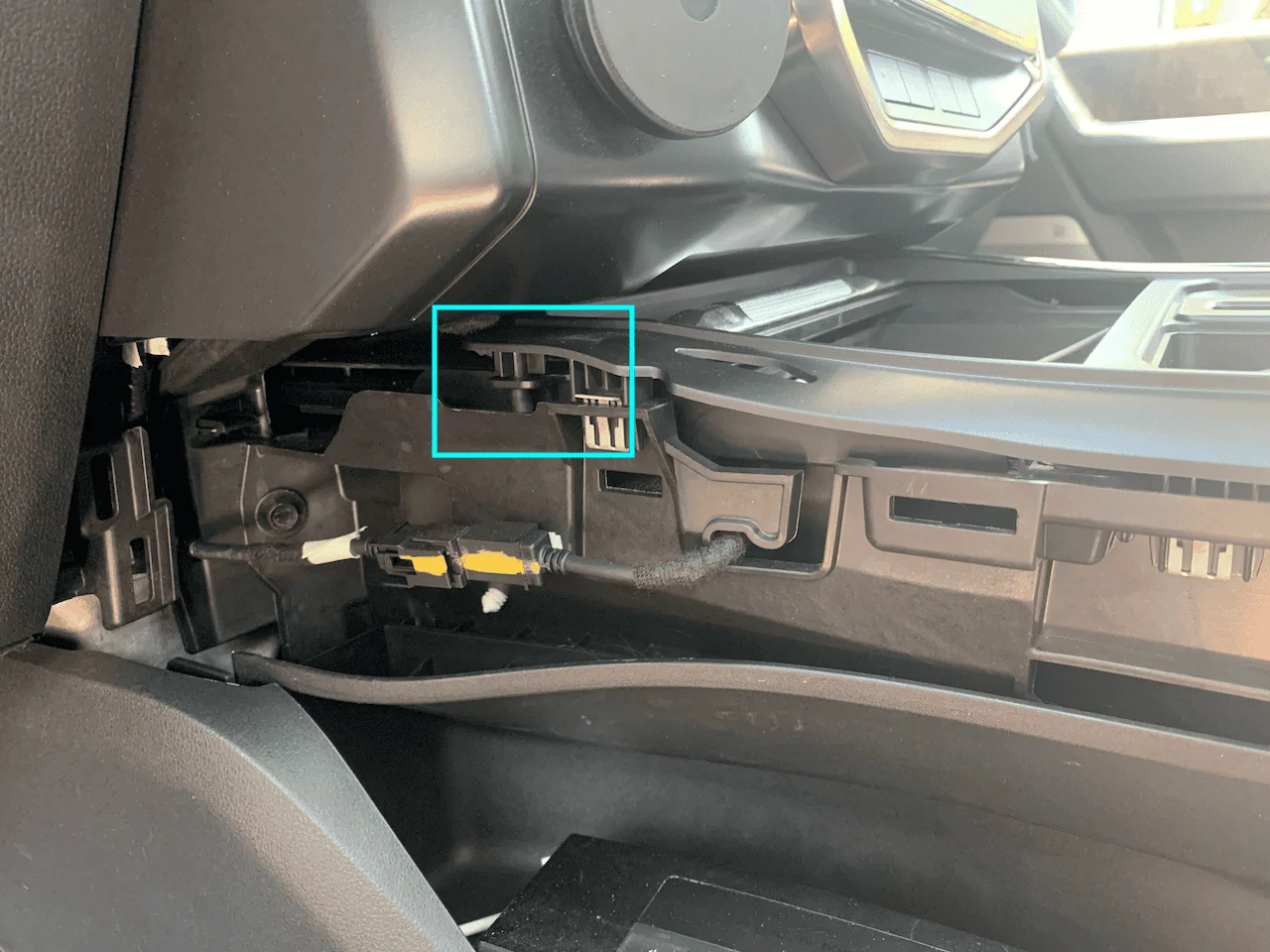

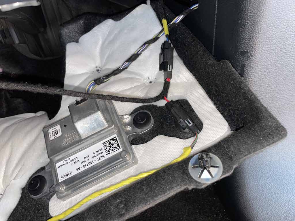

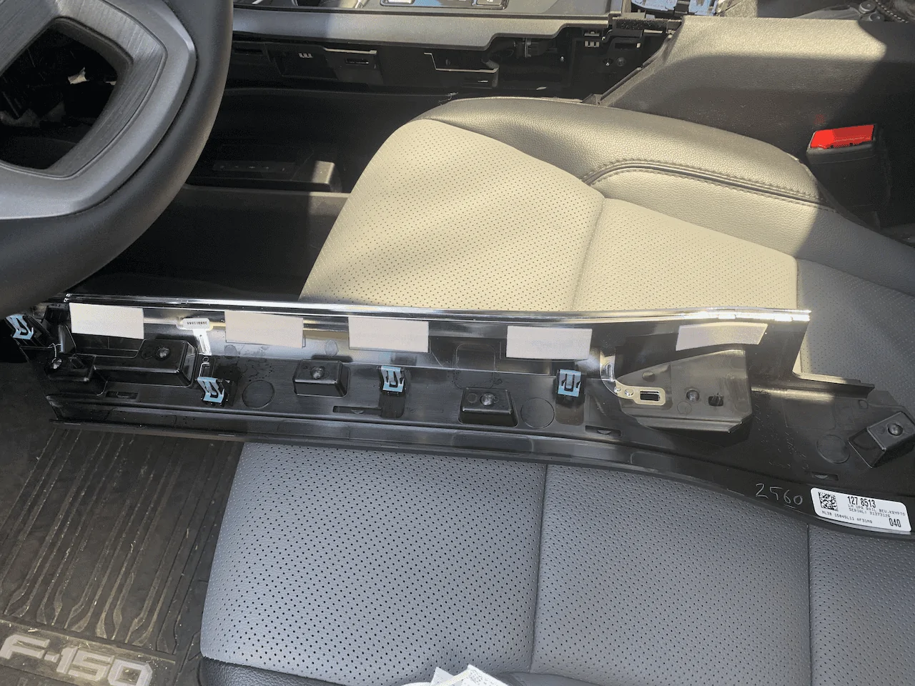

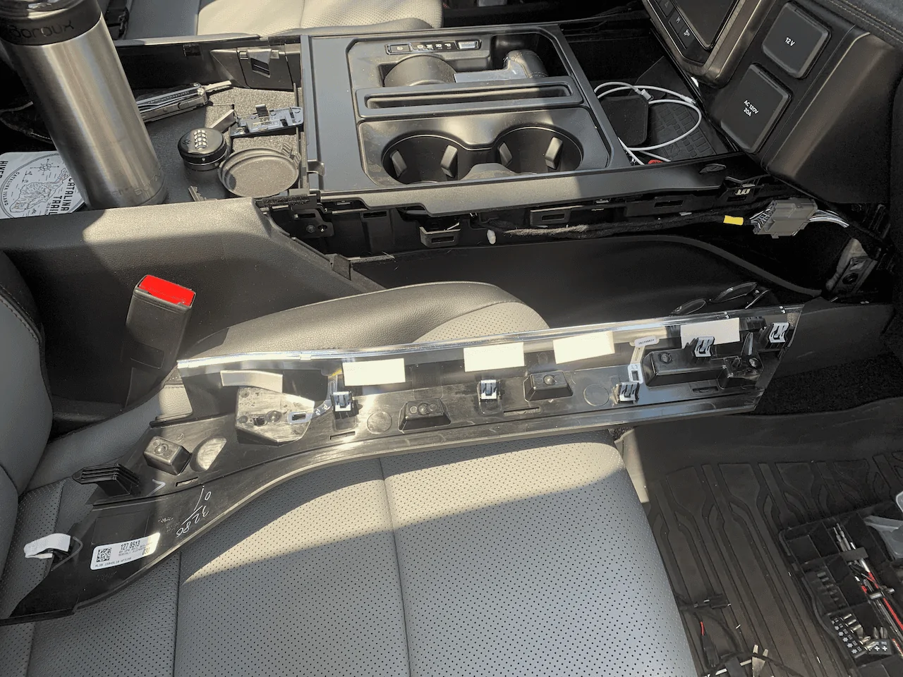

Yes. You don't need to dissemble the dash. It's much easier to work on than my 2011.
I did not really document it, but here's some pics in case it helps.
Ford F-150 Lightning Cup holder light installation/media bin light/glove box light IMG_5260
Ford F-150 Lightning Cup holder light installation/media bin light/glove box light IMG_5261
This was the hardest part, getting this tab to release (without disassembling the dash?)
Ford F-150 Lightning Cup holder light installation/media bin light/glove box light IMG_5262
I'll try to be more thorough when doing media bin. My brain usually isn't disciplined enough to stop and document it.

Do you have to remove any screws to get the side and top panels off or are they all retention clip fasteners?
Also, in your third photo do you need just need to lift the front edge of the panel up enough to clear the retention pin or is there another trick?

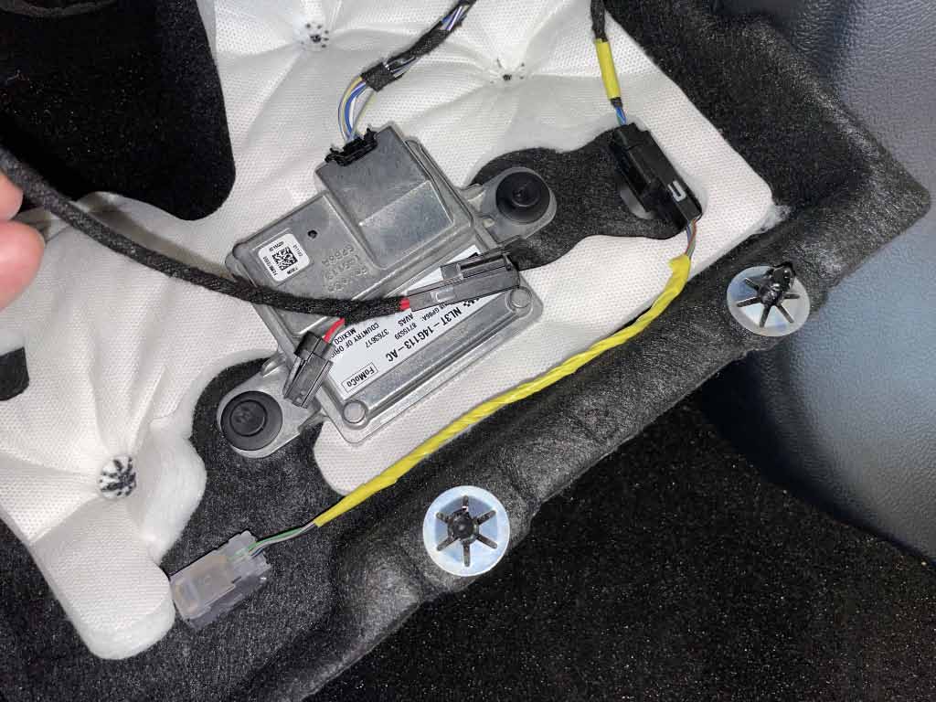

I got my cupholder installed yesterday using the new wire harness, as well as the media and glove box light. This is very straight forward but was a bit nervous as not every step seems to have been documented.
I'll say after doing it, for the most part it is intuition, just take your time.
Some recap - this is much easier on the Lightning than the ICE. Keep in mind - I did both harnesses, the cupholder and 2 lights. Not all may apply if you only do one or the other.
For trim - it is only 3 pieces - the long piece on each side of the console (post 111 by @Avocadodude ) and the top of the console. The top part comes straight up - a total of 8 clips.
For the side pieces, start at the back and pull out, then work your way toward the dash. Lay them out of the way.
The top part has two posts (detailed well up in post 111 by @Avocadodude ) and those were a pain, but keep the console top laying flat and you can work them out.
Both wiring harnesses run perfectly down the passenger side of the console following one already in place.
Here are a couple more pics I'm not sure I've seen posted, so use as reference as you wish.

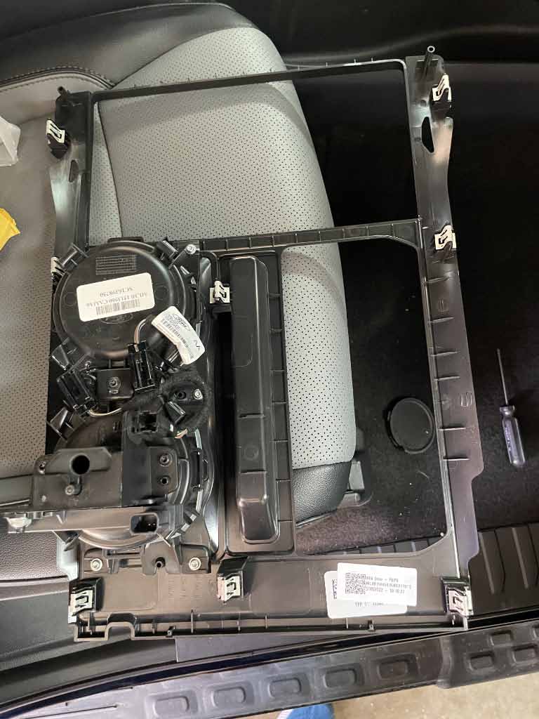

Console trim from around cupholders upside down, no screws to remove all push tabs. Also shows 6 T20 torx screws to replace the cupholder itself.
Ford F-150 Lightning Cup holder light installation/media bin light/glove box light IMG_2097

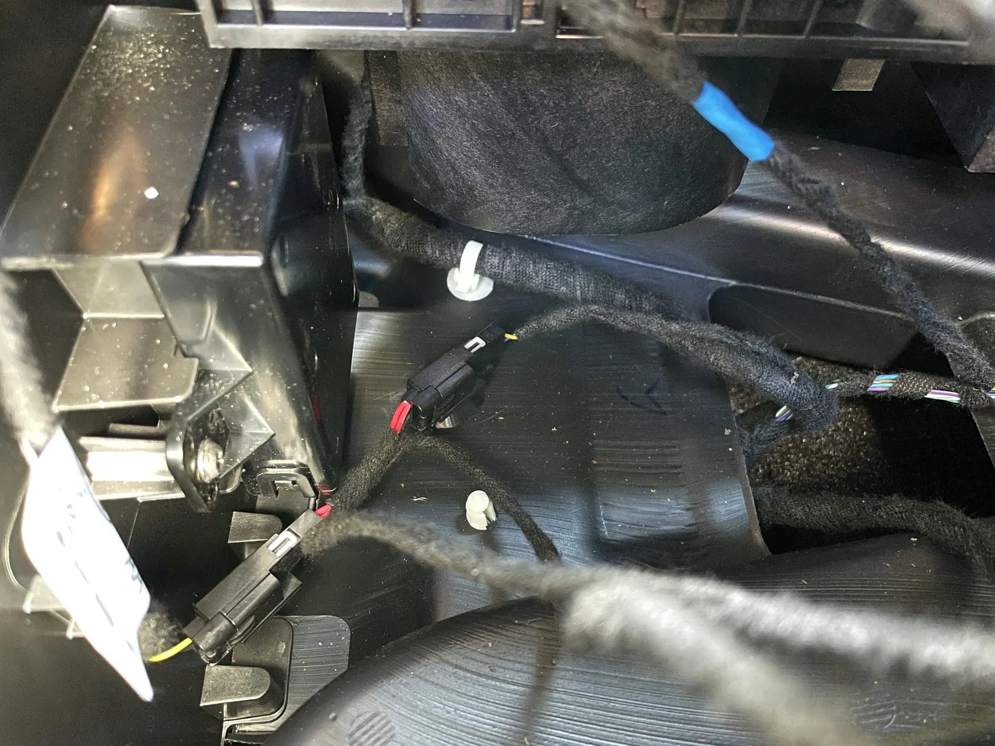

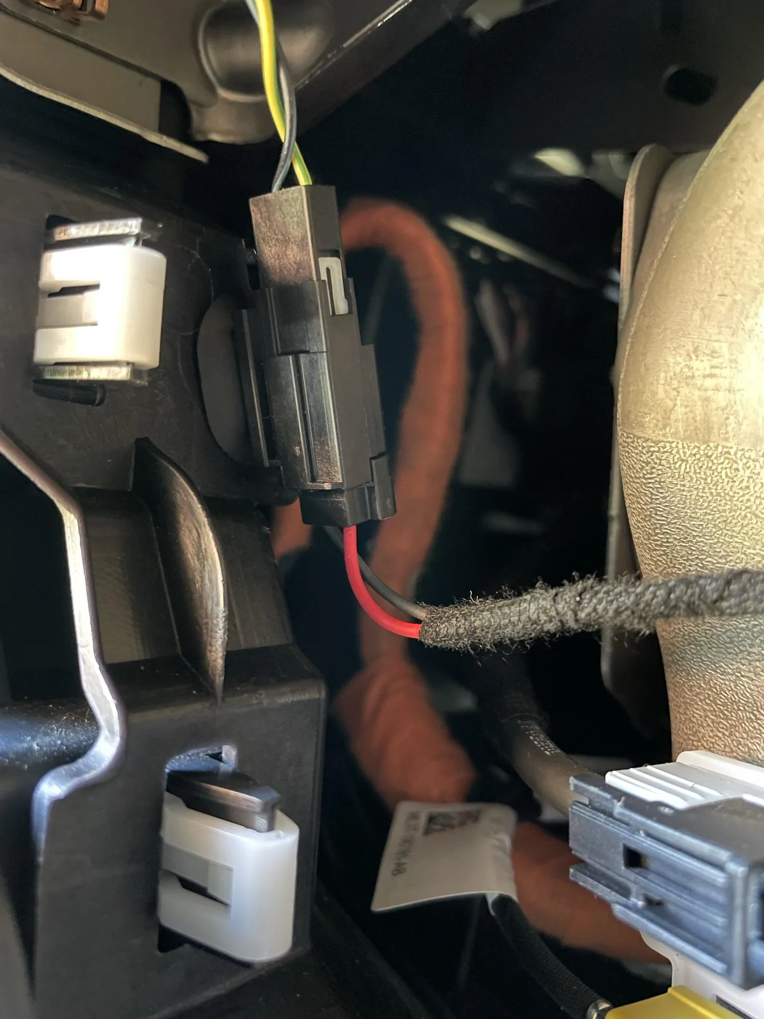

Under dash / foot well ambient light where you'll tap into for the cup holder wiring harness.
Before adding harness:
Ford F-150 Lightning Cup holder light installation/media bin light/glove box light IMG_2111
After adding harness:
Ford F-150 Lightning Cup holder light installation/media bin light/glove box light IMG_2112
I took a few more pictures, I'll look through them again to see if there is additional that might help fill in some of the gaps.
No screws. The front pins are a little challenging, patience and gentle pressure, finally got it lose.

Adding a couple more pictures. For the glove box and media bin the power is coming from the plug on the the center console (Thank you @JHForman812 , I forgot there was a light in there because I have a console vault. ??‍♂) Picture with adapter.
Ford F-150 Lightning Cup holder light installation/media bin light/glove box light F2DD982A-EDC4-4BB5-B761-C64199CE1967
Also the hole for the glove box light retaining clip is a little hidden. Picture with clip in place.
Ford F-150 Lightning Cup holder light installation/media bin light/glove box light E62A6F9A-001E-4D40-96E6-FA84D127E220
Use the existing clip to guide you.
Hope this helps.
