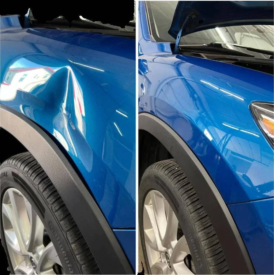

good example of what’s possible.
Damage creases removed, factory crease retained. Simply comes down to whether the underlying paint is damaged .
Pure wizardry!
