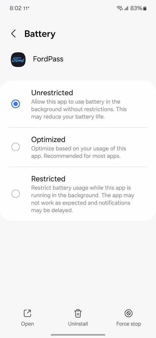

Also make sure Fordpass stays open and not force closed. The Departure times wont work if Fordpass is closed in the background.
The only other thing I have updated my truck fully. You may have several updates available even as a 24. Mine had 14 or so updates when I got it.
The first point above may be at least part of my issue. I am a battery longevity FREAK with my phone so I always close all apps every time I use the phone. I just checked and when you close Fordpass (not just go "home" but actually close it) the app is DEAD. There is no android service started for the app that can be cached by the OS it just dies.
Bad app design from some crappy "programmers", I've fixed a lot of code like this over the years.
I will leave the app "open" on my phone this afternoon and test, my next departure is 5:45PM today.
I have also updated my truck fully with a Mongoose and FDRS. Also got 2 OTA updates, one before and one after.
This is probably antithetic to your very being but I've been doing it as long as I can remember without consequence.
Ha, thanks. I did try that yesterday before my 5:45 departure time and even left it running in the background. Still didn't work.
I like this truck but I'm pretty much done wasting more time on crappy software that I have no access to. I've just been "remote starting" (which is a whole other pain point for me) it to get the cabin warm. I also have a 17 450 that is the best truck I've ever owned but it too has crappy software, and on that truck I just shut it all off and never looked back. I might just spend the $$$ on a start-x to see if it works on plug to remote start and abandon Fordpass once again.
I've been a software engineer for over 30 years now and am not an open source zealot but JHC if you can't get the job done with your "team" Ford, give us the source so we can fix your crap.
