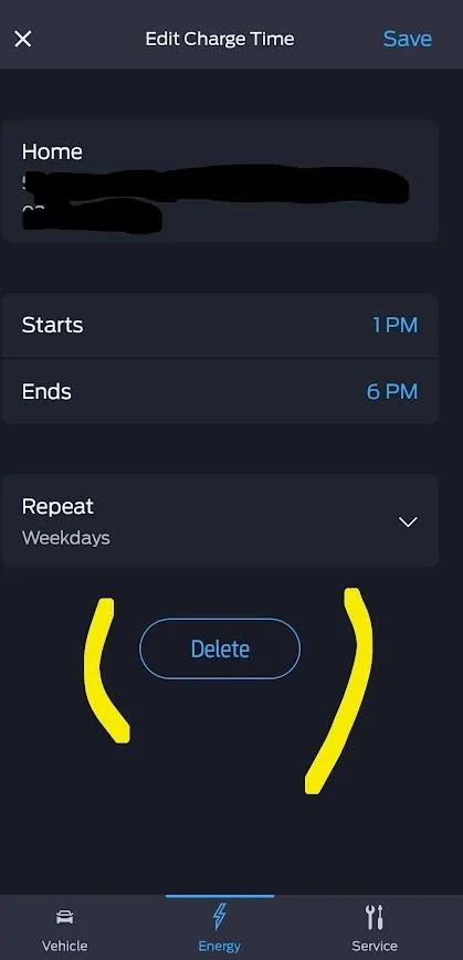

Just discovered another fluke, but it's fixable, by using the DELETE button while editing the scheme. It will take extra time to SAVE to the cloud, and you will need to back up two menu levels to see the changes posted when you go back to the details screen.
In the truck SYNC screen we have a DELETE [time frames} button this is effectively the same and restores the ANYTIME condition

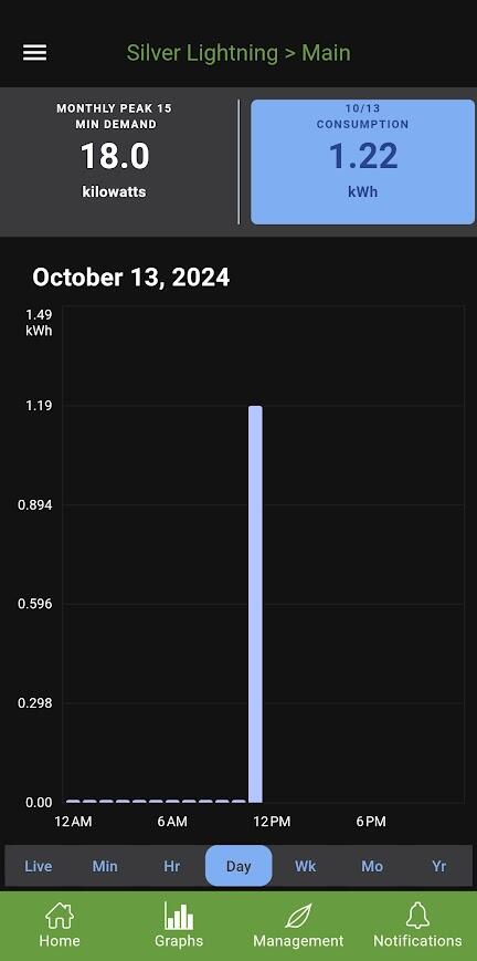

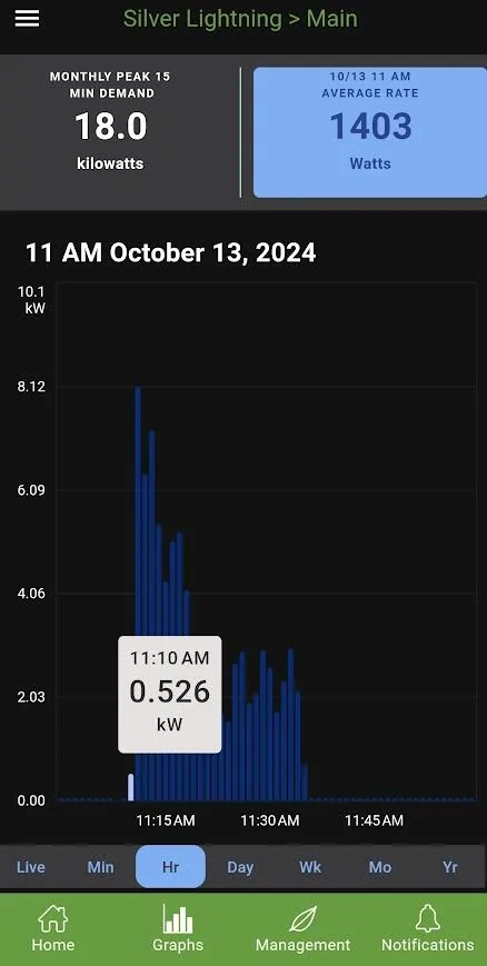

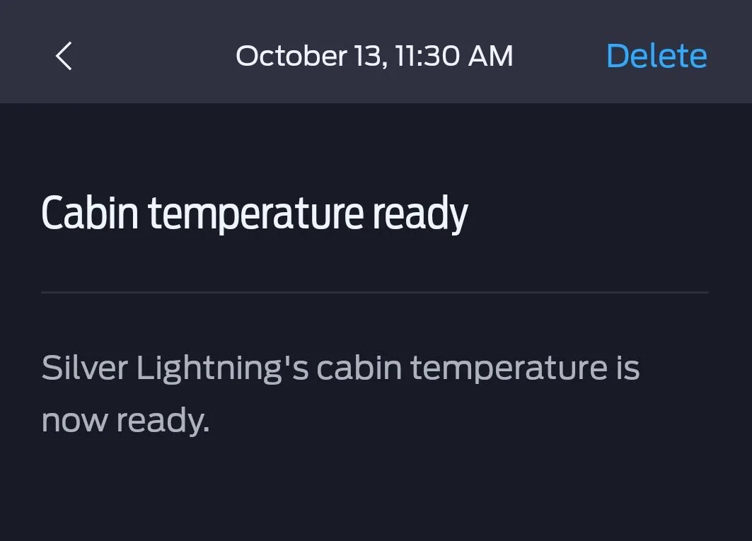

Interesting observation for cool fall weather conditions, I was preparing of a road trip north, into chilly wet conditions, I knew I'd want comfort in the cabin and wanted a 90% starting SOC for the trip so I plugged in and let the planned departure time prepare the traction battery and cabin as it felt needed.
Leave time was 11:30, warm settings for cabin, outside temps' was mid 50's and damp.
The Lightning decided it would begin preparing the battery first, at 11:10 it switched on the PTC and started drawing current, peaking at 8.12 KW, some of this went to the AC/DC charger to peak up the battery SOC from a non visible fraction under 90% to 90%, then settle around 5KW eventually varying 2 to 3 KW until I went out to the truck, unplugged & started.
Cumulative energy for that 25 minutes was 1.22 kWH, cabin and steering wheel were toasty warm.
Note, normally in milder temps ~60's the cabin prep is all that I've seen happen, it would start 5 minutes prior to designated leave time and run for 10 minutes past leave time (15 minute remote start limiter selected in sync as my standard m/o).
When the temps are much colder, battery preparations can start earlier and draw high current longer before the cabin prep phase begins.
