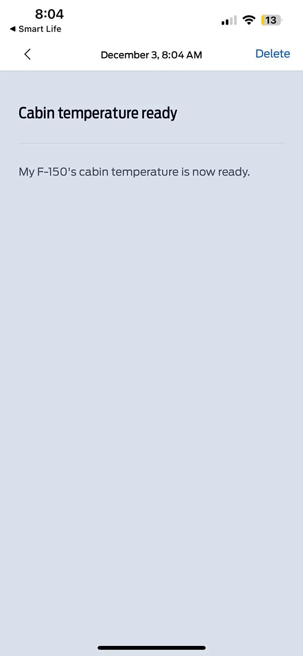

Funny after getting to work and punching in I get this notification

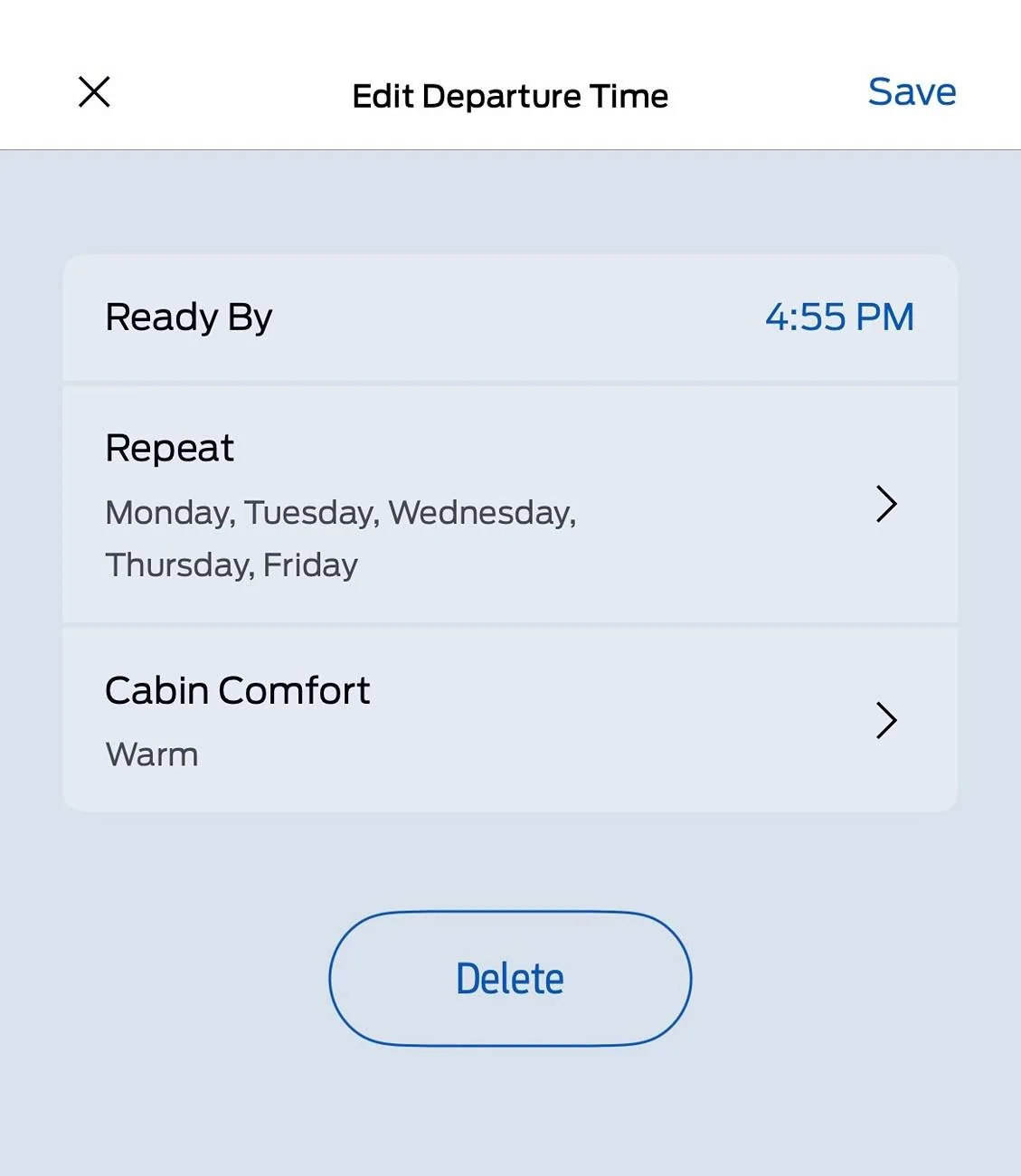

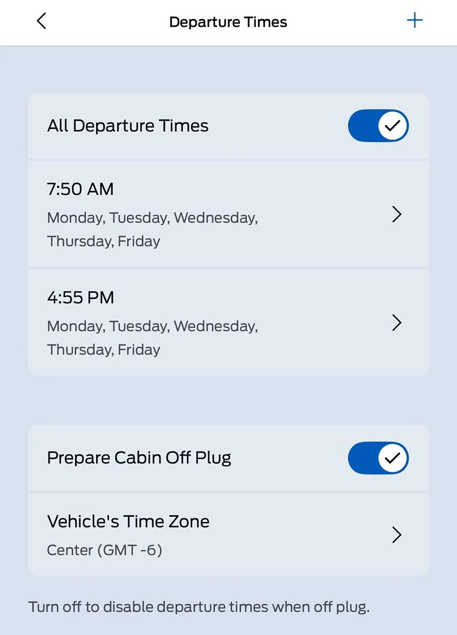

It’s set to run for 15 minutes and these are the settings I’ve had it at for the last few days. I go out to the vehicle five minutes after the departure times since getting it it’s always been lights on and running not anymore.
Ford F-150 Lightning Departures broken IMG_7049
Ford F-150 Lightning Departures broken IMG_7050
240
16,825
19,131
Your settings look fine.
The afternoon event should have started at 4:50 PM
The truck should have been decently warm at 5:00 PM when you went out, and should still be able to run until 5:05 PM if you were late punching out for the day.

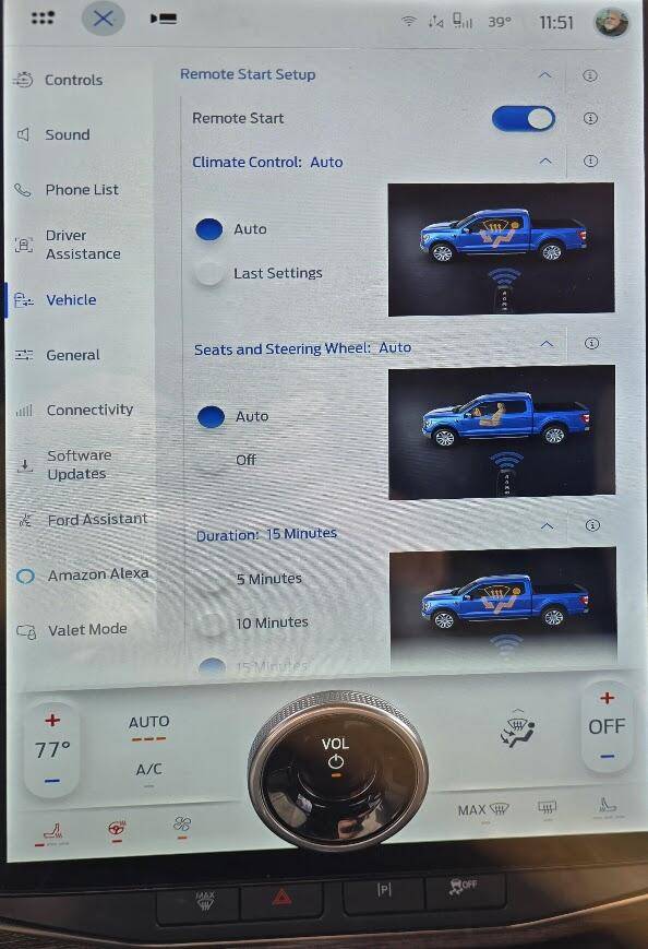

I guess I haven’t found that setting. ?
I thought the truck just kind of decided what to do on its own. Sometimes I go out the rear defrost is on sometimes it’s not. Sometimes steering wheel heat is on sometimes it’s not. Sometimes the seats are on two. Sometimes they’re on three.
240
16,825
19,131
These settings are on the Sync screen Settings, Vehicle, Remote Start Setup, expand the subsettings .

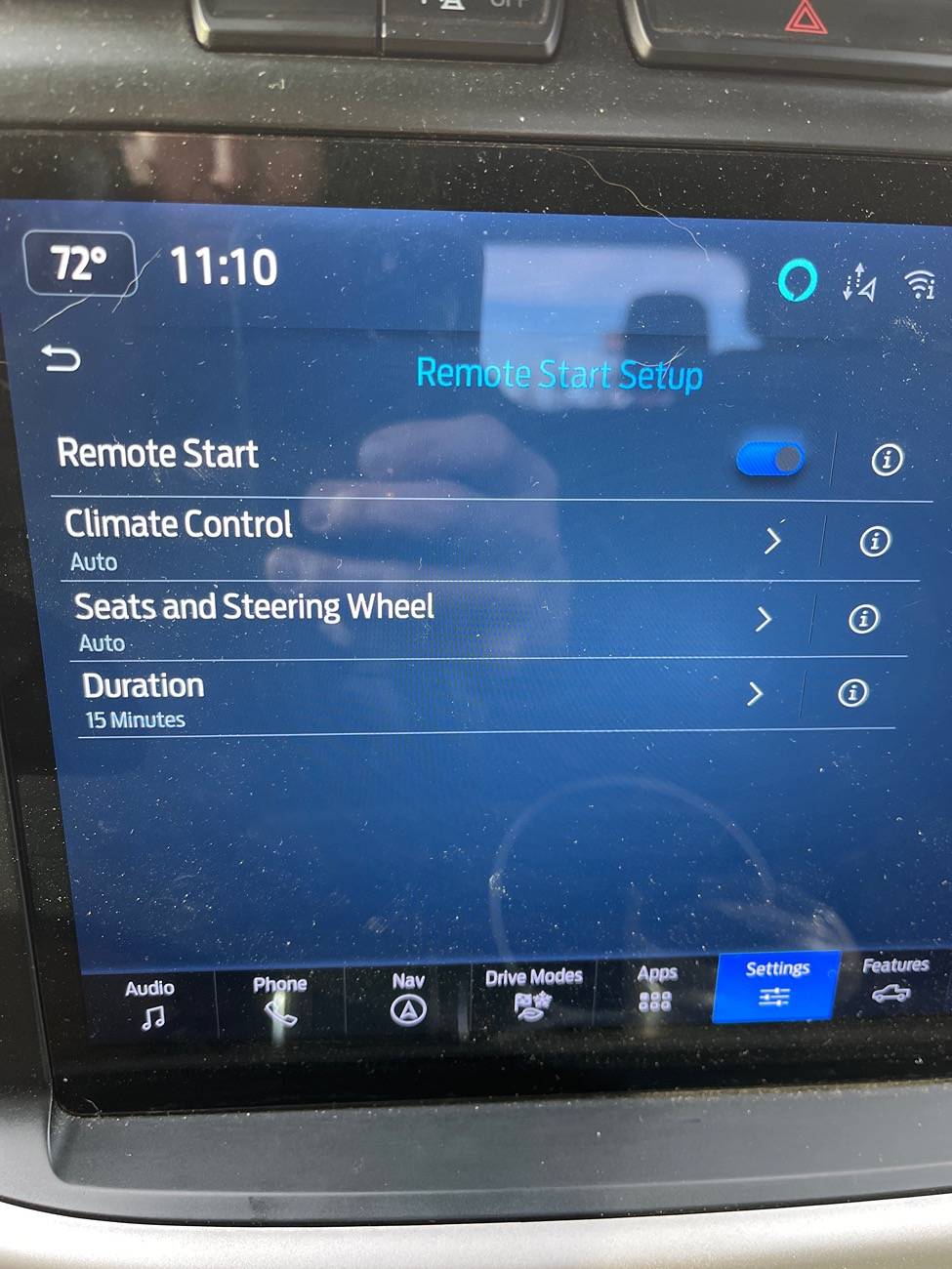

Same as yours, different screen lol. Not a big deal in the grand scheme of things I guess but maybe with the next update it’ll start working again. ?
