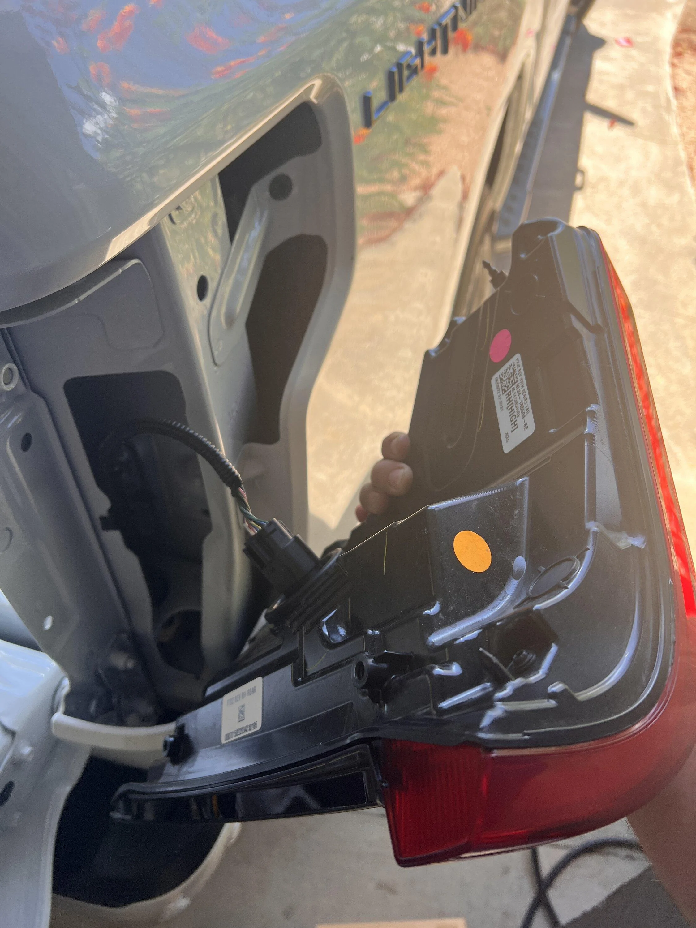

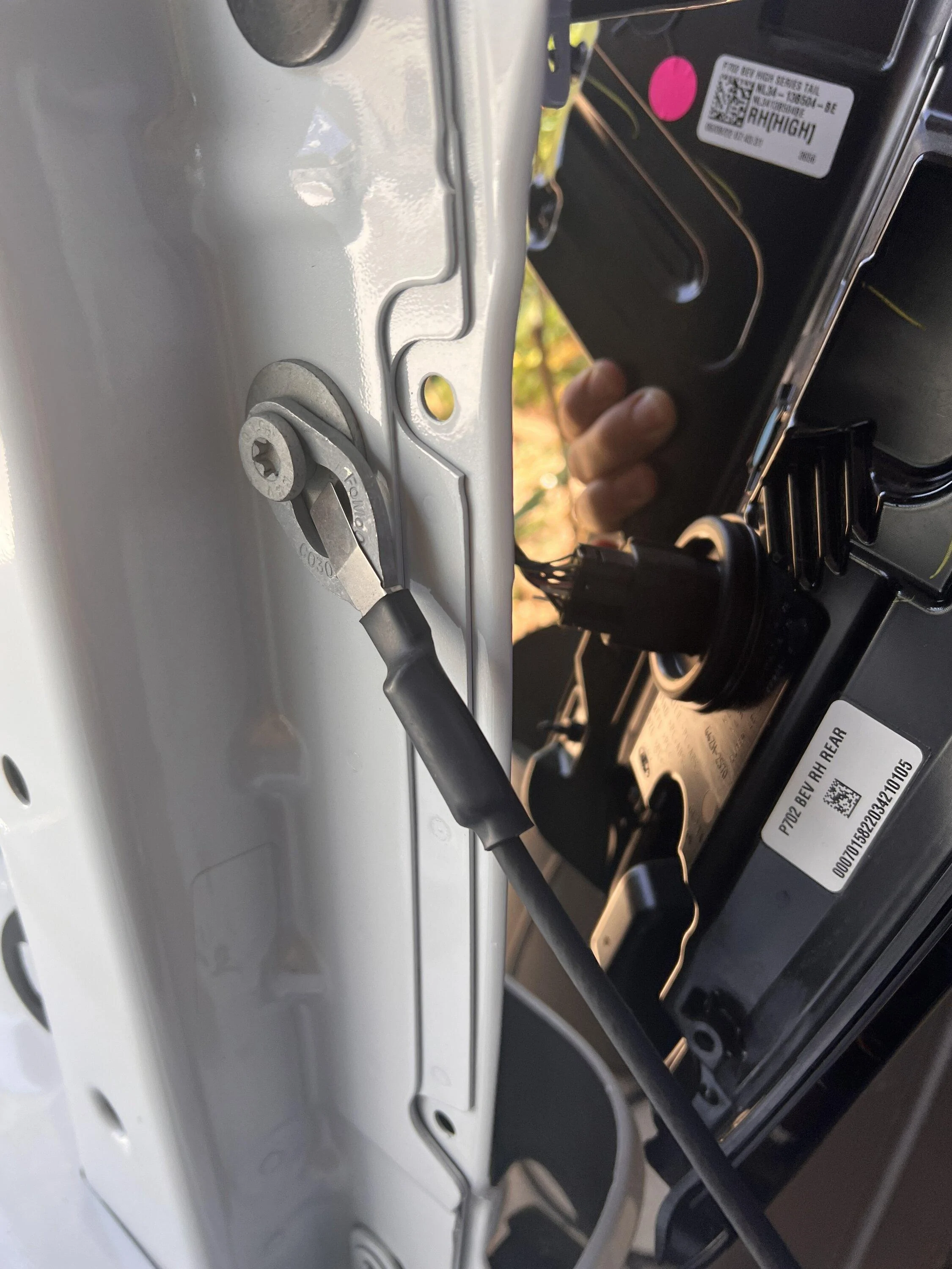

May have missed this covered elsewhere, but:
I came across an old unopened box of high output GTR Lighting 3156 reverse lights, and figured what the hell I’ll see about putting them in the F150L
The first few steps all went as expected and just like my 2018 F150 (couple of hex bolts interior to the tail gate, then a few plastic trim snaps)
Ford F-150 Lightning No upgrading reverse bulbs: taillight housing now single unit 093CF90A-431A-4B69-BECD-571E46BCB3FC
Ford F-150 Lightning No upgrading reverse bulbs: taillight housing now single unit 4A9B713D-76D0-4E8C-8607-8F4B9D043FDA

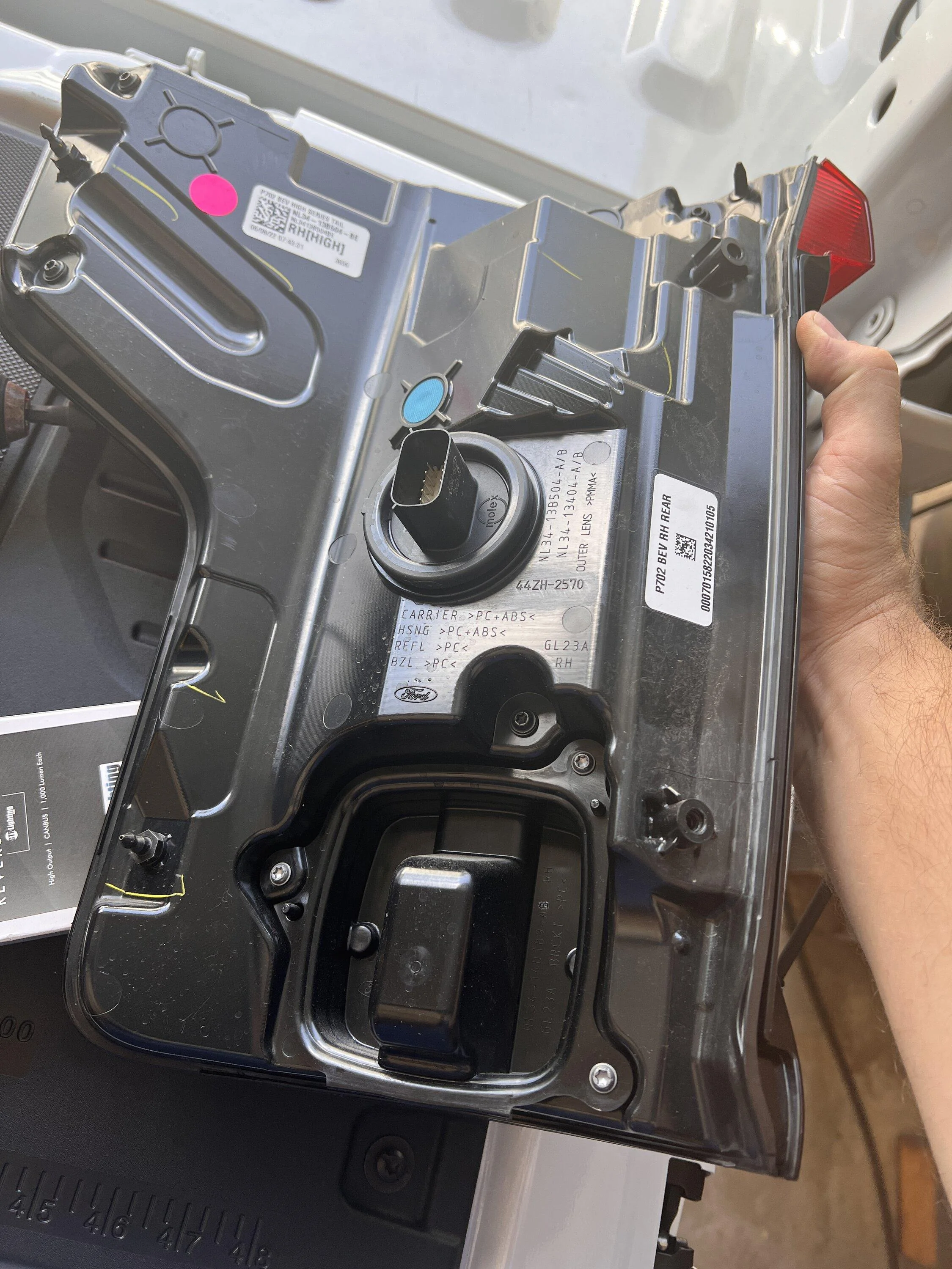

From there, though, it all went pear-shaped
Ford F-150 Lightning No upgrading reverse bulbs: taillight housing now single unit 323513ED-8365-42C0-8A02-36D6360F5D43
Tail lights are a single unit enclosed housing, with no option for replacing single bulbs
And since that bottom housing is past of the bliss system, I didn’t intend to f with it any further

Some LED bulbs are just the same form factor as their incandescent equivalent. Even if they don't, there may be other brighter aftermarket options. The interior lights in a Model S/X are kind of crummy from the factory. Even though they are vehicle specific, there are brighter 3rd party options that easily snap into the original locations. I'll say this was good research. I'm not sure what's behind that bottom compartment with the 3 torx fasteners though.
It’s the bliss-related blind spot sensors.

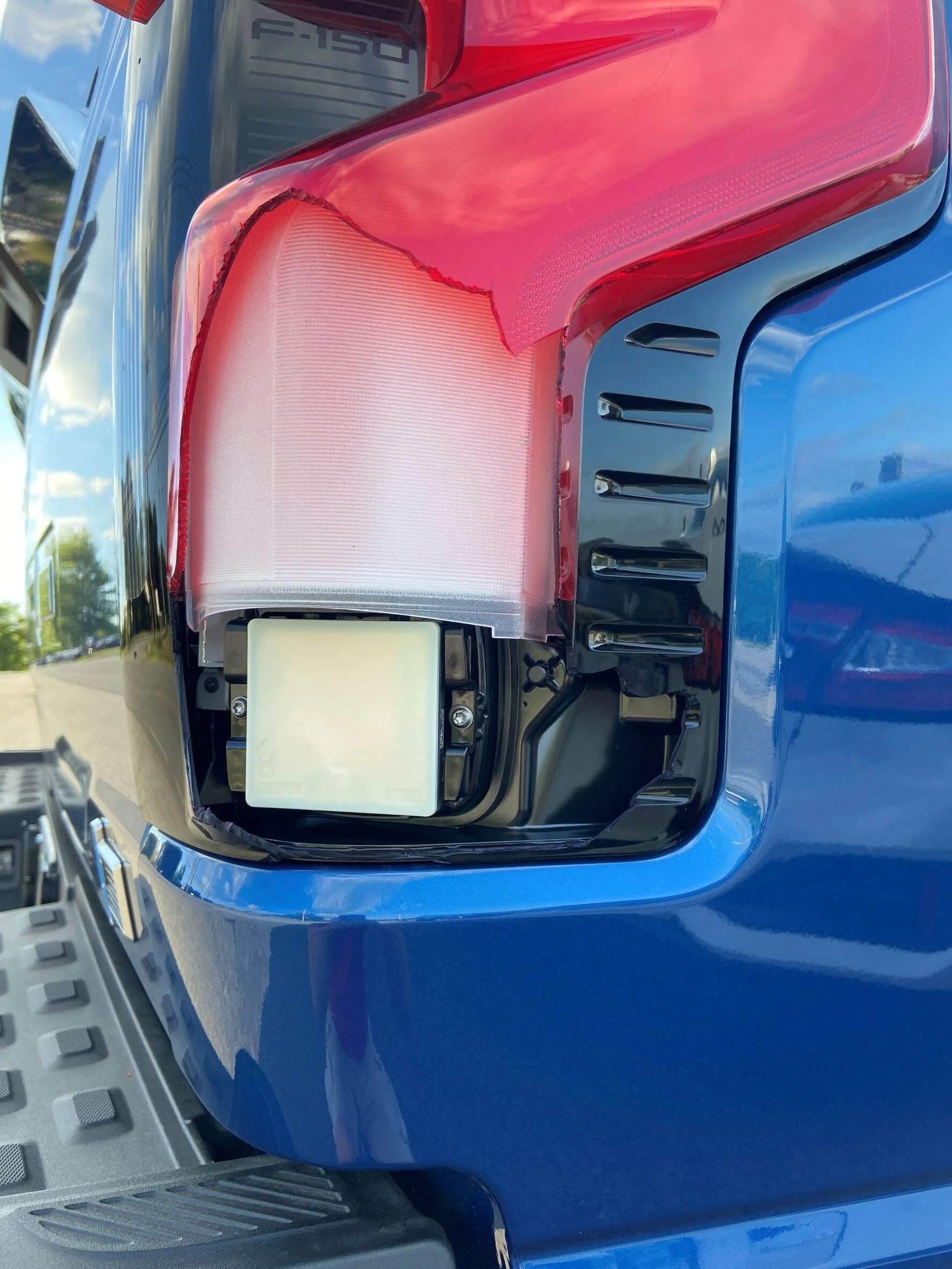

I need to replace my rear passenger tail light.
I thought I could just replace the plastic piece but it's the whole unit. Is it me or the rear lights protrude out so anything that comes into contact it will break it.
https://parts.ford.com/shop/en/us/e...op-and-flasher-lamp-assembly-14618647-1?pdp=y
$1,000 for the whole unit.
Wish there were a *dislike* for this
Sorry to hear it, mate
Not to kick you while you’re down, but if you do get the new assembly would you mind using the old/broken one for some reverse-engineering?
That lower big yellowish square is I believe the BLISS sensor, which from the back side of the tail light assembly appeared to be accessible via those two screws visible in your pic at 3 and 9 o’clock.
I’m not as interested in the BLISS parts (I just assume they run on magic), but it would be interesting to see further up into the LEDs
sorry again for the breakage. A $1,000 tail light assembly is a kick in the d*ck
