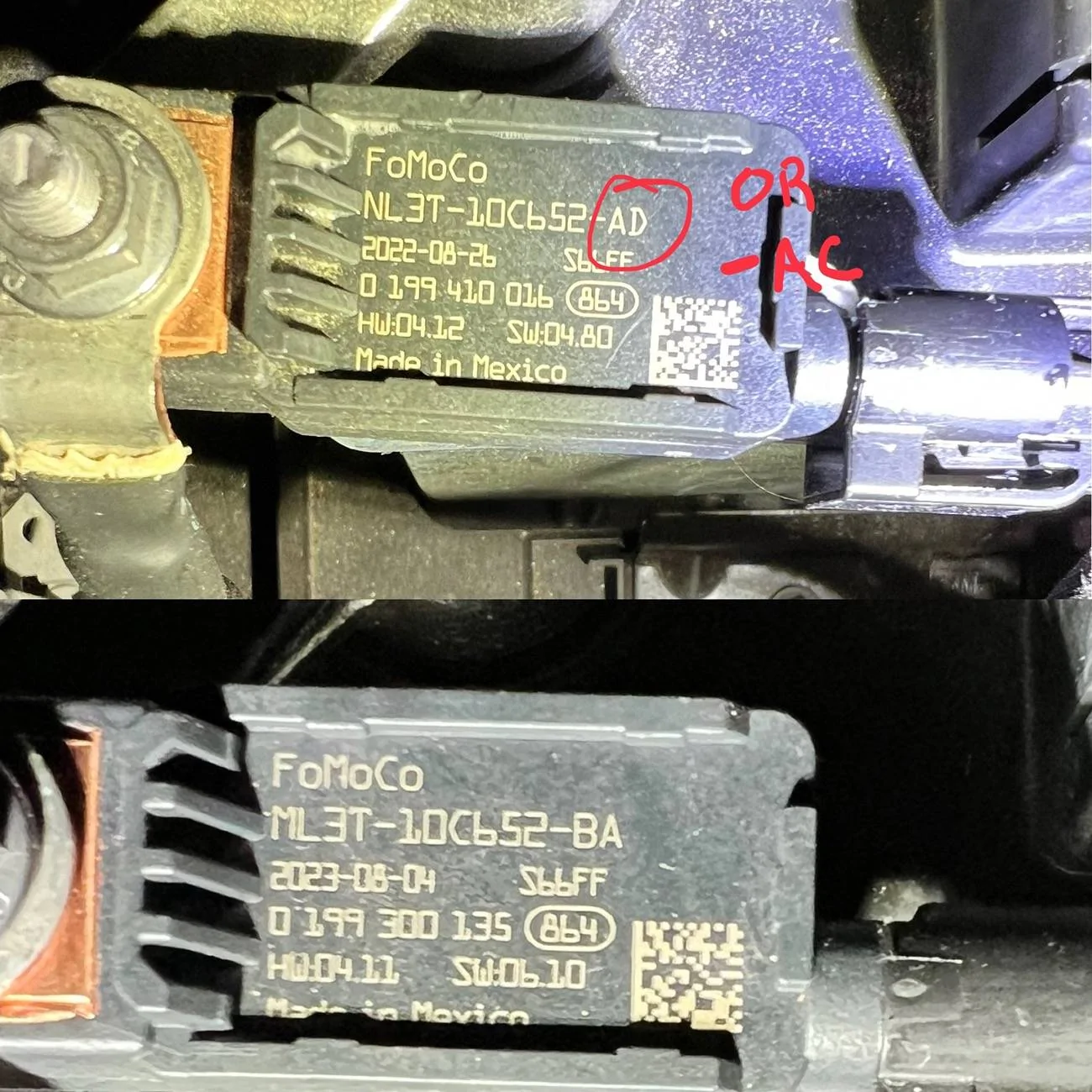

Thanks. BMS module PN ends in BA, so looks like it's already been revised.

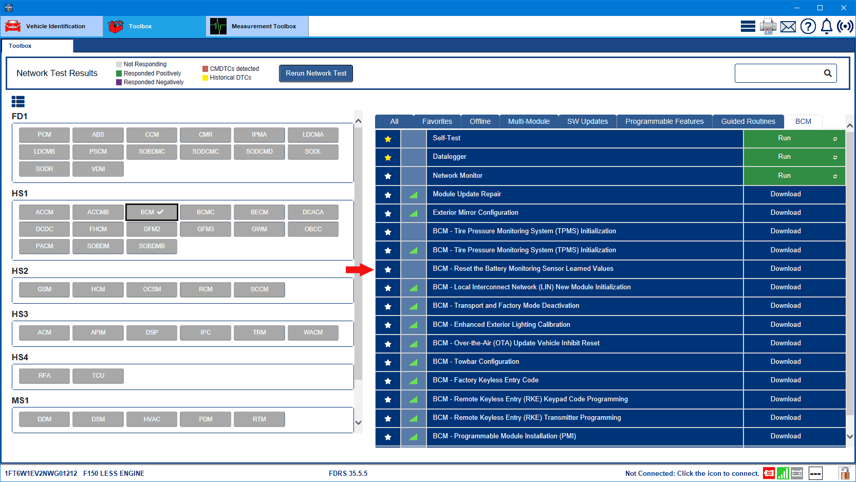

Or just park it and leave it alone for 8 hours after the battery charging or replacement. Or use FDRS or Forcan and reset the BMS.
Laptop not required to do this.
