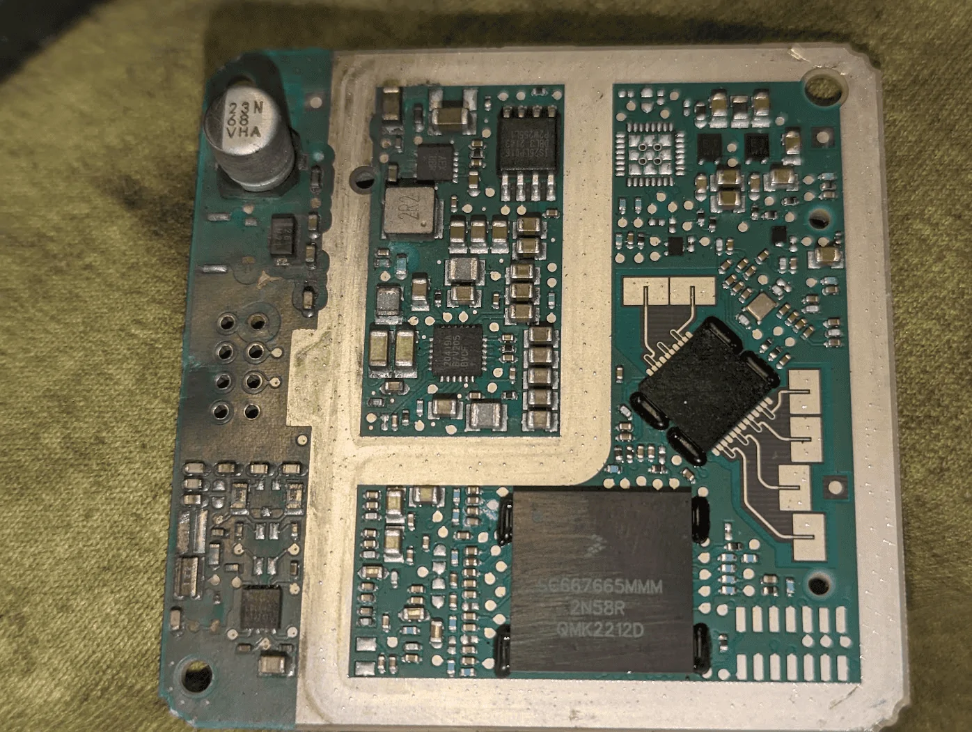

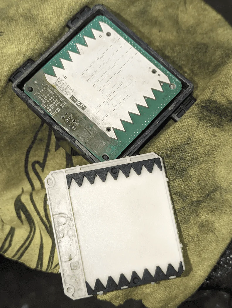

I figured out what's causing my issue with my CCM. I removed the CCM from the bracket and instantly knew what the issue was it's full of water 💦. I shook out the water and hit it with some QD contact cleaner. While looking at the part I noticed 3 small holes inside the connector port you would think that part would be sealed/waterproof seeing how it's inside the bumper. The process continues
It appears that this is common practice on these little electronic modules to vent them to the connector. The automotive connectors that mate with these modules can have a silicone gasket or NOT. For instance inside the tail lights the blind spot radar is designed the exact same way and the connector that runs internally from the main tail light plug to the blind spot radar does NOT have gaskets. Meaning: if your tail light gets cracked, and lets in water, your blind spot radar will take in water and be damaged. This happened to me. I could physically hear water sloshing inside my blind spot radar module, so I broke it open to investigate and the design is exactly as you mentioned. The module itself is very well sealed, but there exists little vent holes inside the connector socket.

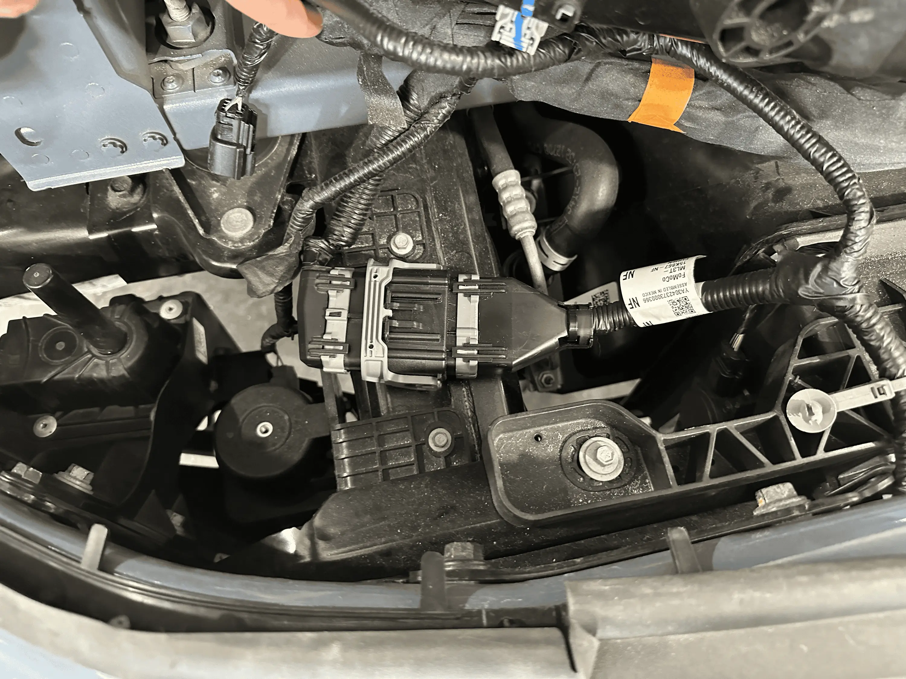

I currently have the radar sensor installed, but I just want to second set of eyes on the truck before I button it up. am I correct in assuming that I will not need to run the 4 extra wires from the front bumper to the passenger footwell? from what I can tell, all wires are present.
Yep,, so you had the wires already? Luuuuuucky
