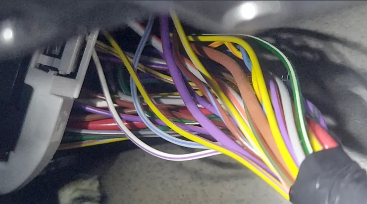

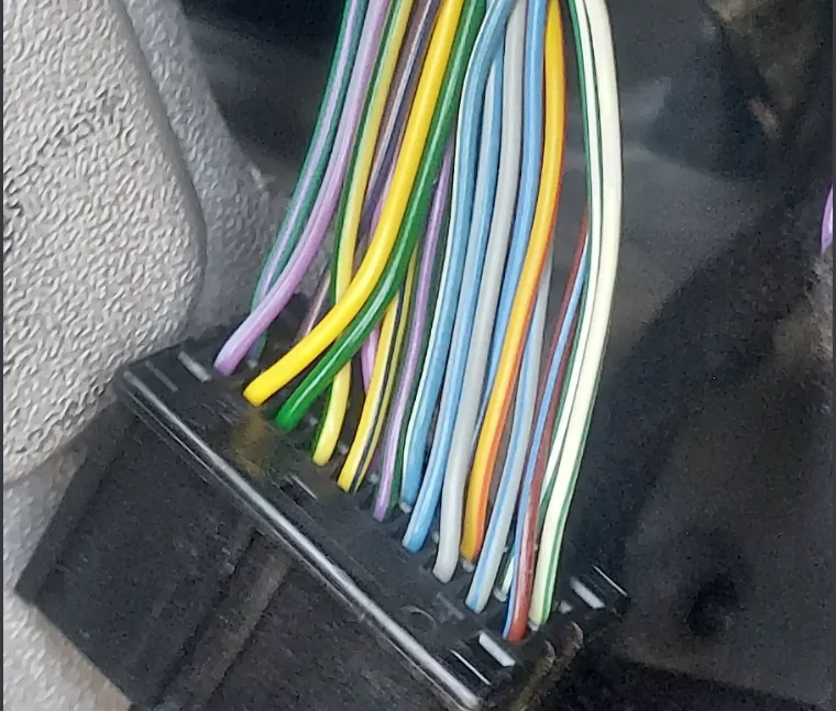

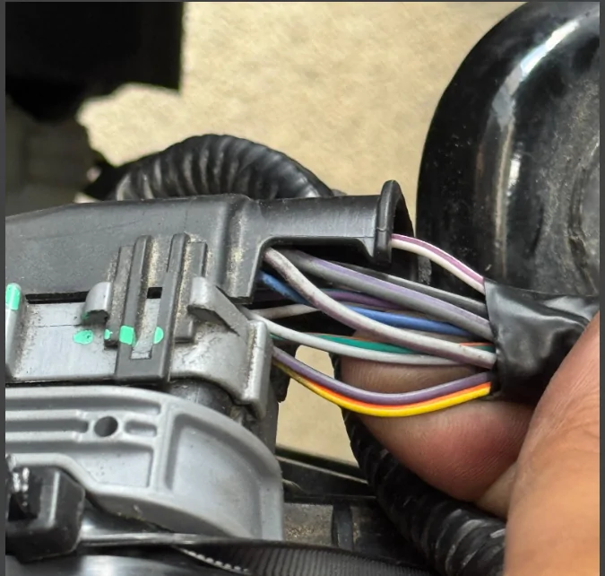

I did verify wiring from both Driver and Passenger side before taking this one. Here are the pics..
Driver Side -
Ford F-150 Lightning DIY: Installing ACC (Adaptive Cruise Control) and LKA (Lane Keep Alert) to 2022 F-150 Lightning XLT 1759767423165-j4
Passenger Side -
Ford F-150 Lightning DIY: Installing ACC (Adaptive Cruise Control) and LKA (Lane Keep Alert) to 2022 F-150 Lightning XLT 1759767348693-vm
U can see Green/White, Brown/Blue, Gray, Gray/Blue wire in the pics above.
Front Bumper to Car connector -
Ford F-150 Lightning DIY: Installing ACC (Adaptive Cruise Control) and LKA (Lane Keep Alert) to 2022 F-150 Lightning XLT 1759767283391-r1
From the PDF is seems we had to validate Driver and Passenger side wiring. I was not sure if we have to validate from Bumper to Car also.
Am i missing something here ? I do see the required wire in Driver and Passenger side but not on the front bumper to car wire harness.

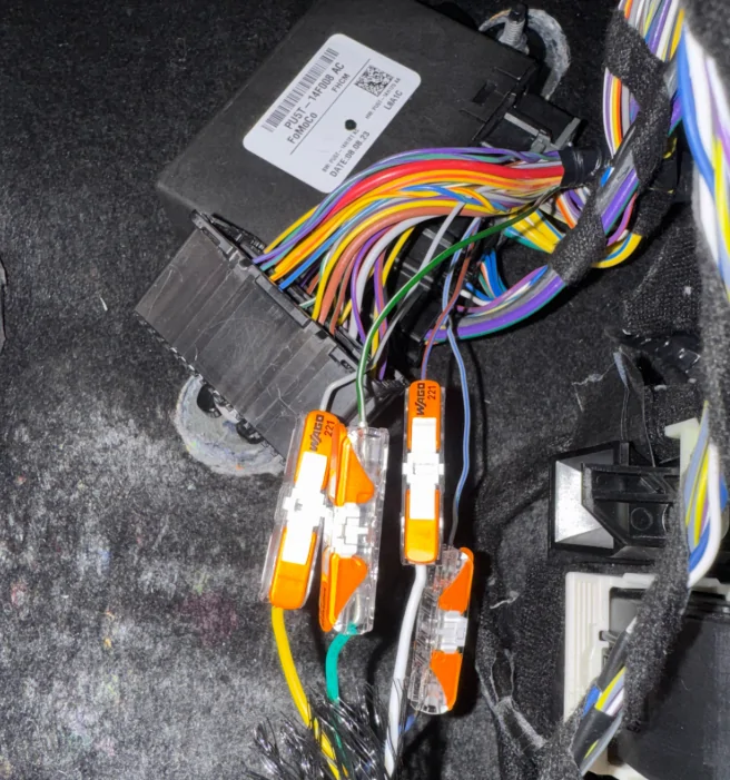

Come on Naveen, wiring is just software logic in the physical world :) You got this.
Your exact situation is now identical to how mine was. You have installed the front bumper harness and CCM, verified the wiring exists from the IMPA to C265, now your only missing the segment from C265 to the front bumper main connector (C134). So, now what you need to do is order the wire and connectors.
You can see my post from "Apr 1, 2023" on page 5 which has the wire and contacts to order:
https://www.f150lightningforum.com/...lert-to-2022-f-150-lightning-xlt.14870/page-5
ON page 6 see my post from "Apr 8, 2023" it has the wiring diagram and pictures of how I routed the wire through the firewall and how I connected it with WAGO splices at C265 in the passenger kick panel.

I saw your wonderful video about how to do modification for C134 .. Man its bloody good! Appreciate you putting time on this one.
Do we have anything similar for C265 work? It's kind of hard to reach under Passenger panel and wondering what's the best way to tackle that.

No, C265 is a bitch. It's not in a water hazard location so just make your own splice there.
I wouldn't even try to extract the pins out of the IMPA side, just identify the wires and snip them.
