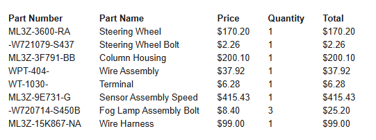

I'm not sure on the cruise switch, as I swiched out the entire steering wheel so I could have a heated one, but the fog lamp assembly bolt is the same, the wire parking distance aid is the same, and the distance sensor is the same as my Pro. I would assume they don't know what they're talking about, or these are updated versions maybe.
Ford F-150 Lightning DIY: Installing ACC (Adaptive Cruise Control) and LKA (Lane Keep Alert) to 2022 F-150 Lightning XLT 1758306722027-ym

I ordered everything from the first post from the same place listed in this post. They might be telling you that it doesn't fit because it's not supposed to be on an XLT if those are the same part numbers that you ordered.
https://www.f150lightningforum.com/...keep-alert-to-2022-f-150-lightning-xlt.14870/
Sensor Assembly: ML3Z-9E731-G
Mounting Bolts(3x): W720714S450B
Wiring Harness: ML3Z-15K867-NA (don't order)
Steering wheel buttons: ML3Z-9C888-D
You might want to look at the other wiring harness that somebody listed if it worked for them because I had to do some splicing on that one I wouldn't order that one again if I had to re-do it
